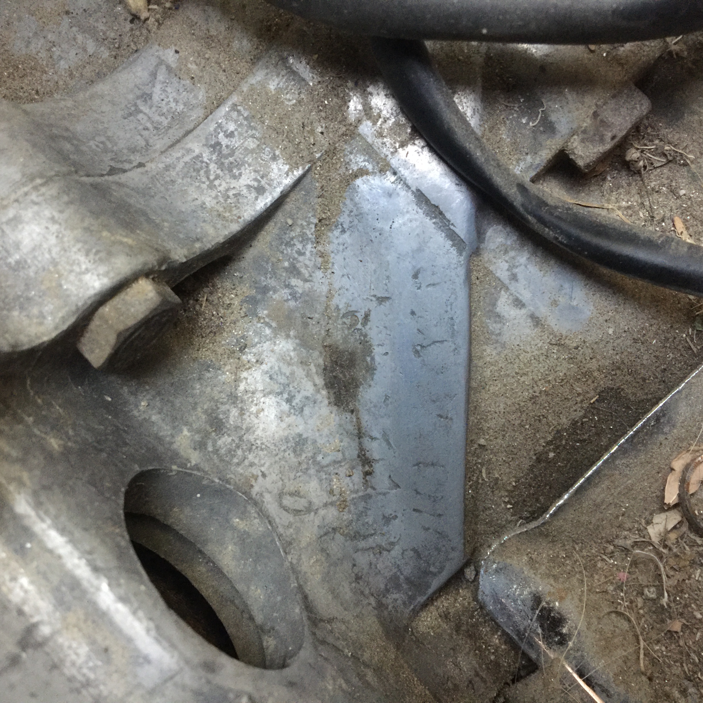

Did you check up at front of engine by the oil fill tower?
davep
There are three locations for the engine serial #. The early version for the 1.7 & 1.8 is on that angled boss near the flywheel end of the case. The 2.0 engines have it up front of the oil fill tower. The 912E 2.0 had it on the fan shroud instead so if that was changed it may appear to be missing entirely. A factory replacement engine or a remanufactured engine from dealer network (engines were remanufactured by VW Canada in Toronto) would all have serial numbers but generally marked AT. A rebuilt engine on a new case would have no serial #. The original serial # can be determined, so if needed, then contact me by email.
dr914@autoatlanta.com
did you look down in the canyon between the oil filler and the front impeller housing?

Junioren
A sticker on the engine provides the engine family identification as "17". Does anyone have any idea whether this would be a CA or a USA-49 engine edition?
Junioren
That is indeed where I checked and was expecting it, but no.

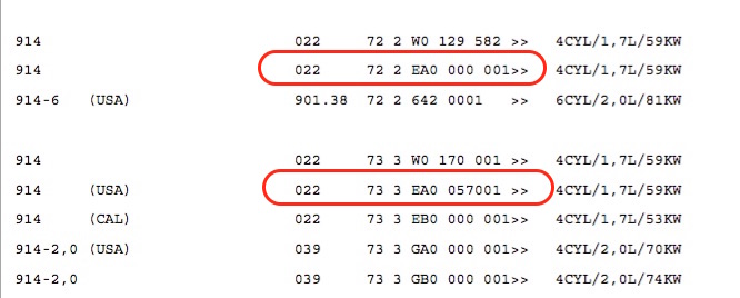

the engine number is not outside the known engine range for EA engines.
the EA 1.7 was also used in USA 411 and 412 models.
the engine numbers are not sequential for 914s but are intermixed with 411/412 models.
same thing goes for the EB (73 california) 1.7 and later EC (1.8 engines) also shared with the VW 412 (at least for 74). only time the small engine becomes a 914 only engine is the 1.8 of 75.
i'd say the original case was destroyed (engine damage or wear) and has been replace with a 1.7 case or perhaps even 1.7 short motor? the fan casting is from the original 2.0 L engine complete with correct emission sticker for a later 2.0?
PS don't be confused by the extra 0 in the engine numbers in the VW/Porsche parts catalogue listing. the same thing goes for the EC engines. for some reason they have a zero (or is it an O?) after EA/EB/EC in the parts engine number listing. but its not there on the actual stamp number on any engines.

davep
EA013495 should be an October 1971 engine, but that fan shroud was not on an engine through the 1974 model year. This leads me to believe the engine was pieced together.

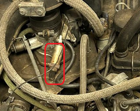

rjames
What's with the plugged adapter? Looks like it's coming off of the advance port on the TB... but I thought that the later throttle body's didn't have an advance port. My '75 2.0 didn't.
emerygt350
We need to see the ports on the plenum. Looks like a real mix of pieces. TB from a 73 or really early 74 2.0. The ports on plenum will tell us if that is 73 as well. That thing you circled looks like an O2 sensor!

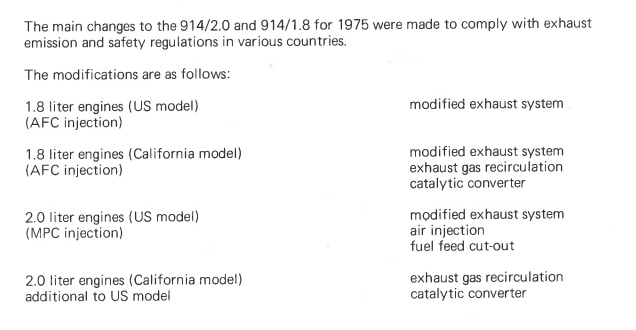

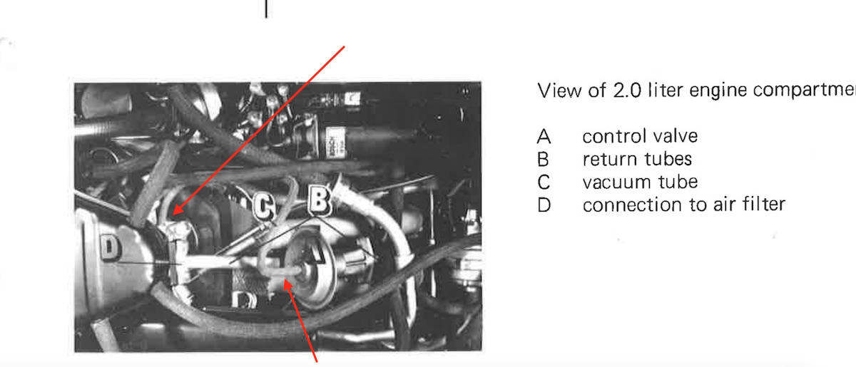

wonkipop
QUOTE(rjames @ Jan 11 2024, 03:38 PM) *
well spotted.
i don't know too much about the 2.0 L cars.
but there was a difference between the calif spec and 49 states.
calif had EGR but 49 states did not.
and calif def had EGR vacuum initiated off "advance" port on TB.
from what i have seen it was the 49 state 75 2.0L that did not have an "advance" port on TB.
neither version used timing advance from advance can on distributor.
only retard side. ( but @JeffBowlsby will correct me if i am wrong).
i am more familiar with the 1.8s.
contrary to myth the 1.8s did not divide purely on model years when it came to the set up for advance and retard of timing and whether or not the TB had both an advance and retard port.
the 74 49 state 1.8 had advance and retard ports on TB and used both coupled up to the advance and retard sides of the can on the distributor.
the 74 calif 1.8 only had a retard port on TB and only hooked up the retard can on dist.
the 75 49 state 1.8 was as per 74 californian.
75 californian used the 74 49 states TB with both ports but hooked up the advance port on the TB to the EGR.
from what i can glean about 75 2.0s its a similar scenario.
advance port on TB hooks up to EGR on californian.
no advance port on TB for 49 state cars which don't have EGR.
not sure if californian 75 2.0 had the air pump and air injection either.
instead had cat and EGR. but not 100% sure. tech book that jeff bowlsy has on his website which i have looked at for the 1.8s has the 2.0 info in it.
seems to say they did with EGR and cat additional.
cars that exist today of course have mostly got all this stuff missing.
its got the correct air cleaner for a 75.
has the connection plate for EGR.
which is blanked off in this case. as it should be for a 75 49 states.
and in other photos you can see it has the smog pump pulley on the fan.
seems to be in accord with the emissions sticker on fan casting and stencil stamp on tin saying its a 75 49 state.
but you and emory are right about the throttle body.
from what i can tell it should not have an advance port opened up.
either a 73/74 T/B or a 75 calif T/B?
