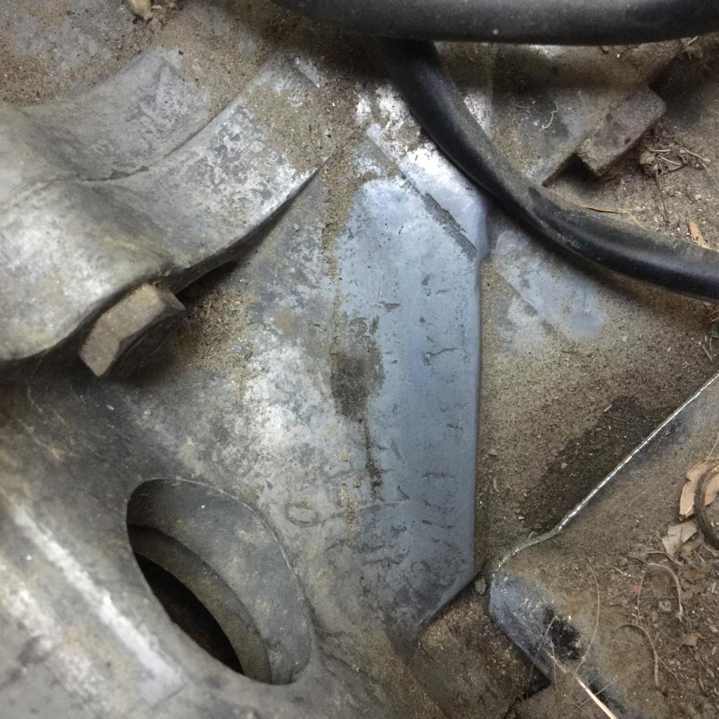

Did you check up at front of engine by the oil fill tower?

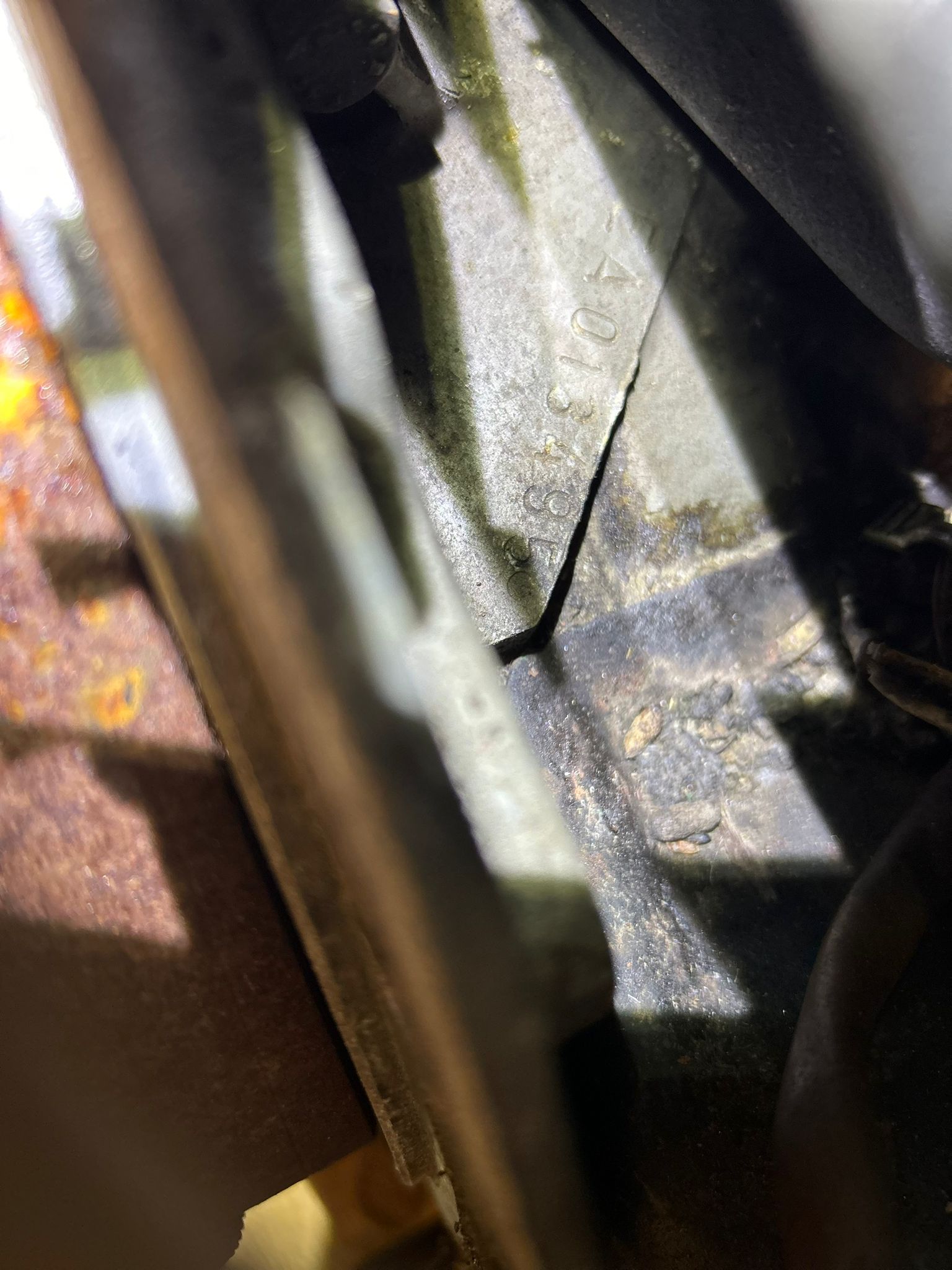

There are three locations for the engine serial #. The early version for the 1.7 & 1.8 is on that angled boss near the flywheel end of the case. The 2.0 engines have it up front of the oil fill tower. The 912E 2.0 had it on the fan shroud instead so if that was changed it may appear to be missing entirely. A factory replacement engine or a remanufactured engine from dealer network (engines were remanufactured by VW Canada in Toronto) would all have serial numbers but generally marked AT. A rebuilt engine on a new case would have no serial #. The original serial # can be determined, so if needed, then contact me by email.

did you look down in the canyon between the oil filler and the front impeller housing?

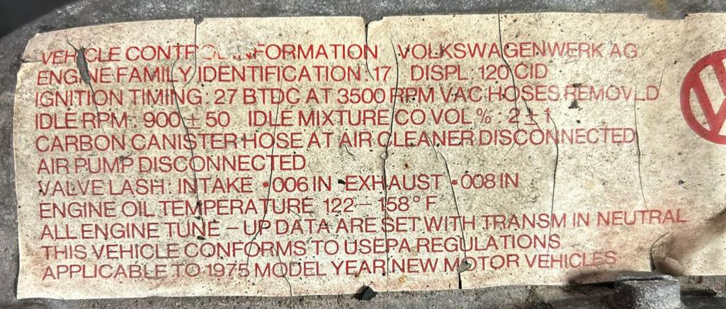

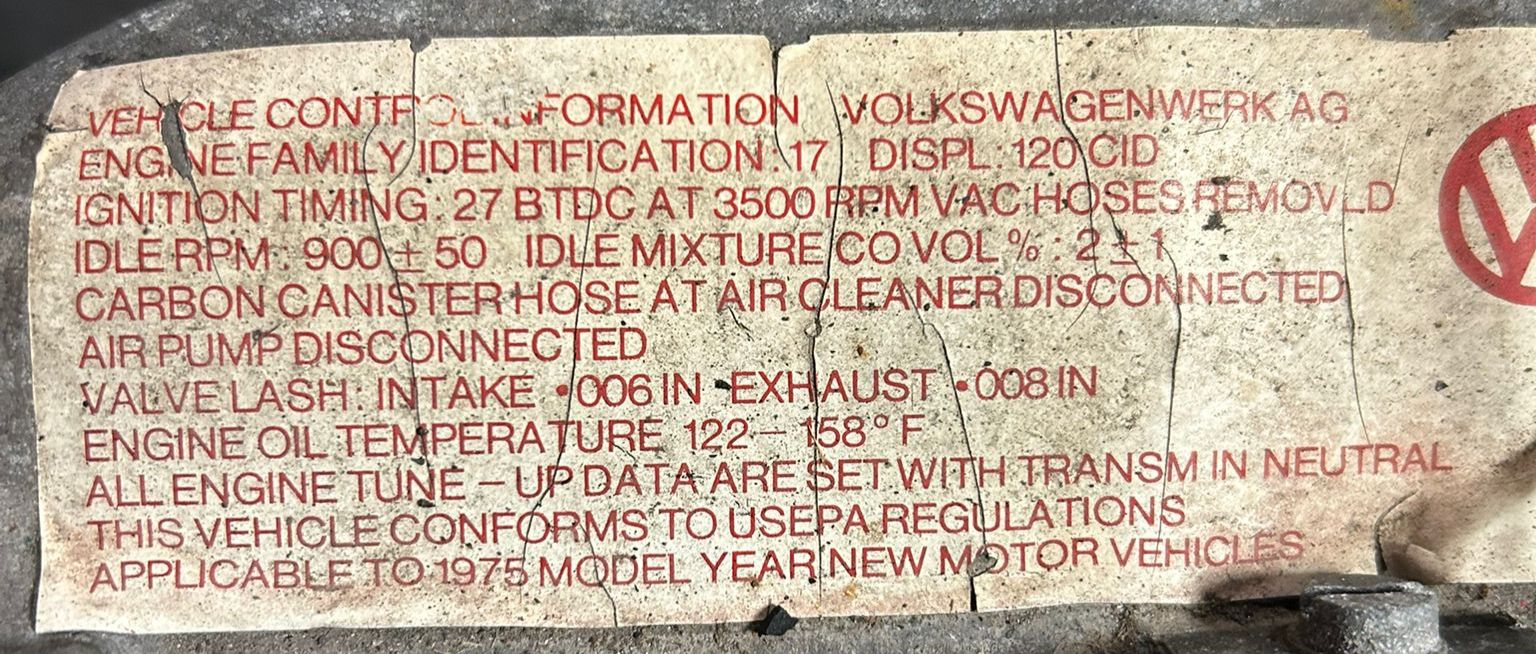

A sticker on the engine provides the engine family identification as "17". Does anyone have any idea whether this would be a CA or a USA-49 engine edition?

That is indeed where I checked and was expecting it, but no.

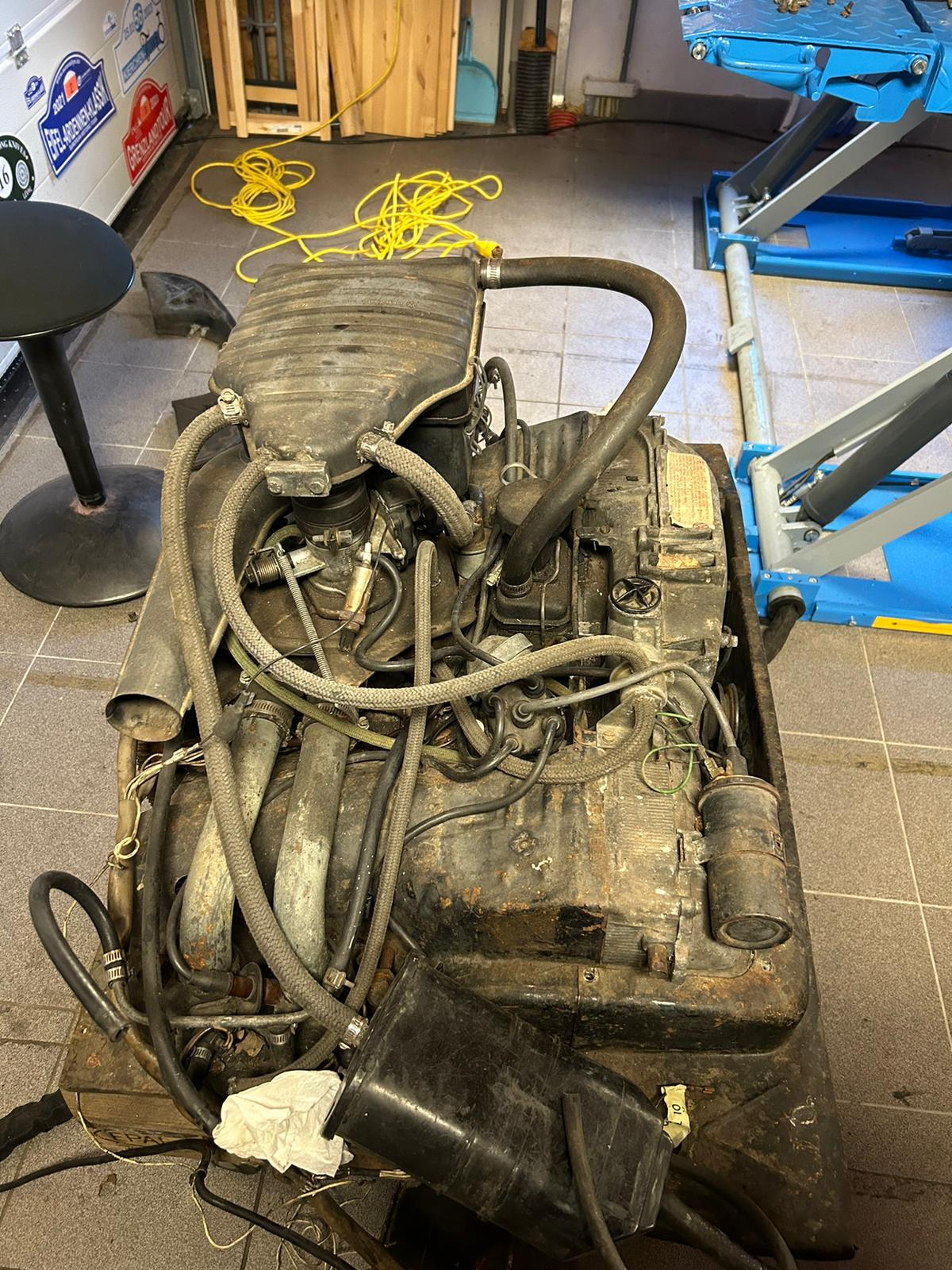

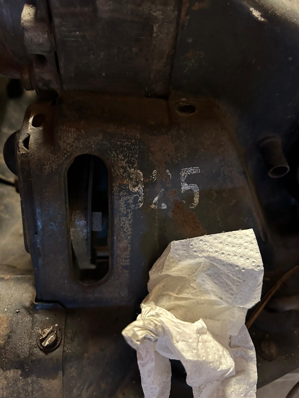

Hello guys,
I just dump the information I have but the mystery gets bigger for me:
Engine family: 17 (I thought this was only for 1976 2.0 engines) - displacement 120 CID so I believe it is a 2.0 l

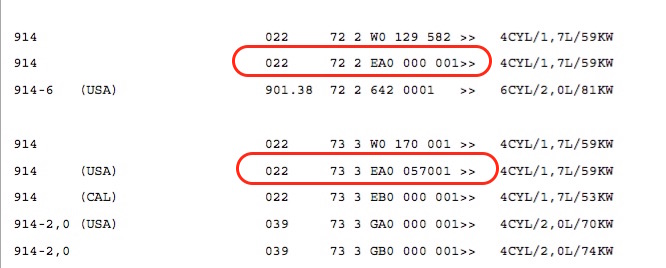

Engine number (embossed in the space where the earlier engines had their number): EA013495 (so outside the known number range for the 1.7 engines)
Any plausible thoughts on what could have happened

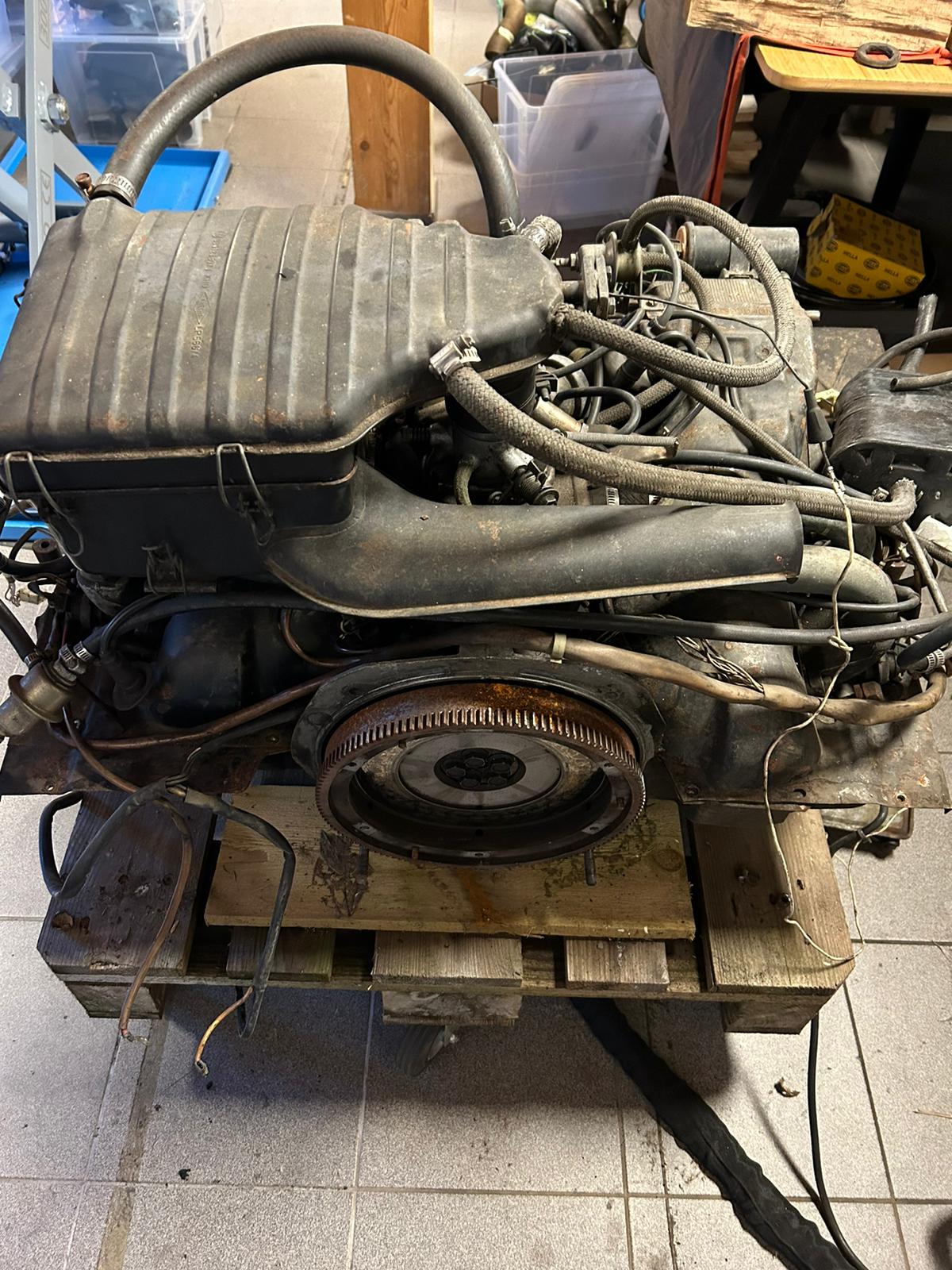

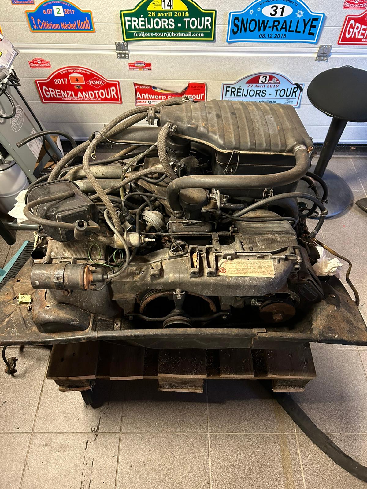

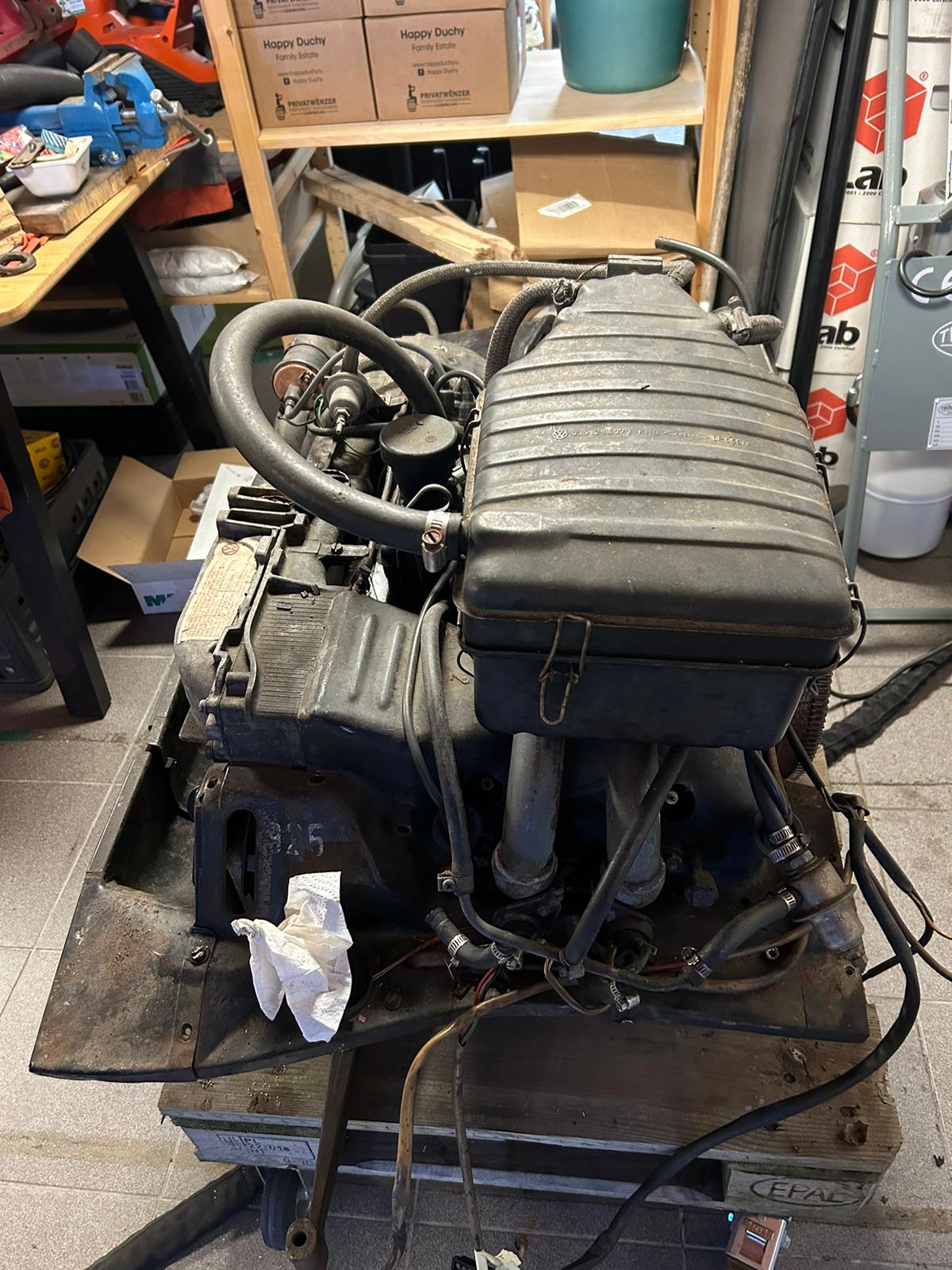

I thought all EA code engines were 1.7? Can you post pictures of the top of the engine? The number of studs on the intake as well as the position of the spark plugs is different on the 2.0 heads. Could also be your engine is a "hybrid" of parts. A 1.7 case can be used to build a 2.0 engine. Curious to see what the final answer is....

the engine number is not outside the known engine range for EA engines.
the EA 1.7 was also used in USA 411 and 412 models.
the engine numbers are not sequential for 914s but are intermixed with 411/412 models.
same thing goes for the EB (73 california) 1.7 and later EC (1.8 engines) also shared with the VW 412 (at least for 74). only time the small engine becomes a 914 only engine is the 1.8 of 75.
i'd say the original case was destroyed (engine damage or wear) and has been replace with a 1.7 case or perhaps even 1.7 short motor? the fan casting is from the original 2.0 L engine complete with correct emission sticker for a later 2.0?
PS don't be confused by the extra 0 in the engine numbers in the VW/Porsche parts catalogue listing. the same thing goes for the EC engines. for some reason they have a zero (or is it an O?) after EA/EB/EC in the parts engine number listing. but its not there on the actual stamp number on any engines.

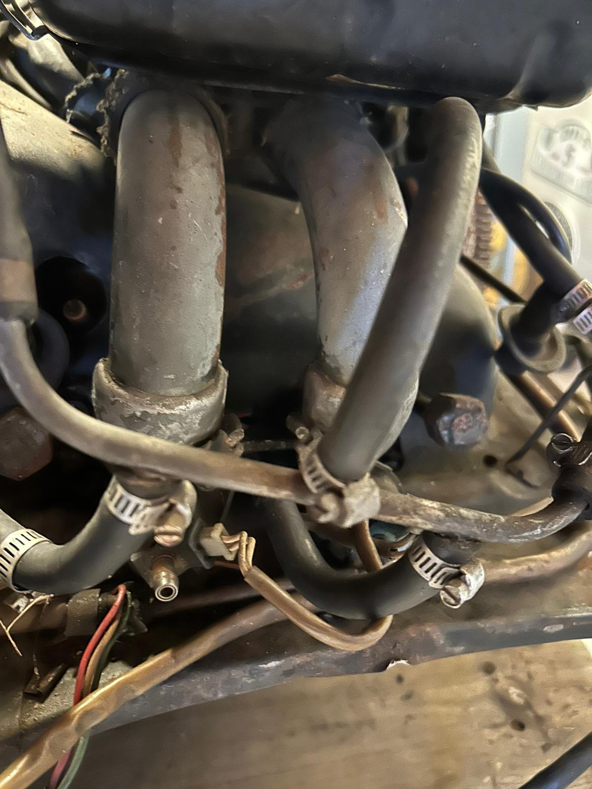

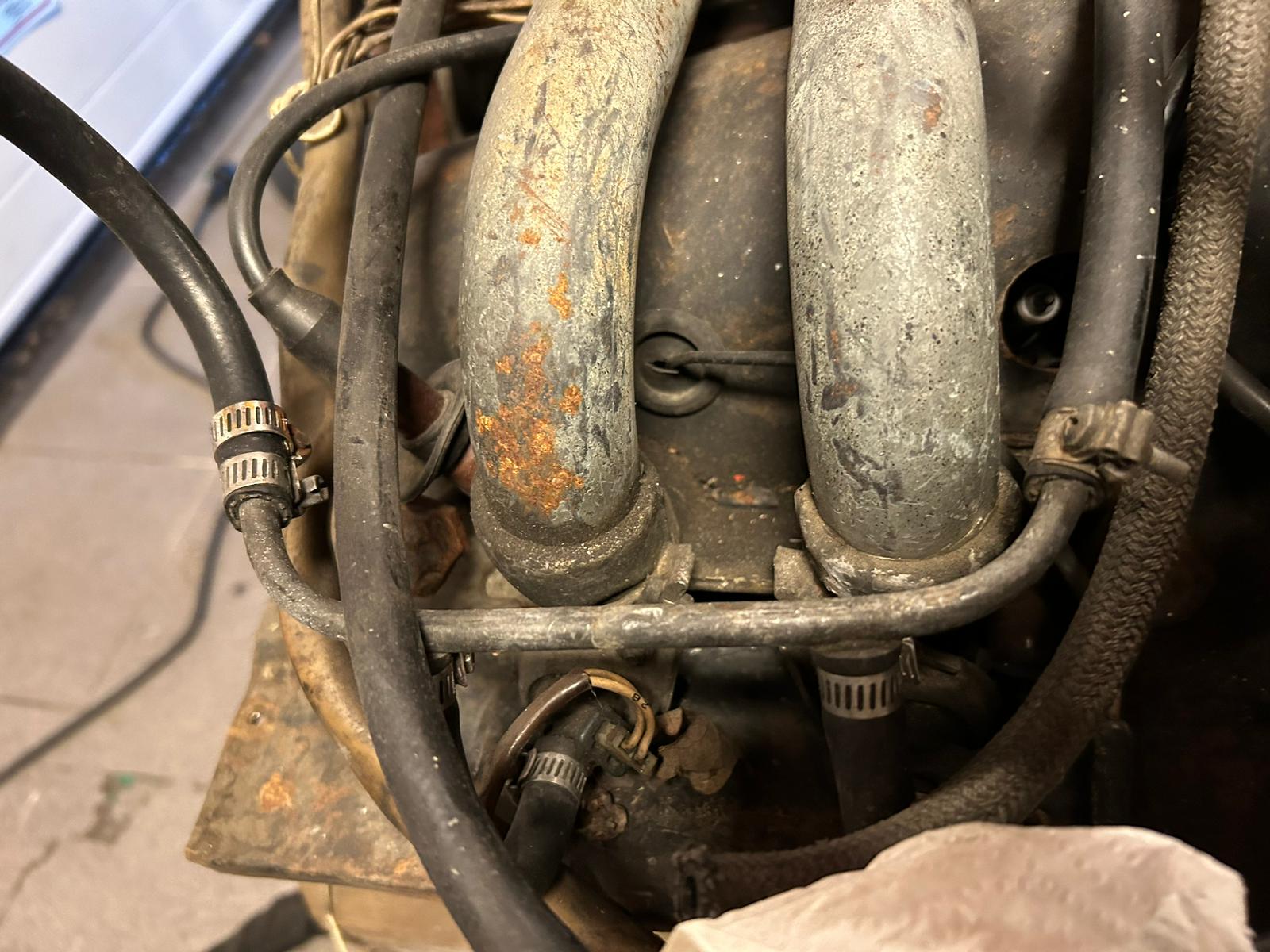

Show us the heads! A 1.7 block is fine if they put all the 2.0 meat on it.

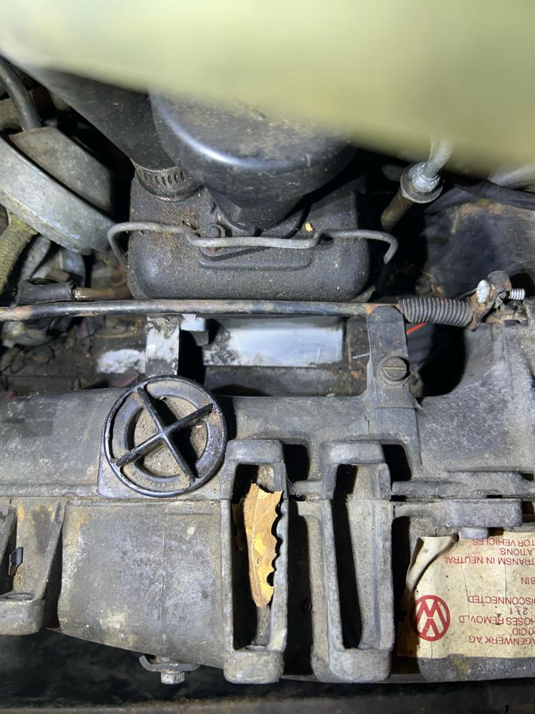

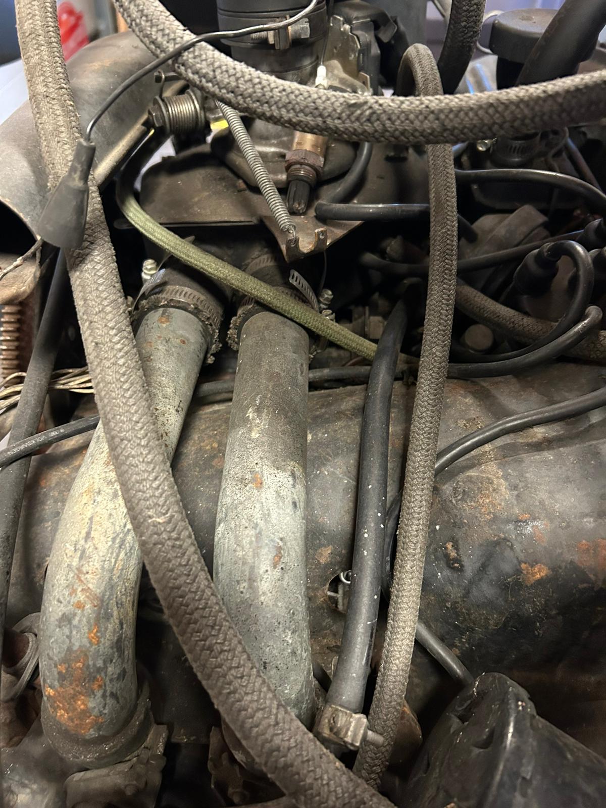

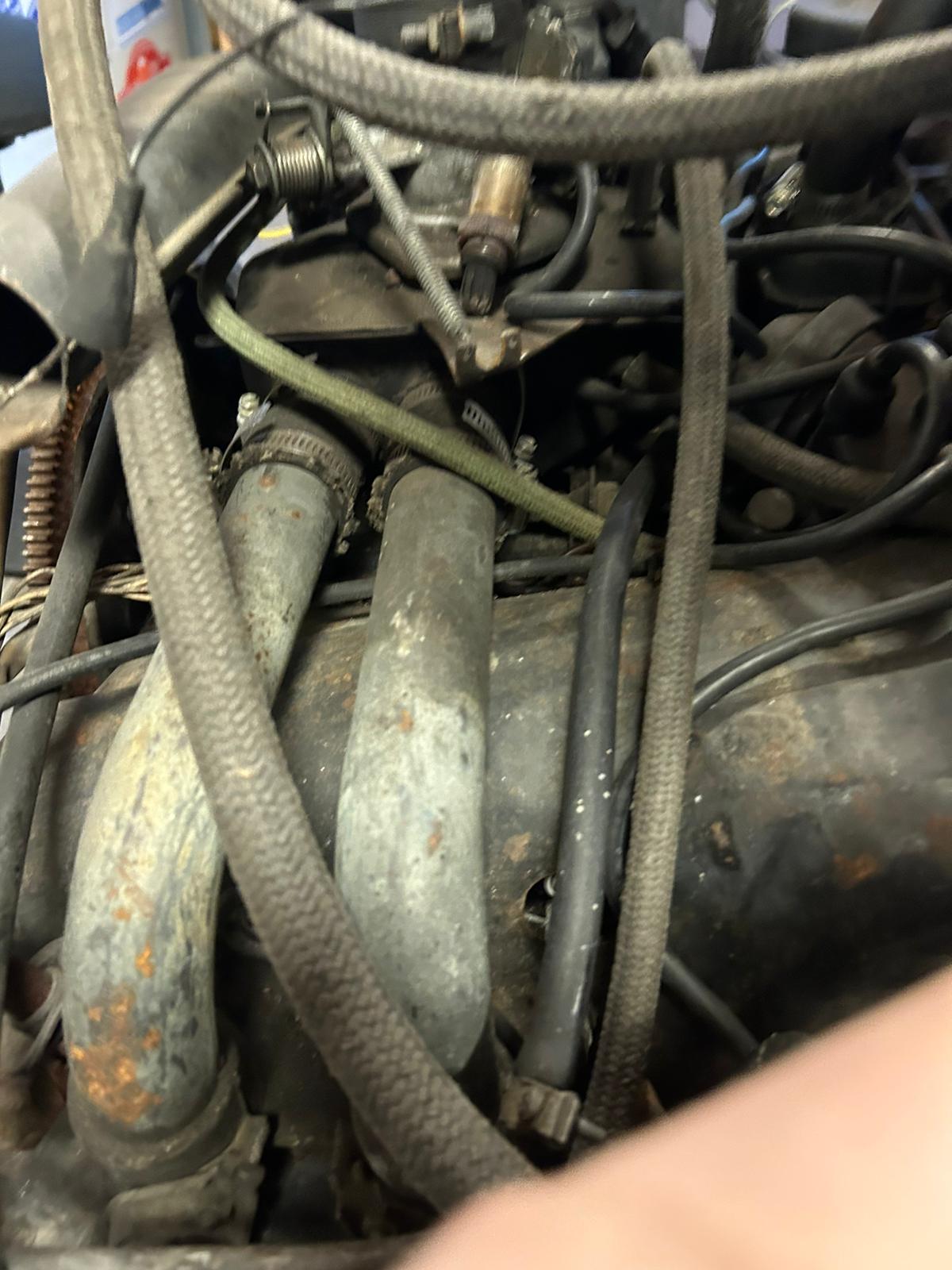

Missing a couple important details to know what you have and what you should have.
Post photos of the intake manifold to head connection and general engine overall from both sides of the engine bay.
Post a photo of the label on the drivers side engine bay above the relay board.

QUOTE(Junioren @ Jan 9 2024, 03:32 PM) *
engine family 17 is the 75 MY terminology for the GC-a series 2.0 L engine for 49 states of USA. 18 is the GC-b california engine of 75. the internals of the engine were the same USA and california. it was the equipment fitted to the engine that was different.
someone like @jeffBowlsby knows all that stuff. 2.0L are above my paygrade. (IMG:style_emoticons/default/biggrin.gif)
i do lame engine 1.8s. (IMG:style_emoticons/default/smile.gif) (IMG:style_emoticons/default/biggrin.gif) (IMG:style_emoticons/default/beerchug.gif)
another clue as to exactly what bits and pieces you might have.
if the tinware is the original 2.0 L tin and it has not been repainted there might be a white paint stencil three digit code number on it. if the tin is from a 75 49 sttates 2.0 L the number 925 will be there. on upper surface of tinware on either right or left hand side up close to where the tin joins the fan casting. usually its hidden from direct view by one or other of the heater blower motor hoses.
PS - the other clue its not a californian 75 2.0 besides being engine family 17 is the emissions sticker notes its "USEPA" conforming. if it was a californian spec engine the sticker would say "USEPA and Cailfornia regulations".
or in this case the fan casting is USEPA conforming. (IMG:style_emoticons/default/biggrin.gif) (IMG:style_emoticons/default/biggrin.gif) (IMG:style_emoticons/default/beerchug.gif)

EA013495 should be an October 1971 engine, but that fan shroud was not on an engine through the 1974 model year. This leads me to believe the engine was pieced together.
wonkipop
post Jan 10 2024, 01:48 AM
Posts: 5,778
Joined: 6-May 20
From: north antarctica
Member No.: 24,231
QUOTE(davep @ Jan 9 2024, 09:26 PM) *
he has a 75 2.0 @davep
not a 74.
see first post by OP.
i think the fan shroud and sticker is likely off the original car since the emission sticker is for a 75 2.0! and also in the correct spot for a 75. (IMG:style_emoticons/default/biggrin.gif) (IMG:style_emoticons/default/beerchug.gif)
but you are right. she has been pieced together.
somewhere along the way she has let herself implode.
why not. thats what 914s are for.
the cars are half a century old now!!! (IMG:style_emoticons/default/biggrin.gif) (IMG:style_emoticons/default/beerchug.gif)

One thought, it could be a 912E case. They never had an engine number from the factory. The Ljet setup was very similar to that of the 914.
I actually have a 914 engine in my 912E, but has the 912E engine shroud. The 912E engine shroud is what held the engine number for the car.
EDIT: missed davep already went over this.

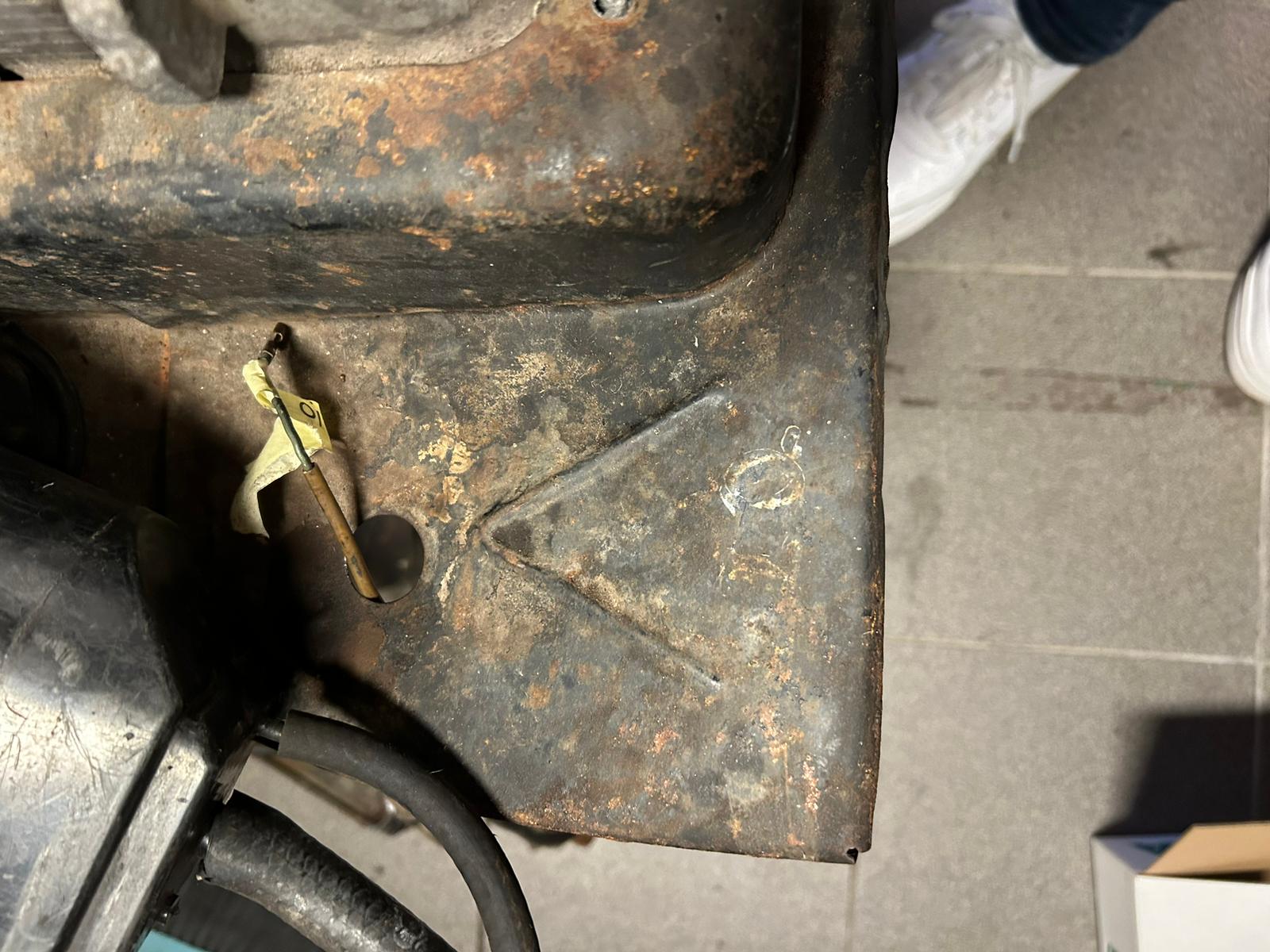

Thanks Jeff for the info. I post some pictures from all sides.
