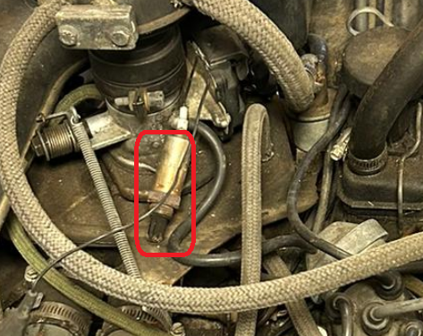

What's with the plugged adapter? Looks like it's coming off of the advance port on the TB... but I thought that the later throttle body's didn't have an advance port. My '75 2.0 didn't.

JeffBowlsby   Those are capped off air injectors, supplied by yo...   Jan 11 2024, 03:21 PM
rjames   What's with the plugged adapter? Looks like it...   Jan 11 2024, 03:38 PM
wonkipop   What's with the plugged adapter? Looks like i...   Jan 11 2024, 06:16 PM
wonkipop   What's with the plugged adapter? Looks like i...   Jan 11 2024, 07:02 PM
emerygt350   We need to see the ports on the plenum. Looks lik...   Jan 11 2024, 04:04 PM
