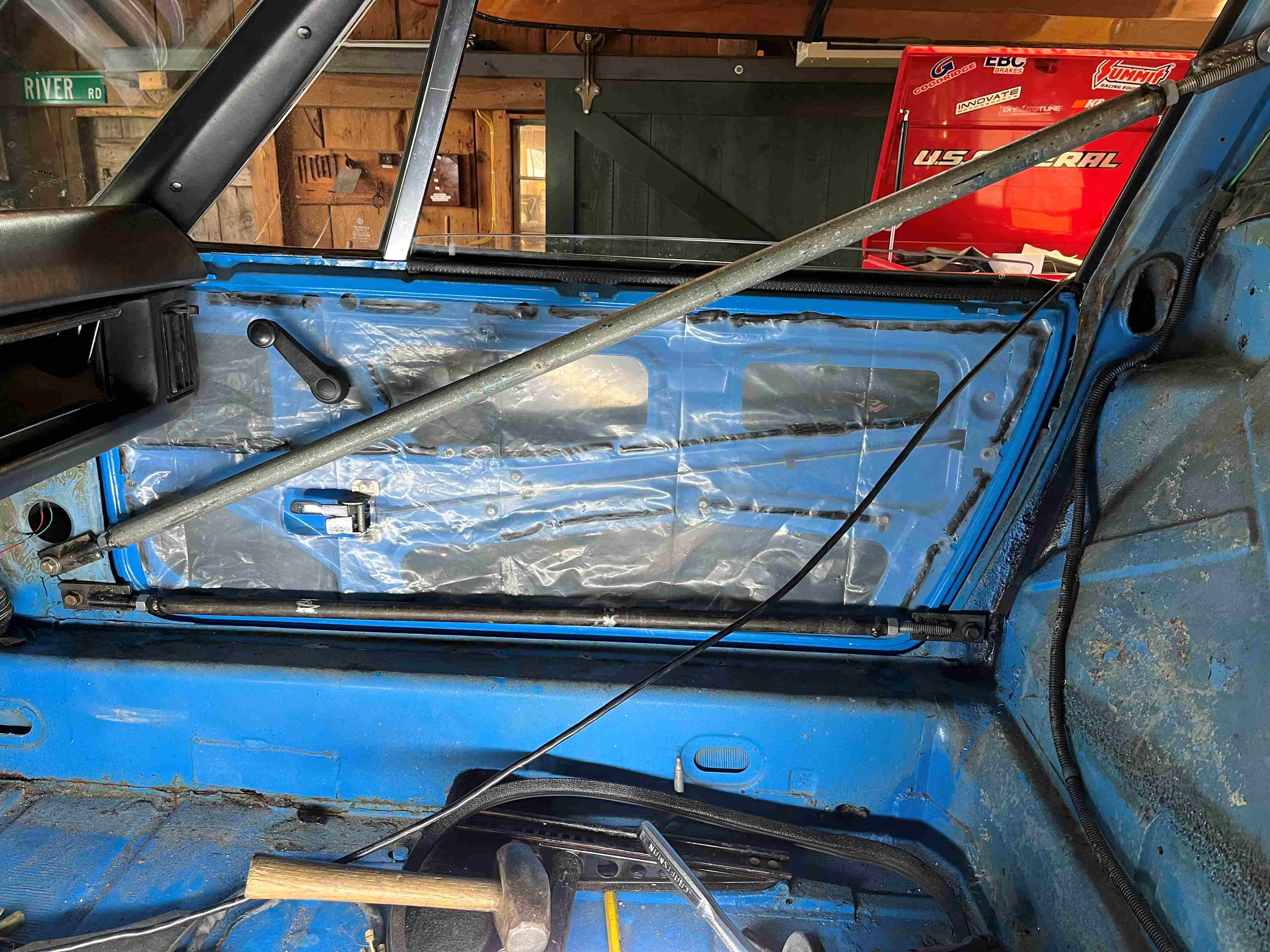

My friend Chris and I finished building and installing the door bracing.

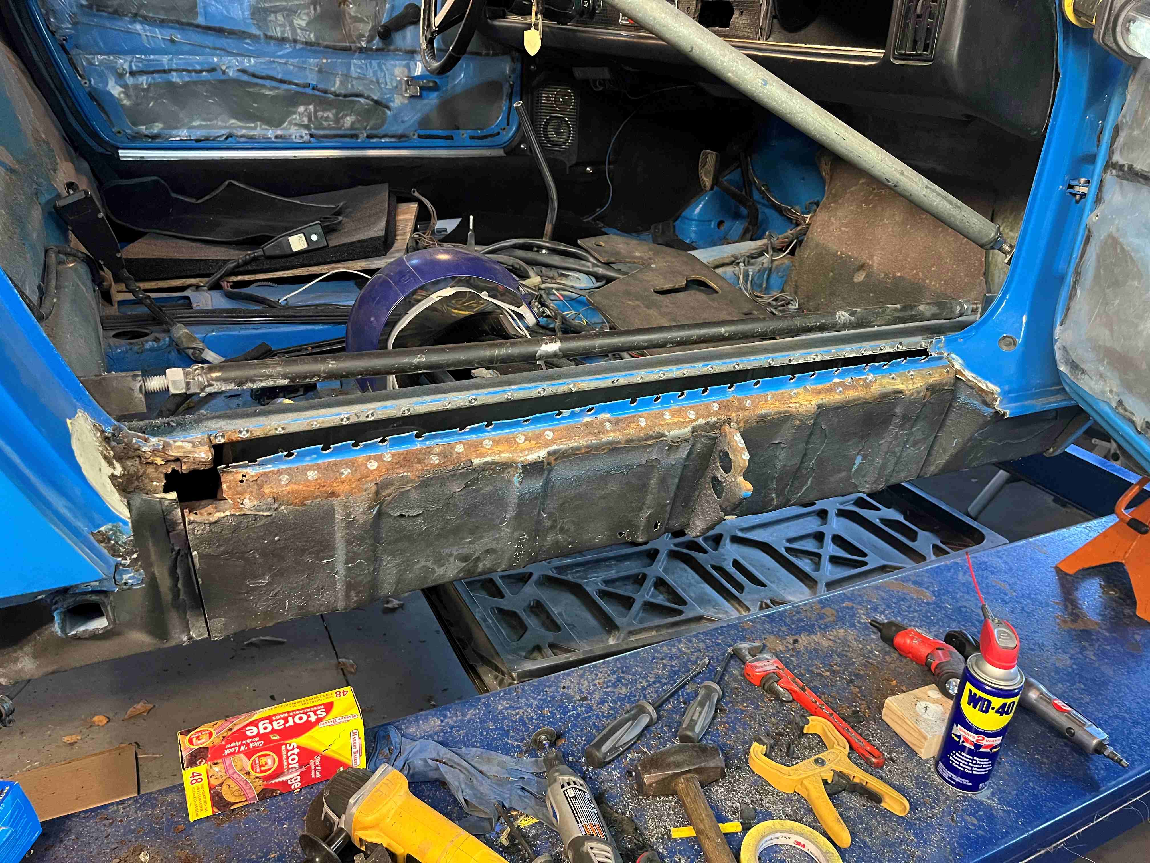

and we drilled out spot welds on the threshold and inner rocker

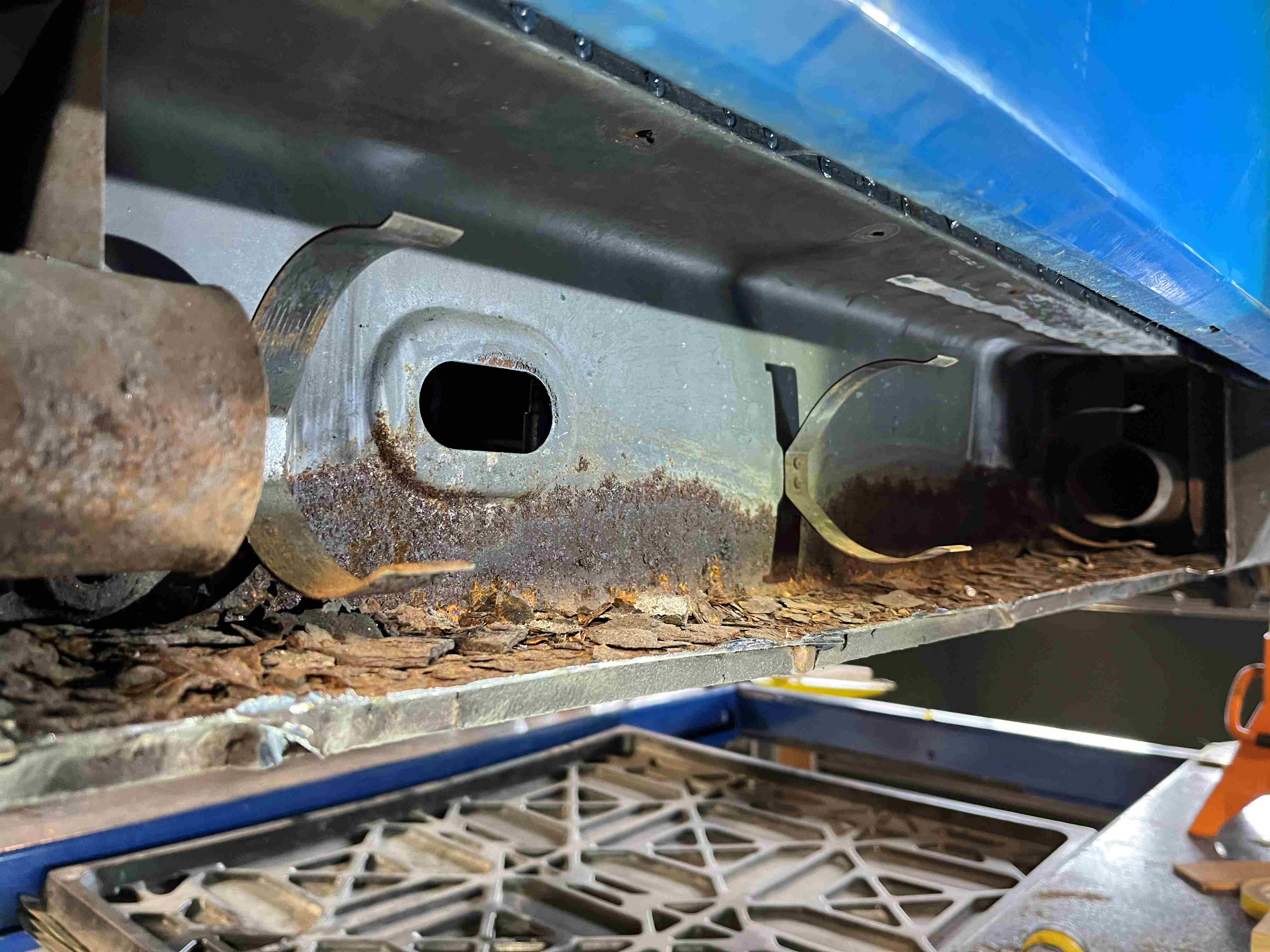

once off, we can see solid metal on a lot of the inner long, but the bottom is rusted out
