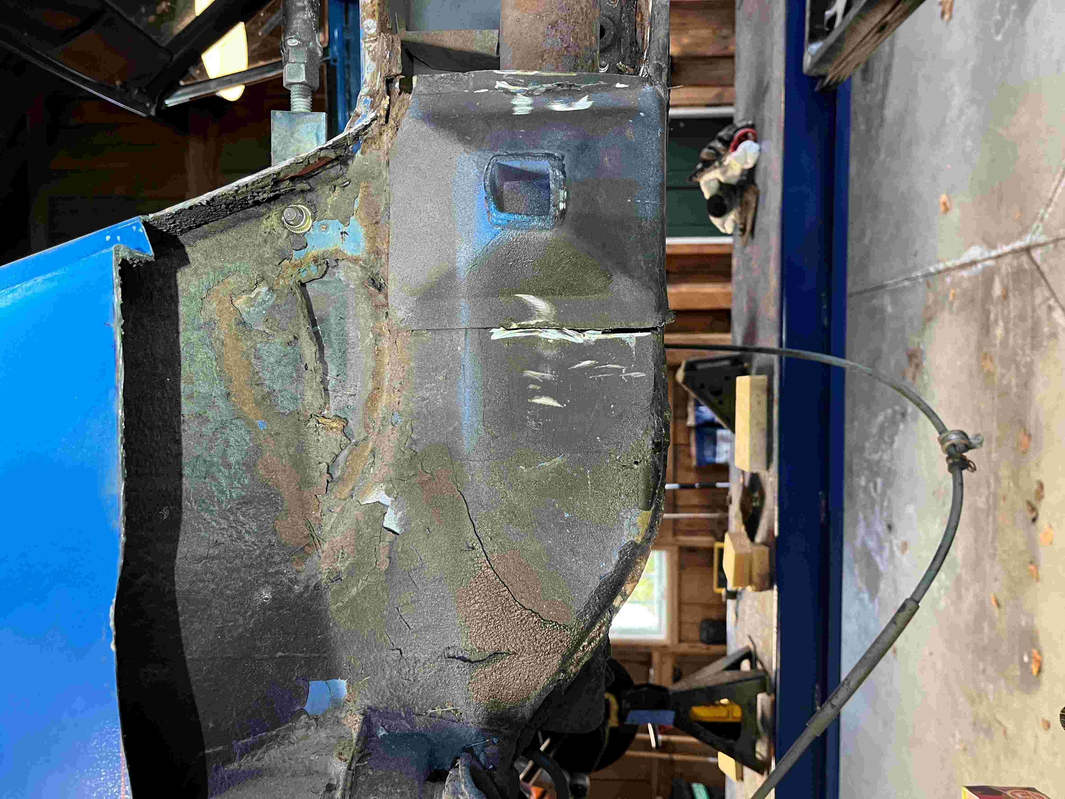

The previous owner told us the hell hole and longs had been done and he seemed like an honest car guy. So that was dumb and naive of me. It was clear that a bunch of work had been done around the hell hole, which looked good from the engine bay. When we got it home and on the lift we were faced with a rusted out lower firewall.
Ordered a firewall repair panel.
We pulled the engine today and cut out the lower firewall and it’s pretty ugly.Attached Image

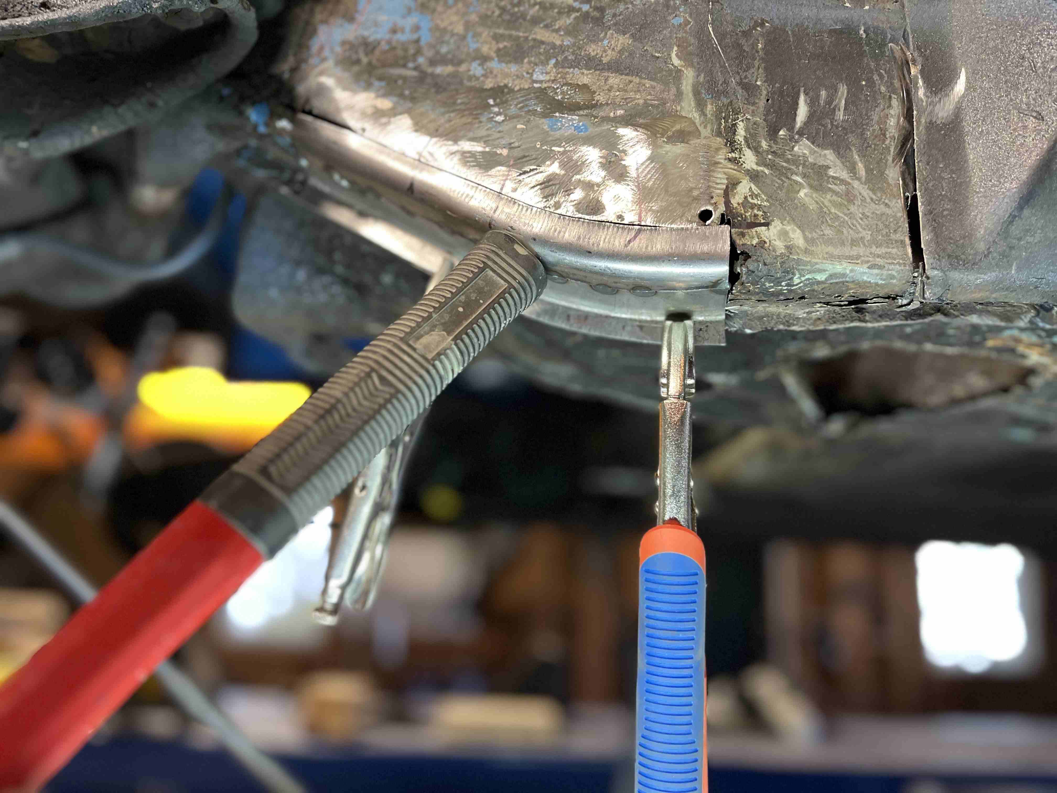

Unfortunately, there's hell hole damage to the top of the long/ rocker behind the fender that we can't access, so out comes the air saw to open the fender. the air saw cuts a really narrow kerf, and cuts fast, but I'm no good at following a straight line.
The aft portion of the long with the bend is rotten at the bottom and there's more damage on the inside we need to get to. Before we destroy the geometry, we fabricated a patch panel by bending, stretching and shrinking metal. My 1st use of the shrinker and stretcher but it's looking pretty decent.
