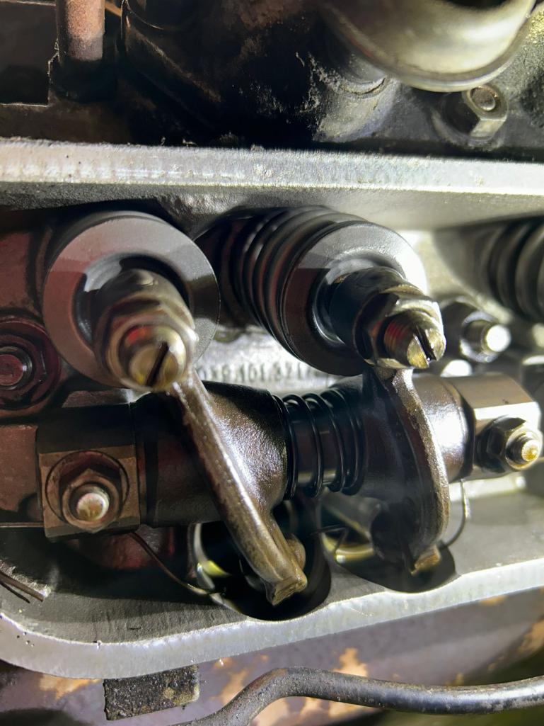

Thanks for all your help on previous questions.
I have opened the valve covers of the cylinder heads to see the ref number on them (still trying to find out if I am now running a 1.7 (as the engine number indicates) or a 2.0 (what I thought it was originally).
The cylinder head ref reads 039 101 371 A (I think a 2.0 cyl head).
Would I need to dig deeper to know whether the engine is in fact a 1.7 turned 2.0 or still a 1.7?
Any suggestions on how I could find the answer to that?
Thanks

QUOTE(Junioren @ Jan 12 2024, 01:20 PM) *
Thanks
The 1.7 and the 2.0 have a different stroke. Maybe you can measure that to get your answer.
