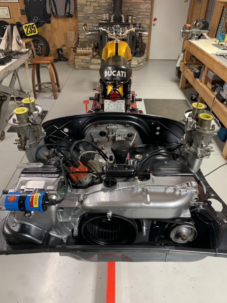

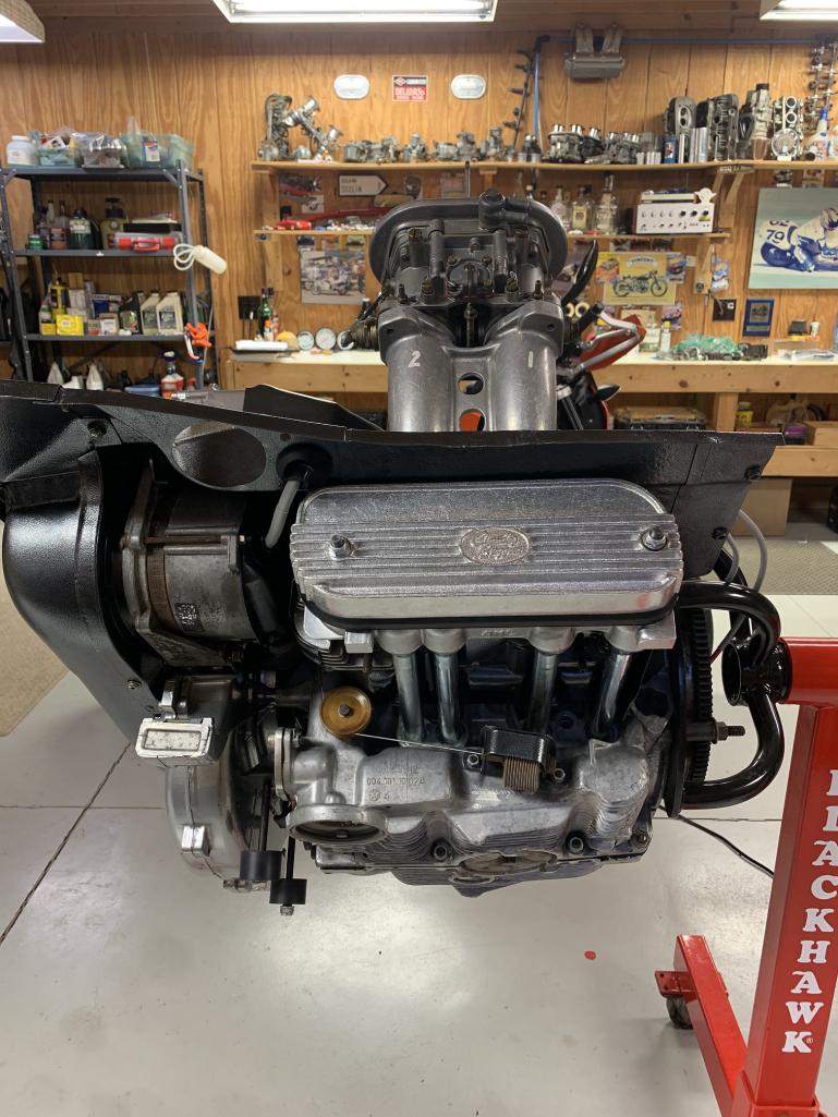

Just about ready to go back into the car. I know that many in the garage deride the bolt on cast CB Perf valve covers, but I am going to try them out. Imagine if I had installed my hexbar linkage (IMG:style_emoticons/default/blink.gif) for the photos! I am hopeful that the "X-ring" pushrod tube seals help. I also replaced gaskets at the oil pump, and still need to replace the RMS. But I am lowering expectations from a "dry Type IV engine" to a "less wet Type IV engine".
I just really dig these little powerplants, and this one has come out great (again).

sdoolin   I finally received the CB Performance bolt on valv...   Jan 2 2024, 01:48 PM

sdoolin   Loosened everything up, removed the heater ducts a...   Mar 29 2024, 07:22 AM
GBX0073   Great Picture Looking good !   Mar 29 2024, 08:30 AM
technicalninja   :agree: :agree: :agree: Nice and clean! M...   Mar 29 2024, 09:36 AM
sdoolin   Thanks for the compliments in the cleanliness. But...   Mar 30 2024, 07:52 AM
