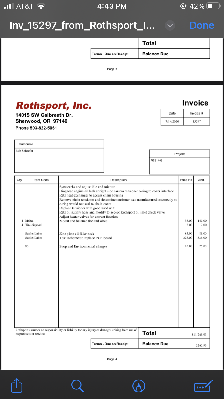

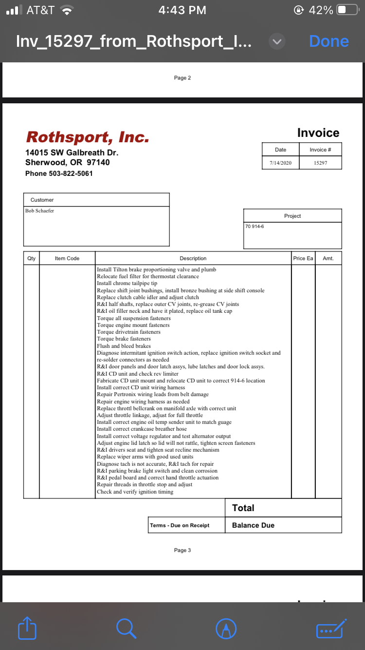

Here’s the resulting invoice I paid for Jeff’s work on the car between 7/1/20 and 10/19/20:
