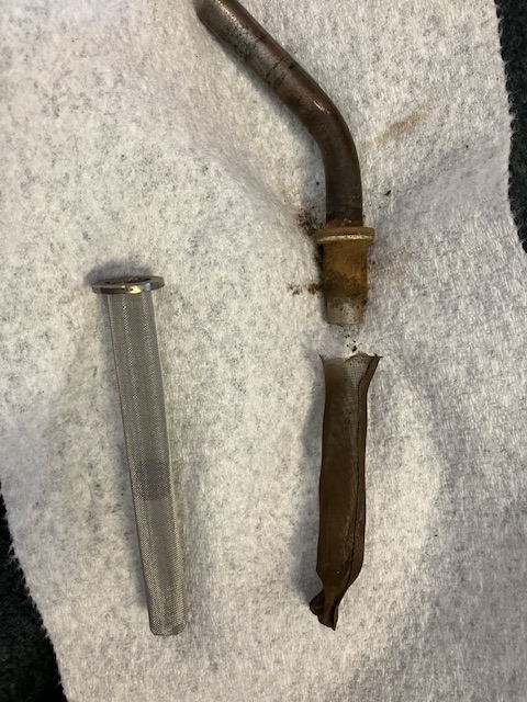

Broken fuel tank screen sock:

Rufus   Broken fuel tank screen sock:   Jan 19 2024, 08:19 PM
