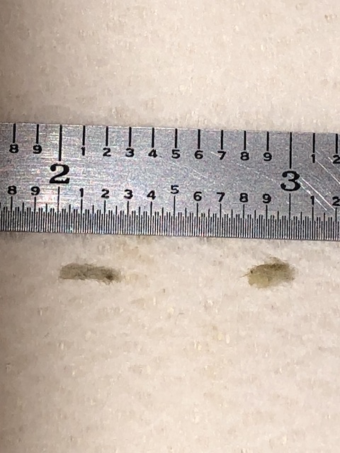

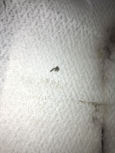

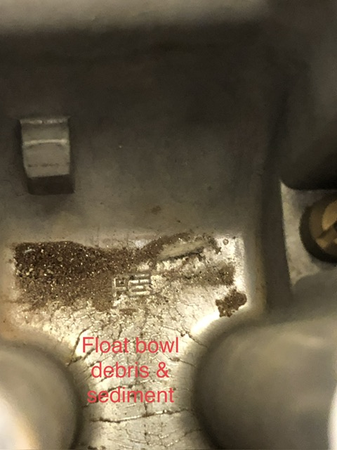

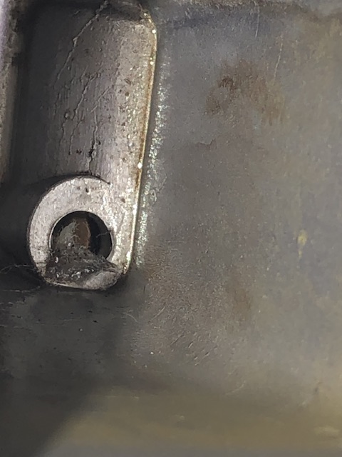

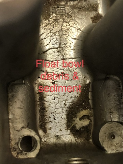

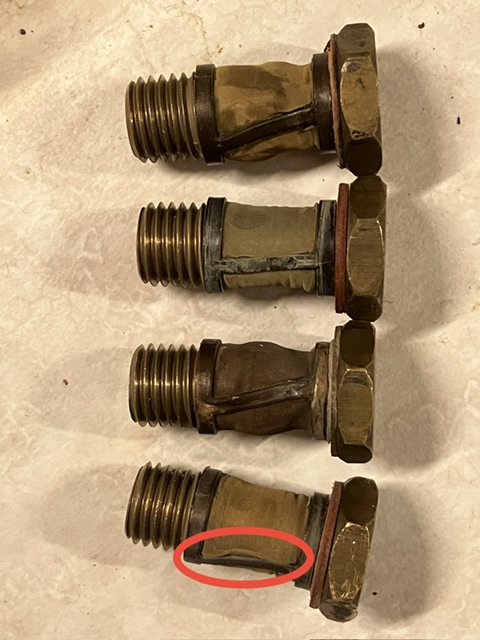

Carb debris (the first possibly a piece of Porsche fabric reinforced fuel line), sediment and torn carb knitted nylon mesh inlet filter.
