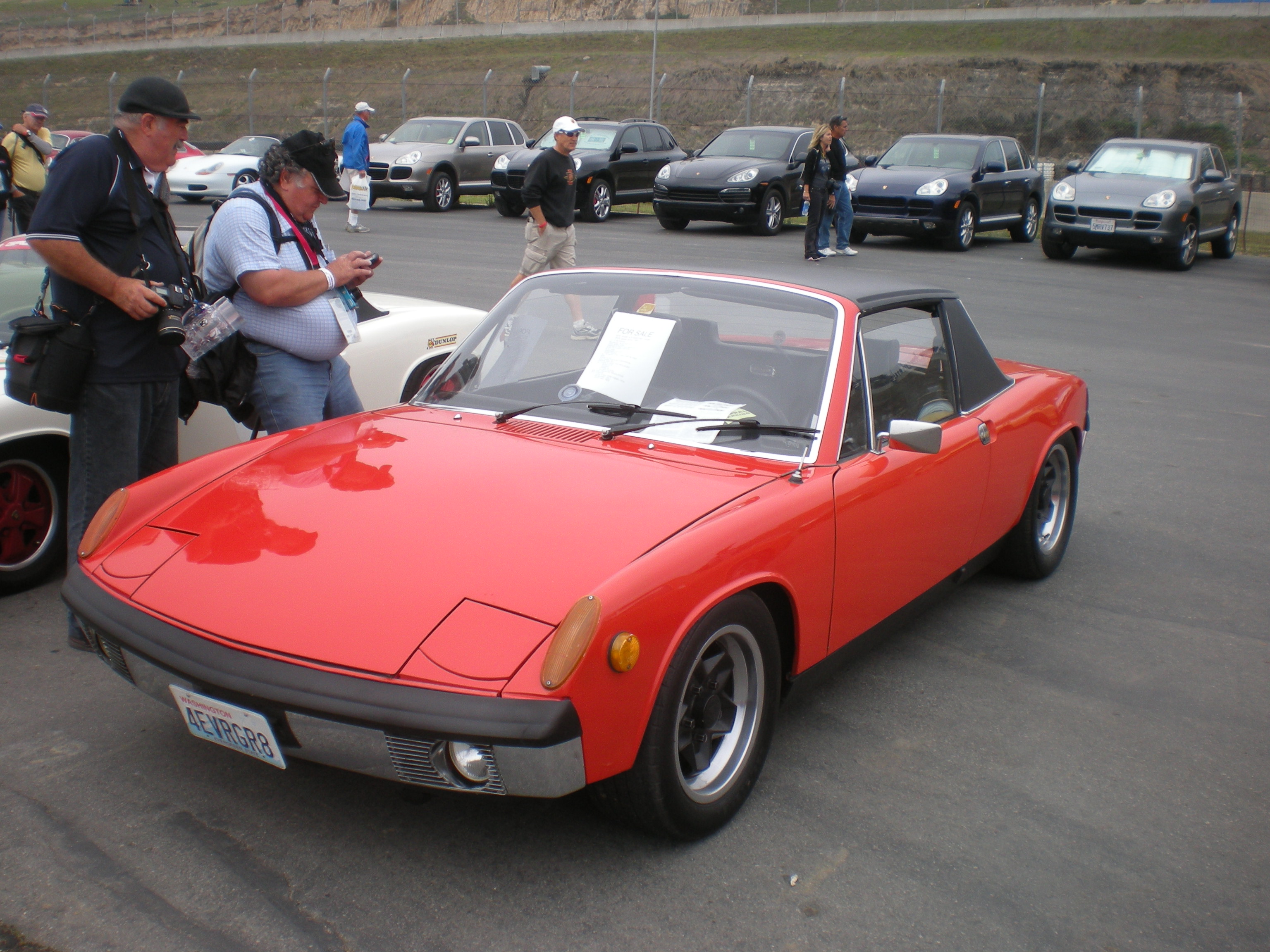

I saw this car at Rennsport IV in 2011. Have a couple photos to post.

lalee914   I saw this car at Rennsport IV in 2011. Have a co...   Jan 20 2024, 09:18 AM
infraredcalvin   Sidebar: That looks like @rick918-S 6 in the backg...   Jan 20 2024, 09:32 AM
lalee914   It was for sale at that time.   Jan 20 2024, 09:19 AM
lalee914   This photo is from July 2013. Don't know wher...   Jan 20 2024, 09:21 AM
