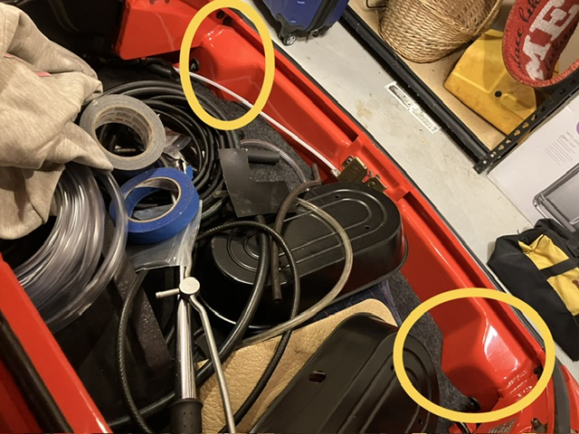

For comparison to PPI and seller’s 914world advertisement description & photos. (Maybe not that unusual or awful for a 50yo 914, but unknown to me before making purchase decision & negotiating a deal. A similar photo was provided by PO, between finalizing the purchase and taking delivery.) Again, please draw your own conclusions.

Krieger   I see that you paid a significant sum for a PPI. ...   Jan 20 2024, 09:53 AM

Cairo94507   Wow! $1K for a PPI that did not identify...   Jan 20 2024, 12:43 PM
Superhawk996   Wow! $1K for a PPI that did not identif...   Jan 20 2024, 12:48 PM

Rufus   Thanks for your thoughts guys. I should have bee...   Jan 20 2024, 10:42 PM

Rufus   The first 10 minutes of process of exposing the dr...   Feb 4 2024, 06:03 PM
