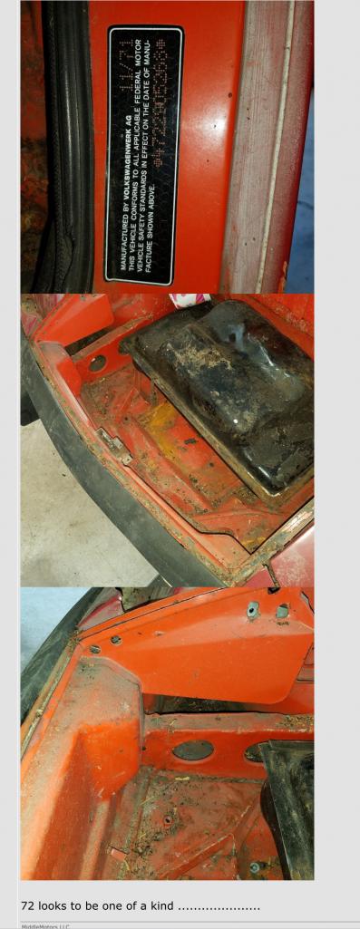

Krieger   I see that you paid a significant sum for a PPI. ...   Jan 20 2024, 09:53 AM

Cairo94507   It is very common for these 50+ year old 914's...   Jan 20 2024, 12:20 PM

Cairo94507   Wow! $1K for a PPI that did not identify...   Jan 20 2024, 12:43 PM
Superhawk996   Wow! $1K for a PPI that did not identif...   Jan 20 2024, 12:48 PM

Superhawk996   Central will be whether there’s any welding inv...   Jan 20 2024, 07:40 PM

mepstein   I would start asking around your area to see who c...   Jan 20 2024, 07:43 PM
sixnotfour   Haha I lived in wa ,,,call John ,, ask Gamroth for...   Jan 20 2024, 08:15 PM
Rufus   Thanks for your thoughts guys. I should have bee...   Jan 20 2024, 10:42 PM
Superhawk996   And would it be a good idea to remove the underc...   Jan 21 2024, 06:10 AM
