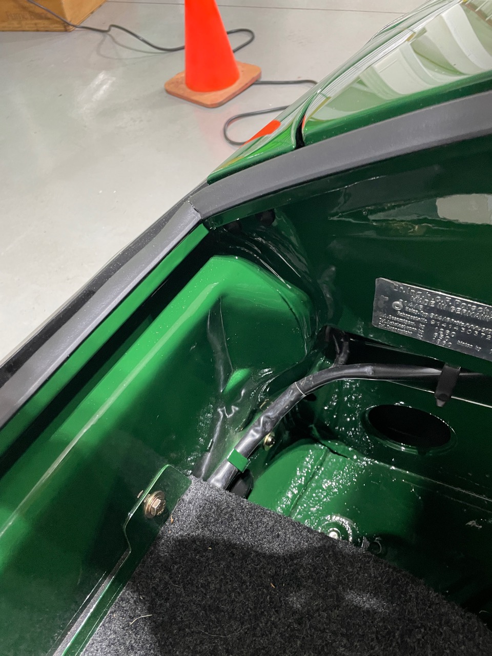

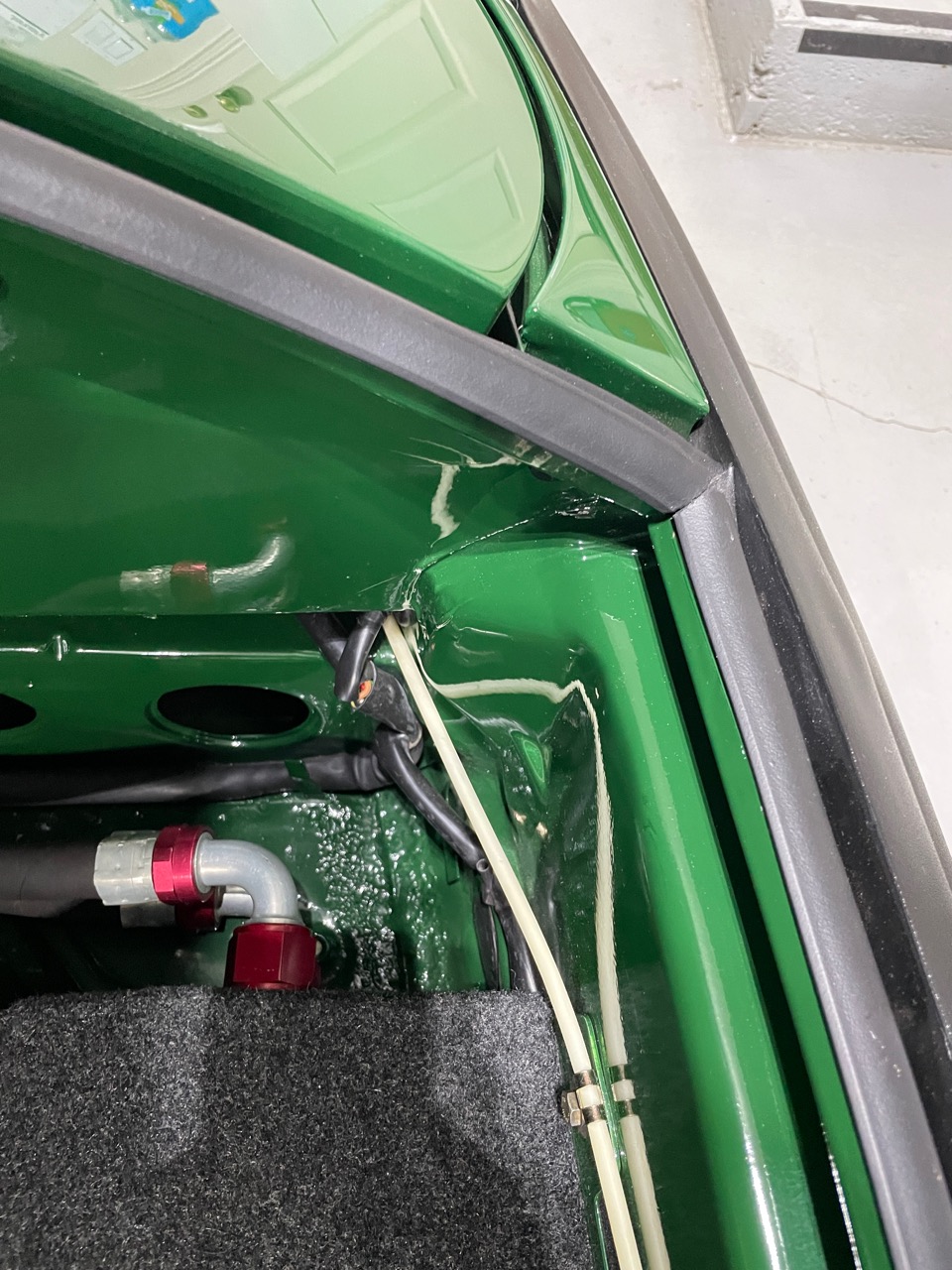

It is very common for these 50+ year old 914's to have had mishaps along the way necessitating panel replacements. Nose and rear panels were pretty common. I have attached 2 photos showing my '71 914-6 nose panel corners for reference for your consideration.
I know my car had a later factory nose replacement panel installed when I bought it. The give away was the round holes in the nose panel were not opened up. I sourced an NOS early panel (mid-year) and we modified that to perfectly match the original '71 (early) panel. I guess what I am saying is not to get to wound up about differences; they can all be addressed to perfectly match what came stock in a '70, or whatever year 914 you have, from the factory. So long as the panel is correctly installed- like factory, I see no harm.
The only issue I would have is if someone tried to pass a car off as having never had work, when it has. That is why I documented the entire process of my build for all to see. (IMG:style_emoticons/default/beerchug.gif)

QUOTE(Cairo94507 @ Jan 20 2024, 02:20 PM) *
Bingo. Though offering price seemed to indicate that the car had some issues.
And $1000 for a PPI that didn’t note this would piss me off. (IMG:style_emoticons/default/blink.gif)
Beginning to understand OP’s frustration but wasn’t sure where this was headed with the first few posts.
