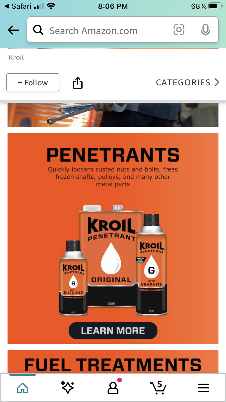

Corroded nuts & bolts? … penetrating oil? I’ve been using this successfully for 20+ years:
