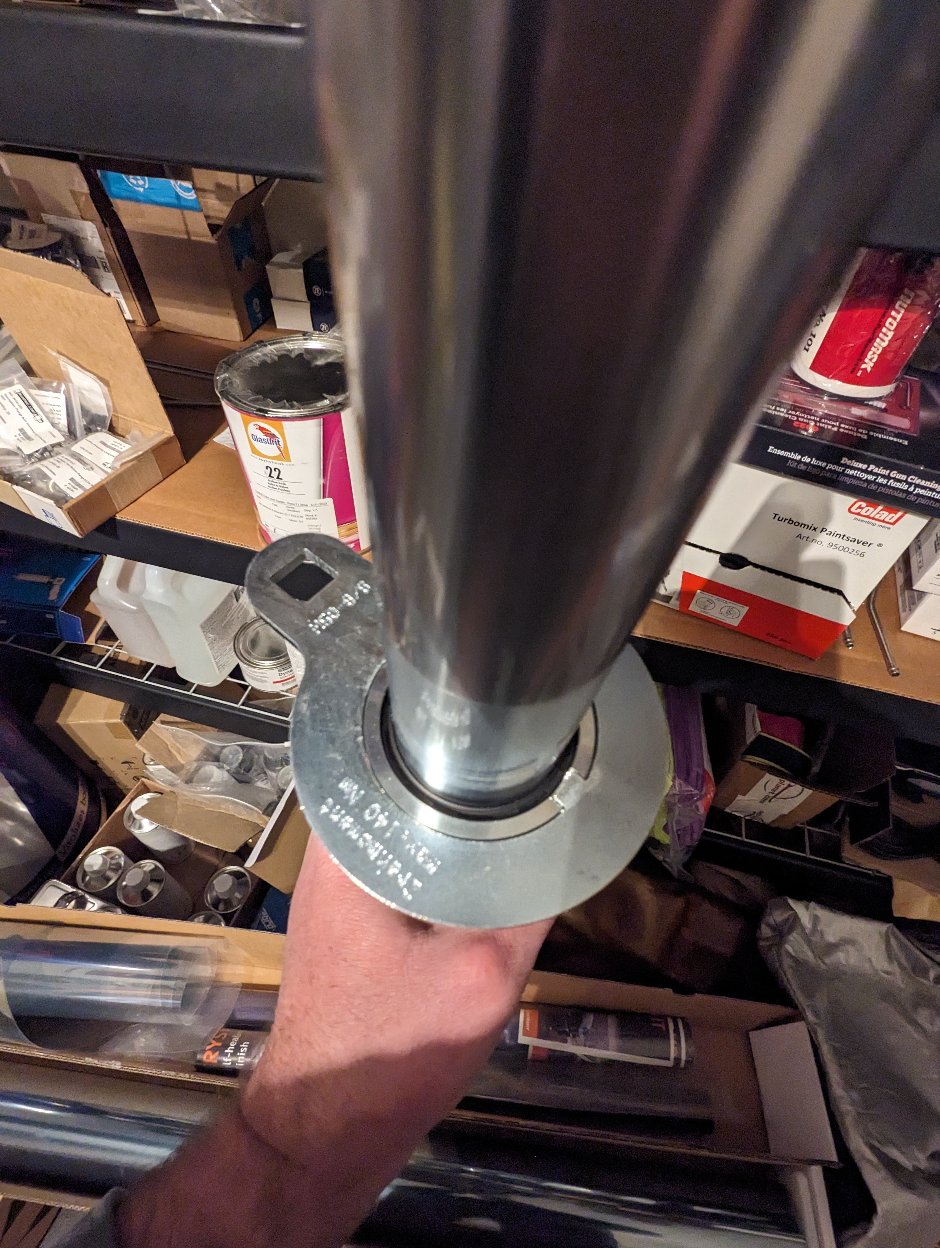

914 RZ-1   I bought both the tool from JimmyT and the wrench ...   Feb 13 2023, 10:16 PM
Van B   Thank you for posting that up! You just saved ...   Feb 13 2023, 10:19 PM
