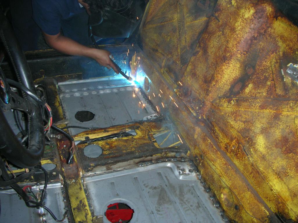

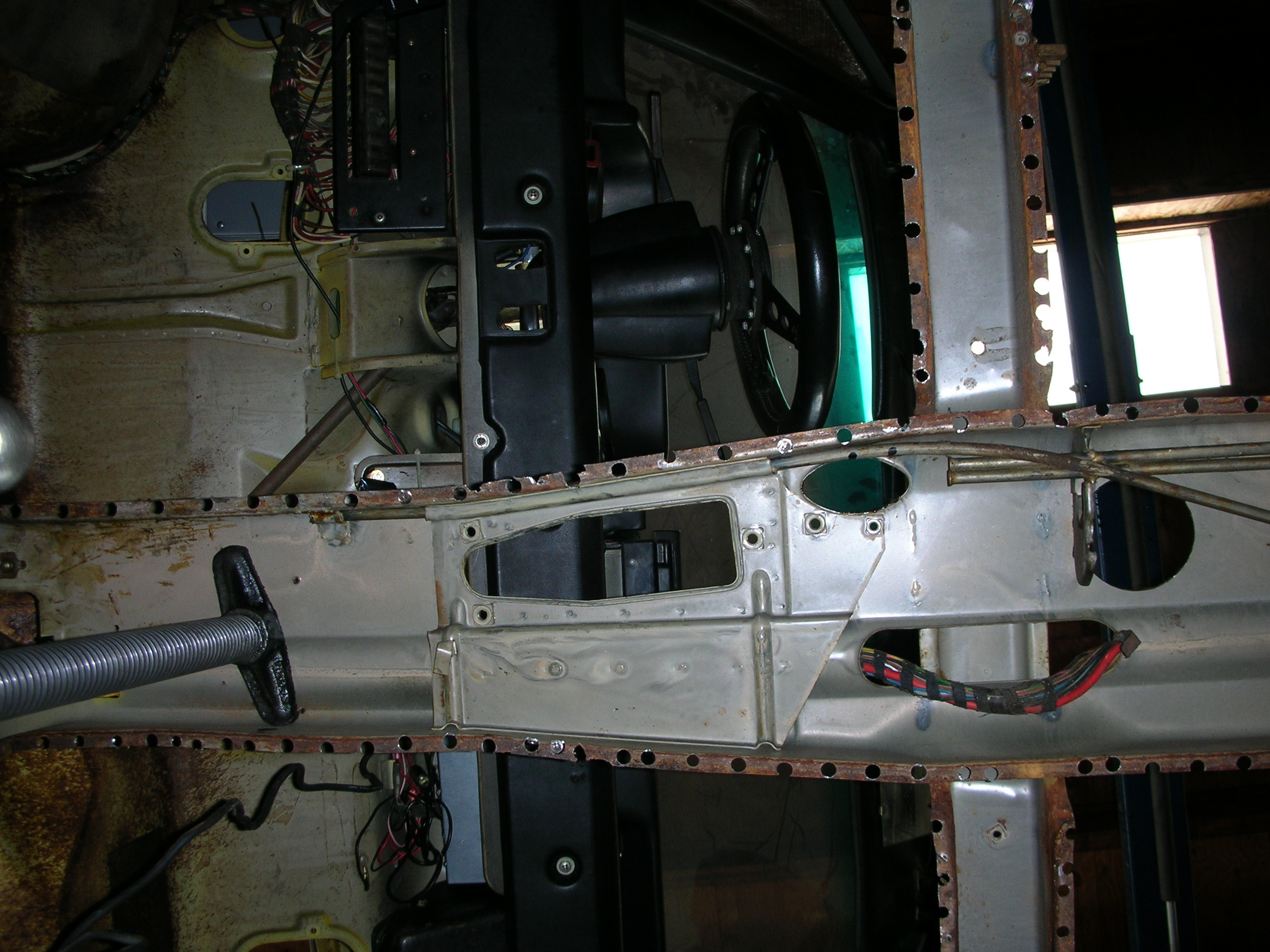

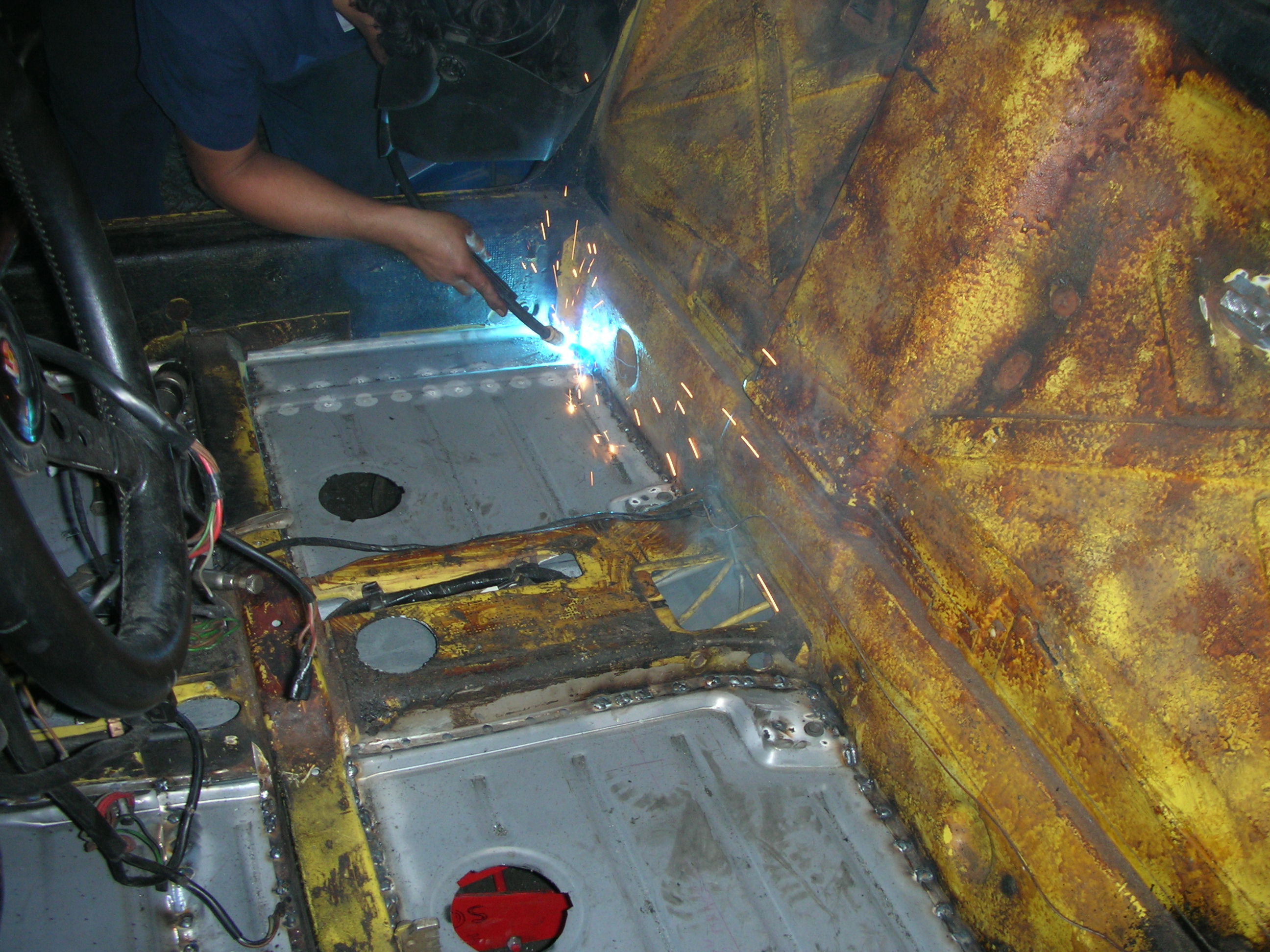

@Rufus
These pictures make it look easy but, here is what the pan replacement looks like. When you open up the bottom, you can fix of reinforce the clutch tube that has or will go out. It is just a matter of time for all 914s. Do it right because no matter what the documenting of this work is very important for resale and you want the comfort of knowing it is right. Mine was done on a lift. Mine is a real 6, the 30th one down the line
Best Bob B
