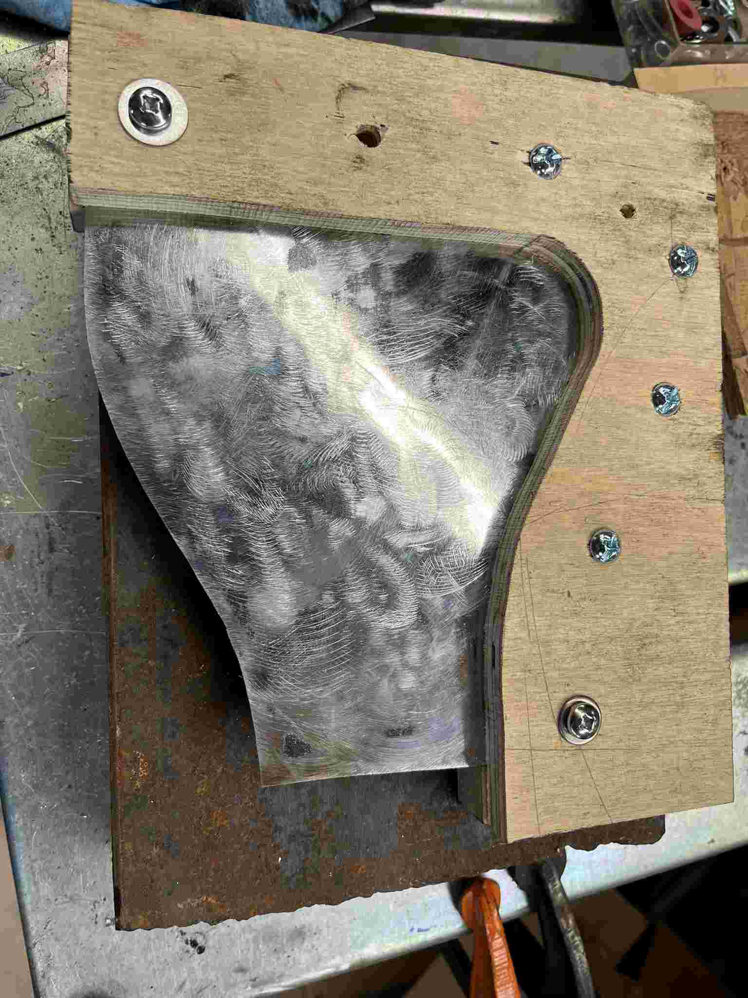

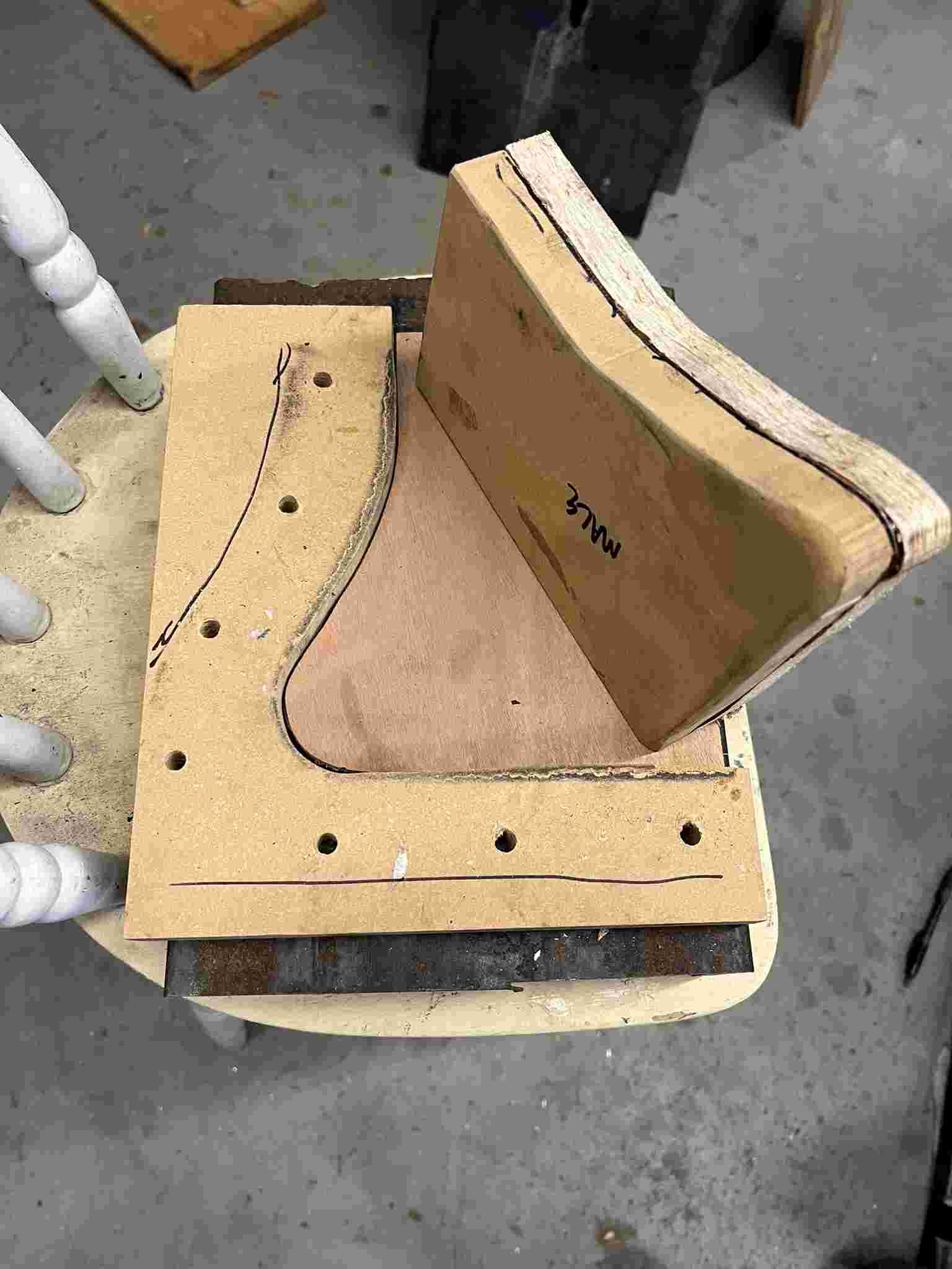

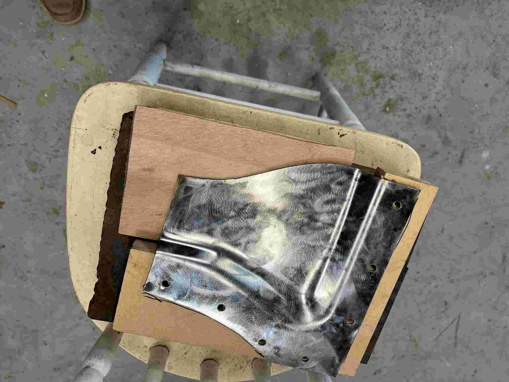

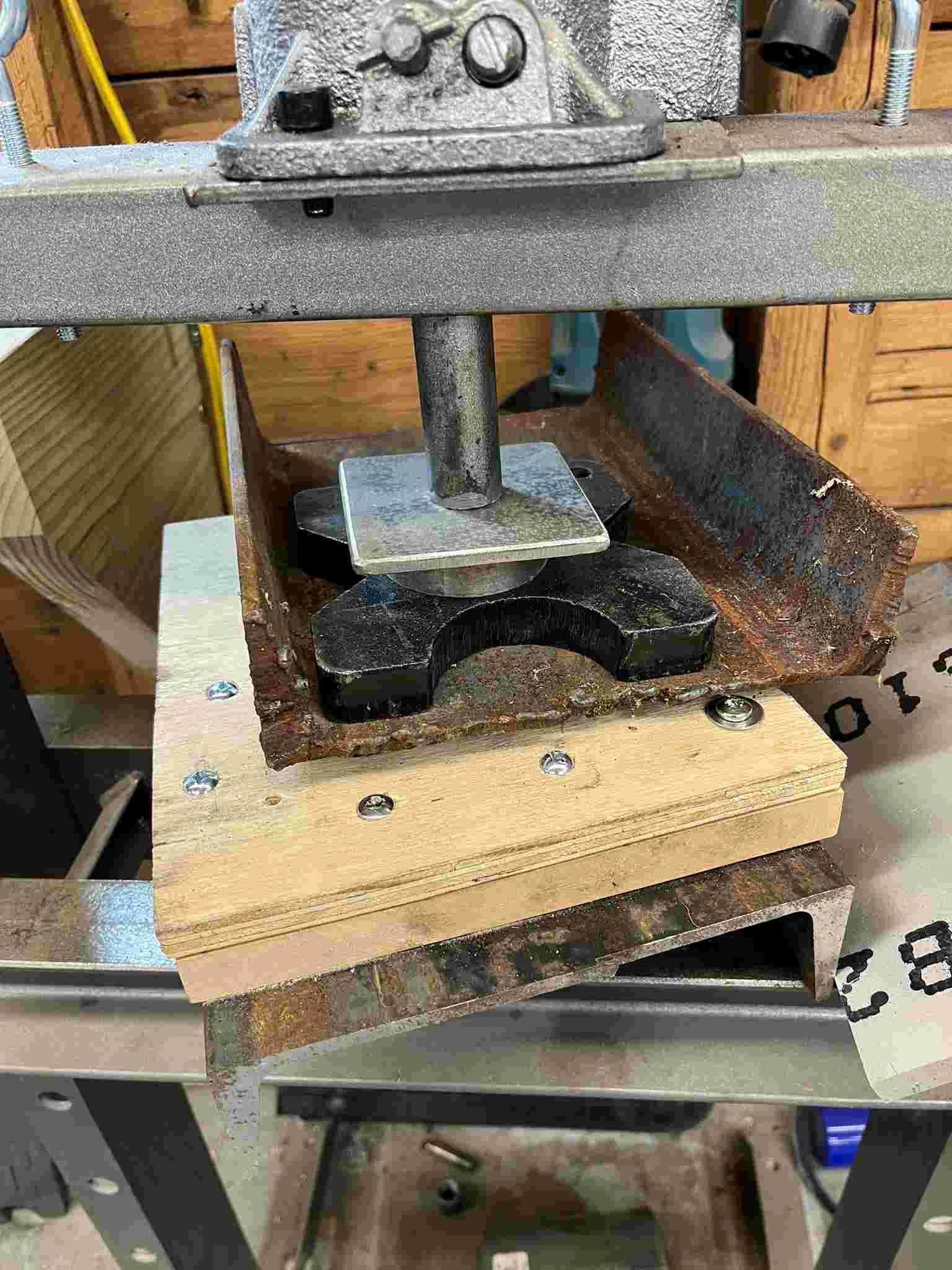

Took a shot at using MDF dies in my 12 ton press to form the corner of the floor rotted out under the hell hole. I wasn't sure if the MDF would be strong enough to stretch the metal in the corner, but it worked.
traced the shape onto paper from the section I'd cut out and made MDF and plywood male and female dies. The female die was bolted into threaded holed in a piece of steel. These screws also went though the sheet metal blank and a clamping piece of plywood to try and keep the flange flat.
Following pics show the setup and the formed blank. I need to trim off the excess material but the flanges didn't distort.
