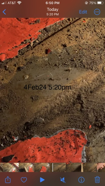

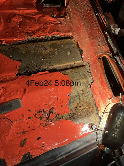

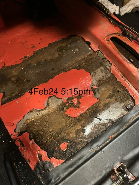

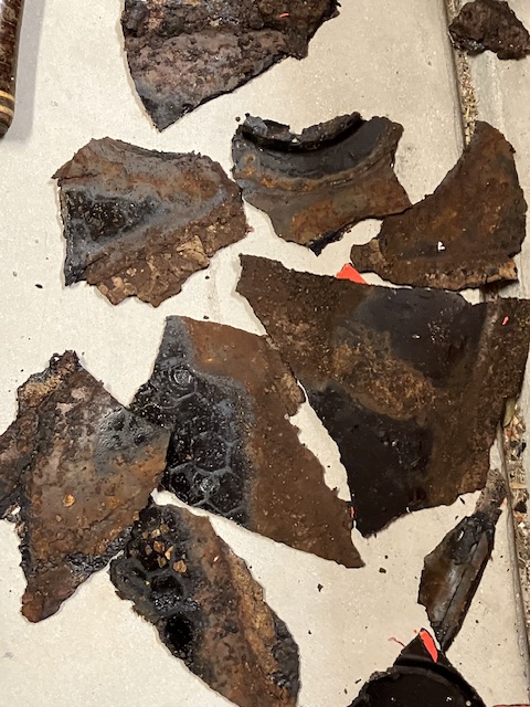

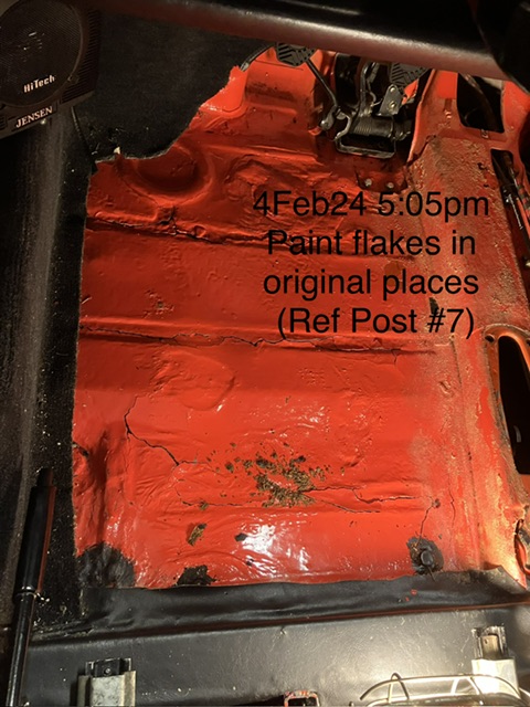

The first 10 minutes of process of exposing the driver’s side floorboard:

post Feb 4 2024, 07:38 PM
Matt
Posts: 953
Joined: 27-February 09
From: Eagles mere, PA
Member No.: 10,102
QUOTE(Rufus @ Feb 4 2024, 07:03 PM) *
Why the time stamp?
Matt

Rufus   The first 10 minutes of process of exposing the dr...   Feb 4 2024, 06:03 PM
mate914   The first 10 minutes of process of exposing the d...   Feb 4 2024, 07:38 PM
mate914   The first 10 minutes of process of exposing the d...   Feb 4 2024, 07:45 PM
