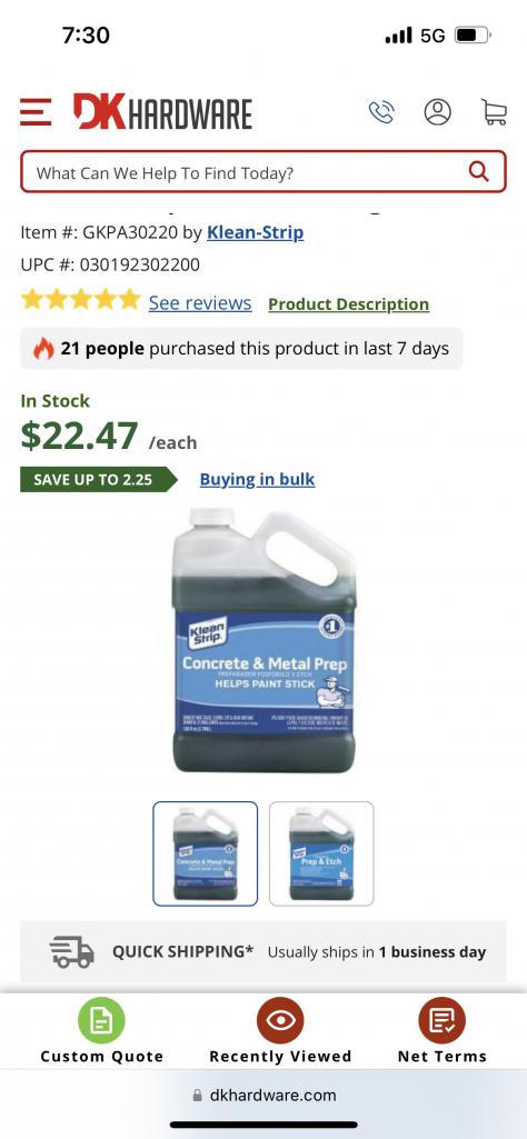

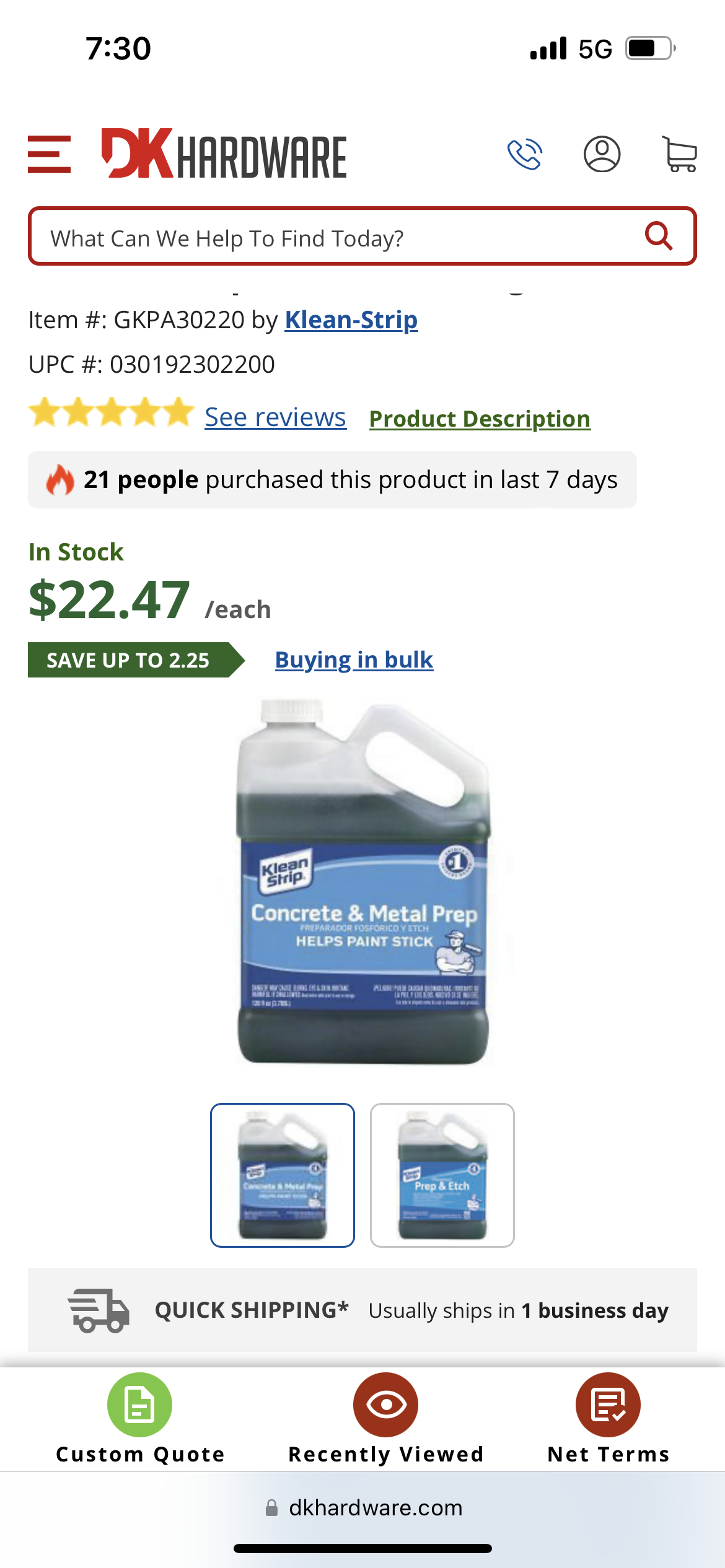

With a brush or spray bottle use this after you get it pretty clean. Let it sit for a good 30 minutes then wipe with water to neutralize. Then once dry quick Scotch brite , wipe, epoxy primer.Attached Image
