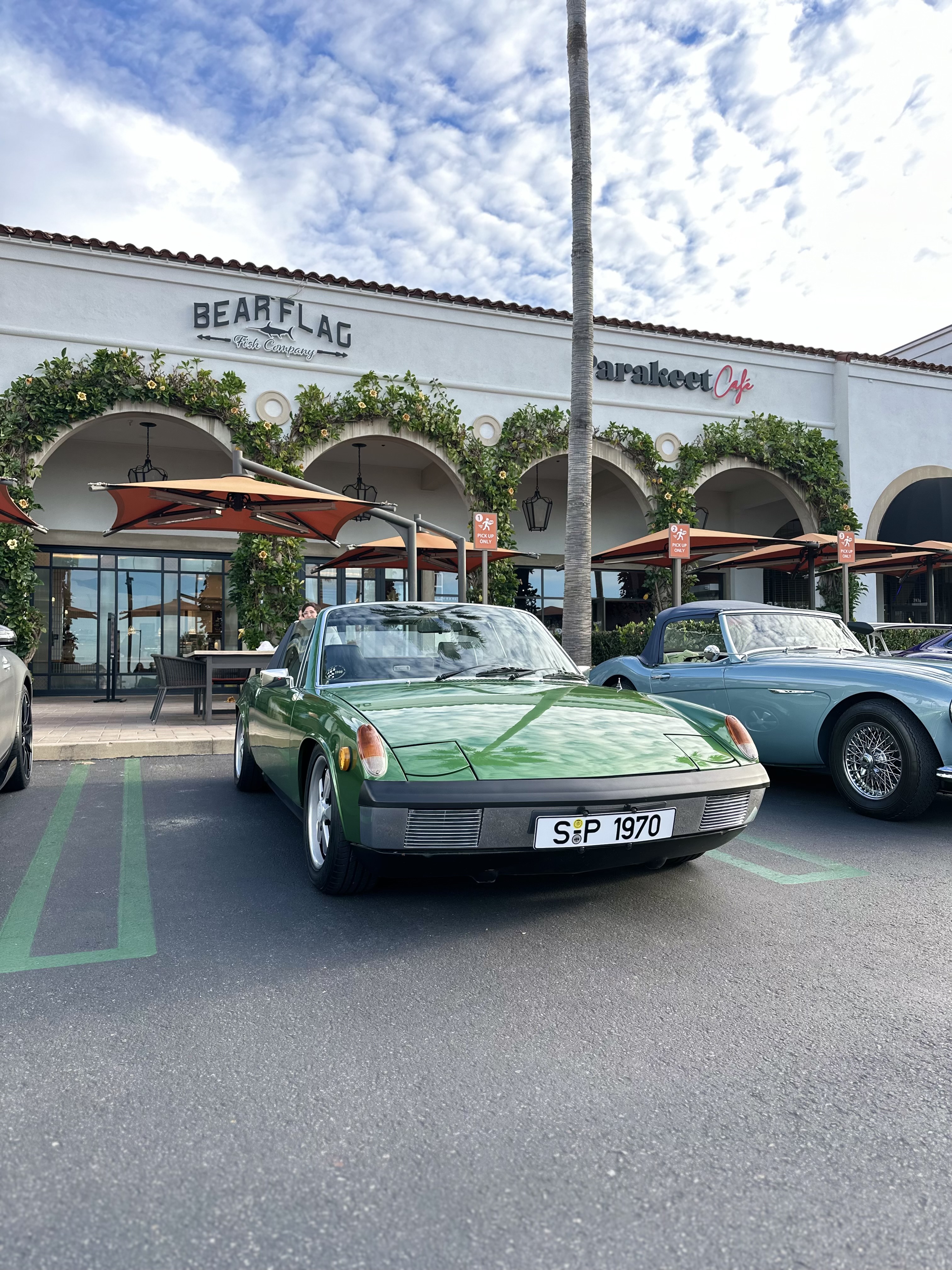

I watch this thread with great interest. I have a ‘70 914-6. Original #’s matching motor is stored away. Installed is a stock 3.2 with the original Weber carbs and fan assembly from the original motor. Motor looks stock with original air box. My goal is to not modify anything that isn’t reversable. The oil cooling is dual 930 coolers w/fans mounted below the rear trunk floor using existing mounts. So far this has worked really well including in stop and go traffic. Wheels are original deep 6’s modified by Weidman to R7’s front (205/55) and R8’s rear (215/50).
