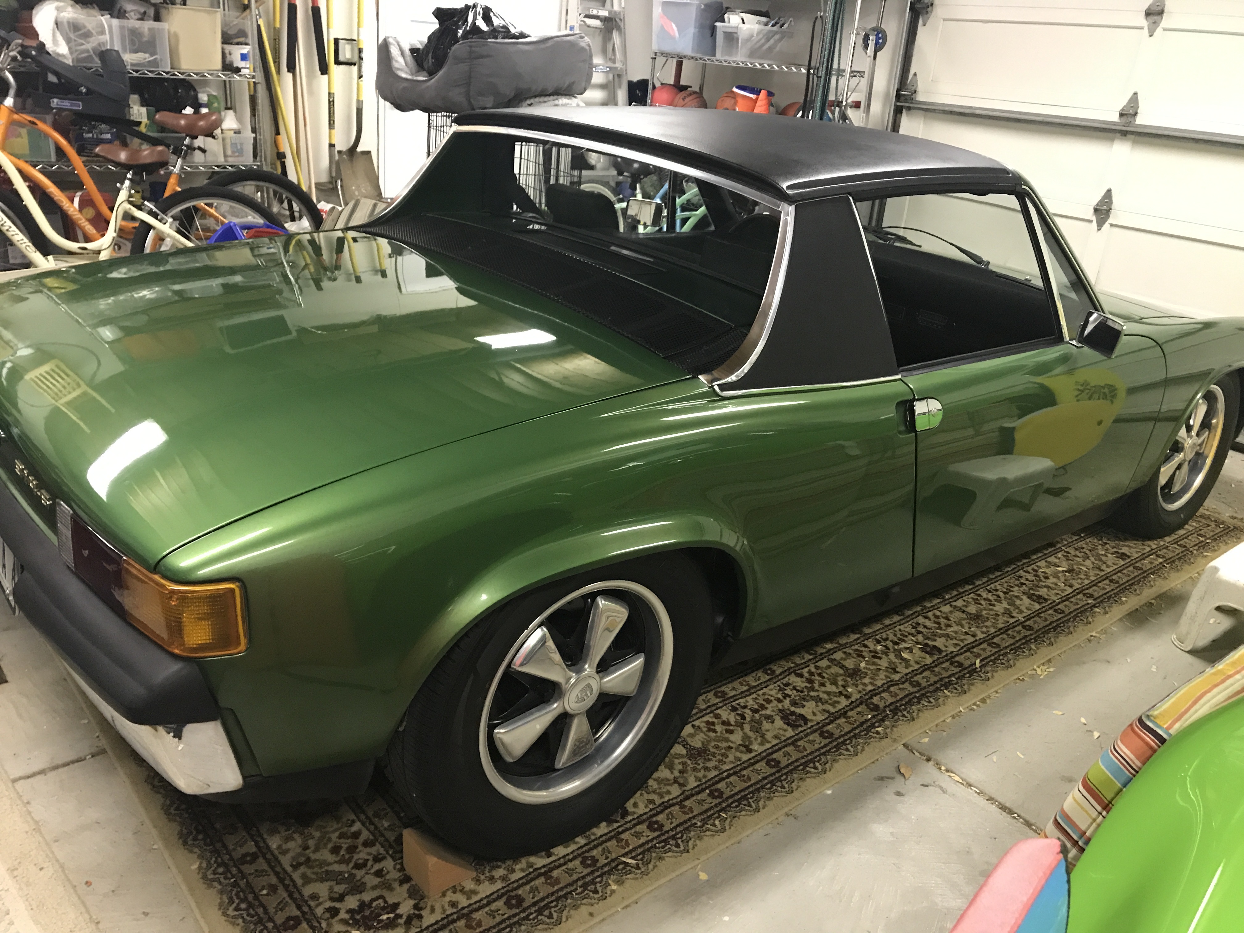

@Luke M - Yes, I have seen Enrique's set-up and that is very similar to what we do. Thanks for the link too.
[b]@4CamGT
- Great looking car and I totally appreciate the stealth nature of your car. Mine is similar but I stayed with the stock Motronic on my 3.2 and will keep the 3.6 stock as well. I originally considered Webers, I had a set, but then recalled that I was tired of playing with them and really wanted to be able to lean in the window and just turn the key. I know some cars with Webers will do that....but not many. But there is nothing like the sound of those Webers when you step on the loud-pedal.
BTW, did you have to roll your rear fenders at all to fit those rims/tires? I am thinking it would be nice to get a tiny bit more tire under the car - in the rear especially.

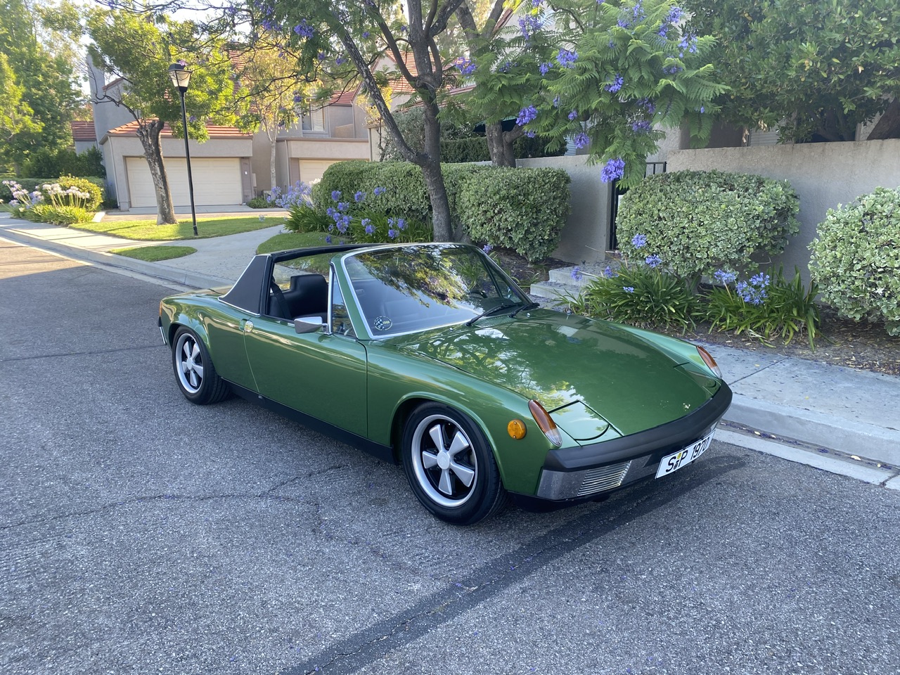

4CamGT
post Feb 25 2024, 03:50 PM
Posts: 19
Joined: 18-October 11
From: Newport Beach, California
Member No.: 13,688
QUOTE(Cairo94507 @ Feb 25 2024, 01:28 PM) *
<b>@Luke M - Yes, I have seen Enrique's set-up and that is very similar to what we do. Thanks for the link too.
[b]@4CamGT</b> - Great looking car and I totally appreciate the stealth nature of your car. Mine is similar but I stayed with the stock Motronic on my 3.2 and will keep the 3.6 stock as well. I originally considered Webers, I had a set, but then recalled that I was tired of playing with them and really wanted to be able to lean in the window and just turn the key. I know some cars with Webers will do that....but not many. But there is nothing like the sound of those Webers when you step on the loud-pedal.
The rear was slightly flared from when it was new. So far I don’t know how to post more than one photo at a time! The Webers on mine work flawlessly. Fires up hot or cold immediatly almost like FI. It was dyno’d at 235hp.Attached Image

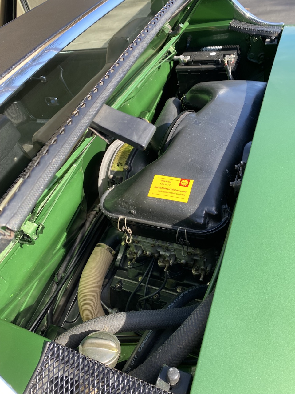

4CamGT   3.2 with the original Webers and fan housing assem...   Feb 25 2024, 04:03 PM
4CamGT   3.2 with the original Webers and fan housing asse...   Feb 25 2024, 04:04 PM
4CamGT   3.2 with the original Webers and fan housing ass...   Feb 25 2024, 04:06 PM
4CamGT   [quote name='4CamGT' post='3130690' date='Feb 25 ...   Feb 25 2024, 04:08 PM
