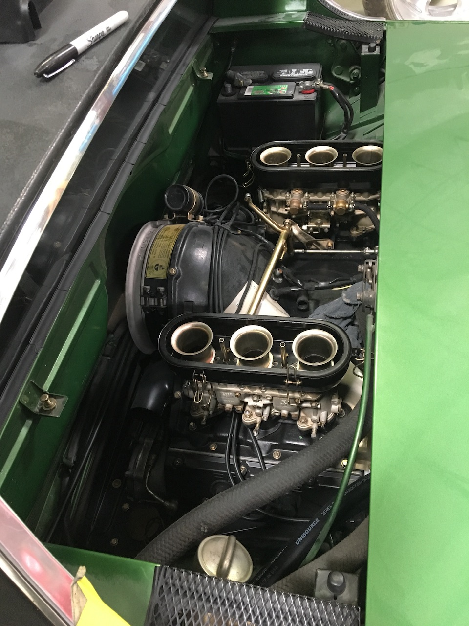

3.2 with the original Webers and fan housing assembly.

4CamGT   I watch this thread with great interest. I have a ...   Feb 25 2024, 02:36 PM

4CamGT   3.2 with the original Webers and fan housing assem...   Feb 25 2024, 04:03 PM
4CamGT   3.2 with the original Webers and fan housing asse...   Feb 25 2024, 04:04 PM
4CamGT   3.2 with the original Webers and fan housing ass...   Feb 25 2024, 04:06 PM
