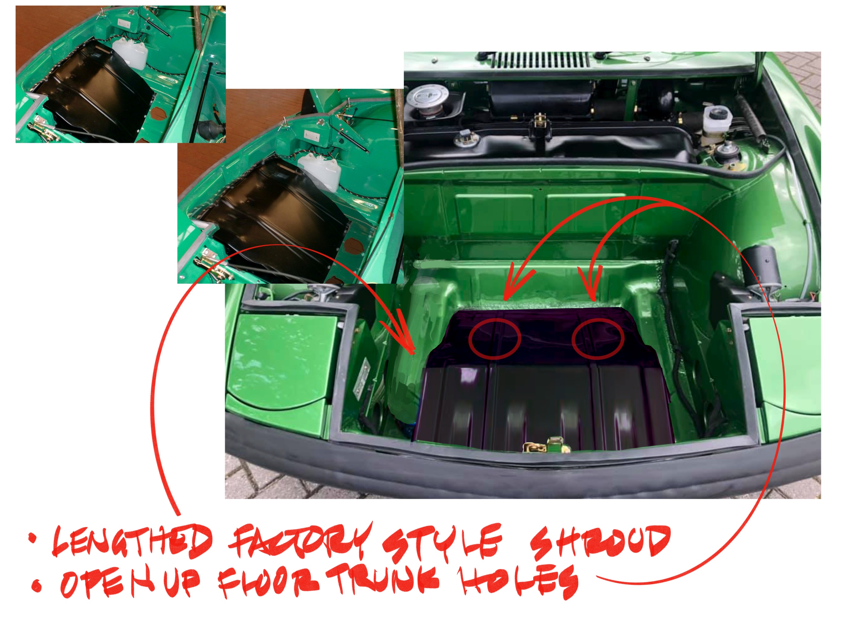

Like Chris says, "If it were easy, everyone would do it". (IMG:style_emoticons/default/beerchug.gif)
After 2 days of researching coolers, fans, talking with the experts, I ordered a different Setrab oil cooler. I have to thank Marv at Setrab. He walked me through Oil Cooler 101 and I learned the cooler I got from PMS, a single-pass, would work. But better than that is the same cooler in double-pass configuration. The double-pass provides 5-8% better cooling and is their highest performance oil cooler. We are also going to go with 3 5.25" "puller" fans that move 340 CFM each. So that should be moving a lot of freakin' air.

QUOTE(Cairo94507 @ Feb 26 2024, 02:28 PM) *
I’m interested to see how well the louvered slots work vs opening up a rectangular hole as per factory GT. I like the idea of using the bulkhead holes. One idea I had early on was to fabricate a lengthened factory style shroud that extended to the rear floor holes. Maybe this could work with fan assist as an example of minimal mods that could be reversed?

tygaboy   Michael opted for a dual-pass Setrab cooler and th...   Mar 5 2024, 11:53 AM
Cairo94507   Parts have arrived- Yay! I know Chris wants t...   Mar 5 2024, 02:49 PM
tygaboy   I'm working up a one-piece cooler/fan mount wi...   Mar 16 2024, 01:19 PM
technicalninja   Looks NICE! I prefer the fans on the cooler v...   Mar 16 2024, 02:59 PM
SirAndy   Not picking nits here but maybe add a few more hol...   Mar 16 2024, 03:36 PM
tygaboy   RE: comments about how the fan mount, clearance to...   Mar 16 2024, 06:39 PM
