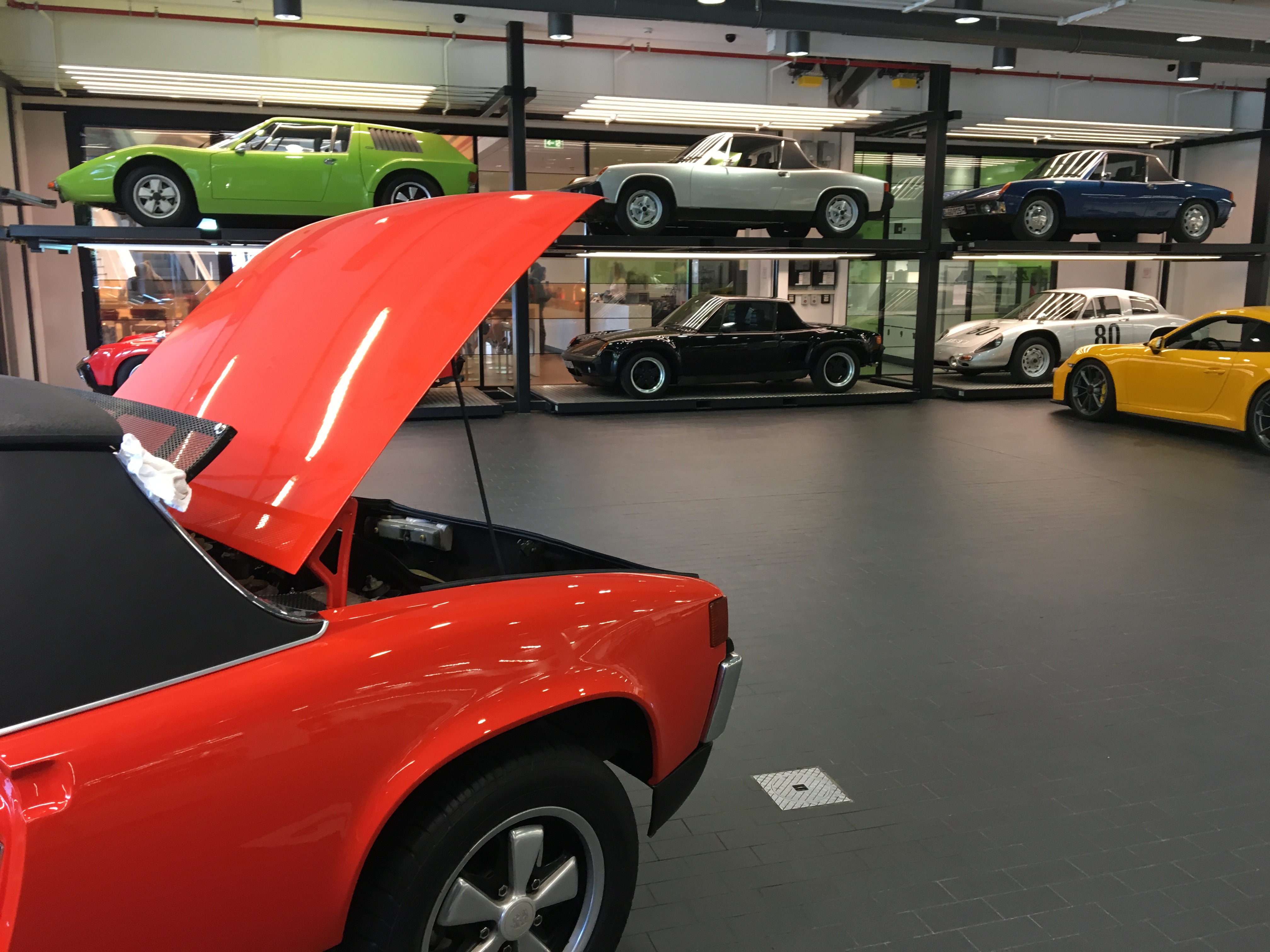

It happened it was the year the Porsche Museum was celebrating 50 years of the 914!
