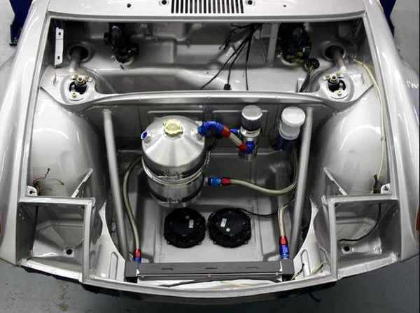

My car has the PMS front Setrab cooler along with dual fans (on a manual switch under the dash). In -most- normal driving situations here in SoCal, just the cooler without the fans works pretty well, when temps pop up a bit (driving hard or sitting in traffic) I will flip the fans on for additional cooling, have considered just putting them on a thermo switch so they kick on or off at temps but doing it manually isn't really a big deal... But then again I also have that massive Petersen style oil tank with 12-14qts in it --This is a pic without the fan shroud in place (IMG:style_emoticons/default/chowtime.gif)

QUOTE(eric9144 @ Feb 27 2024, 10:06 AM) *
This is an interesting layout. Do the fans get in the way of ventilating the heat out when the fans are off vs having the fans mounted to the cooler? How big is the inlet hole on the bulkhead?

eric9144   My car has the PMS front Setrab cooler along with ...   Feb 27 2024, 12:06 PM
4CamGT   My car has the PMS front Setrab cooler along with...   Feb 27 2024, 05:47 PM
Cairo94507   For anyone interested, the oil cooler and fans in ...   Feb 28 2024, 12:53 PM
eric9144   This is an interesting layout. Do the fans get in...   Feb 28 2024, 01:41 PM
