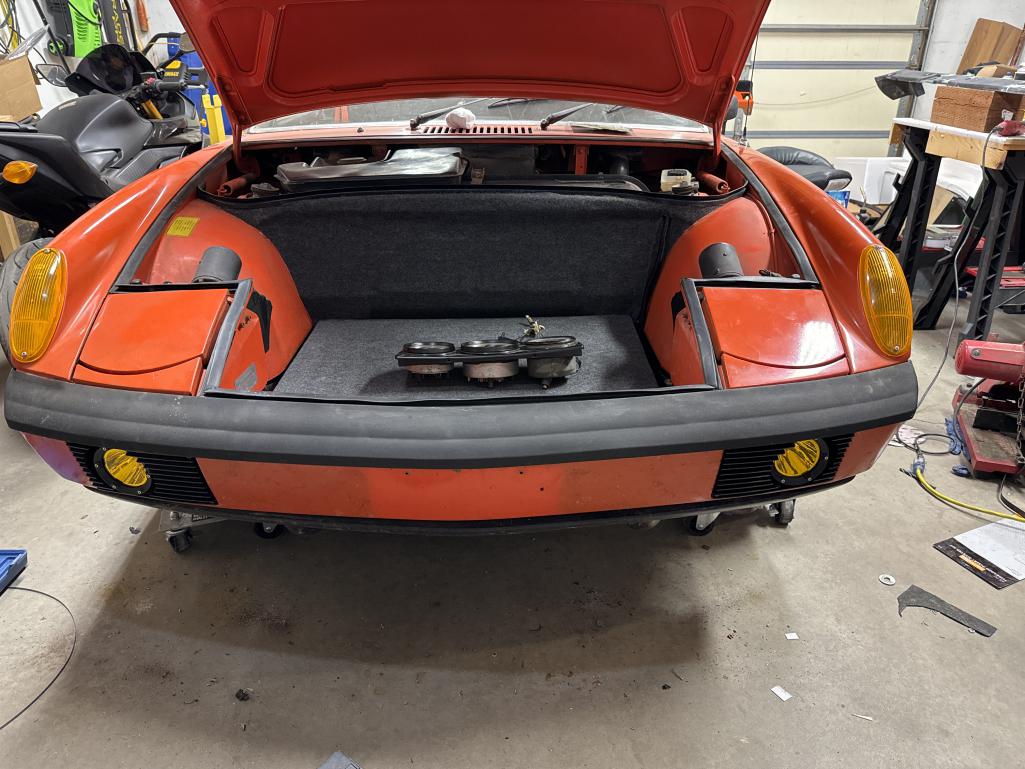

Got the fog lights mounted and wires run today
