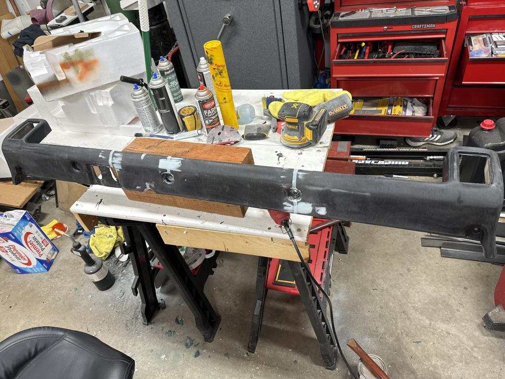

started the process of fixing the dash cracks. Using bondo with fiberglass, then skim coat of regular bondo. will be flocking this weekend. There is a corresponding portion of the metal dash component that will be flockled as well.

drdriddle   Did the metal part of the dash last night. This is...   Feb 23 2024, 04:11 PM
drdriddle   Also did a glovebox delete. Couldn’t get it to l...   Feb 23 2024, 04:13 PM
burton73   Are you using a flocking gun and slow dry BK ename...   Feb 23 2024, 05:02 PM
drdriddle   Yes it’s a flocking kit. It’s a brush on self ...   Feb 23 2024, 08:45 PM
