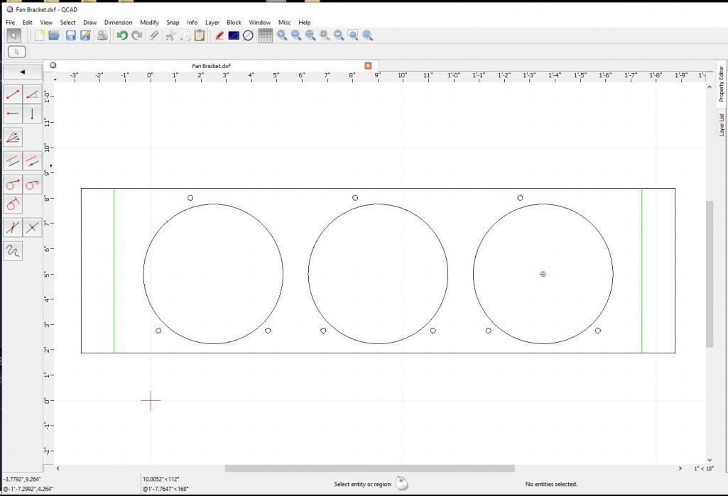

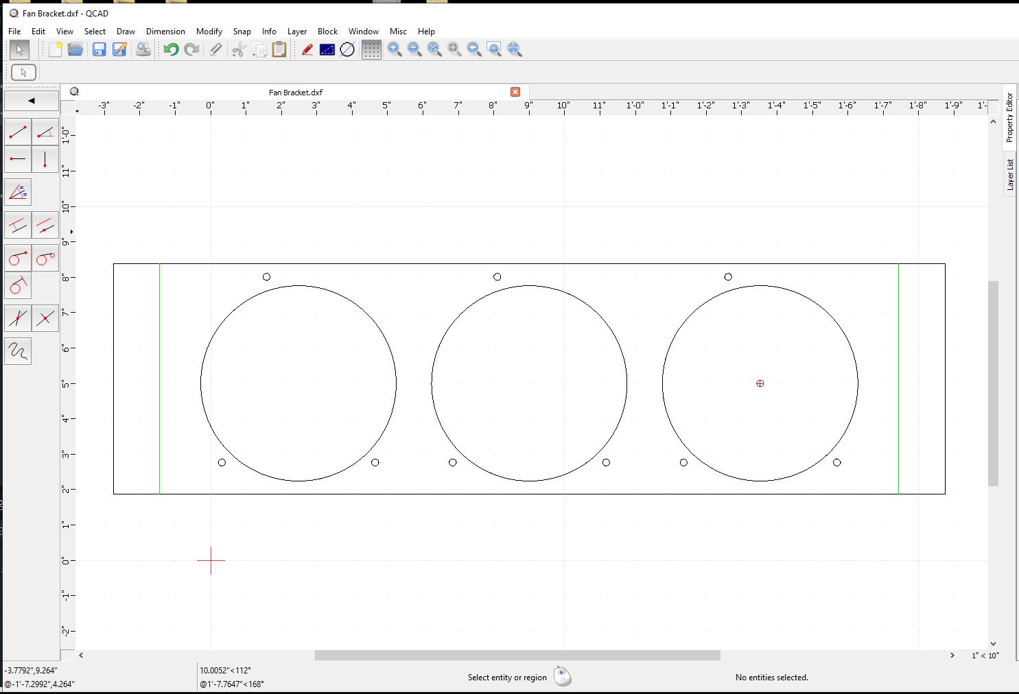

Michael opted for a dual-pass Setrab cooler and three fans. Setrab doesn't offer a fan mount set up for that particular cooler so it's CAD/plasma table to the rescue.
Here's the start of the fan mount. The green lines indicate the edges of the cooler core, the outer shape is the cooler body. This just gets me started on the fan positions.
Now I need to work out how I want to mount this to the cooler. I think it'll be sections that'll fold over and serve as the attachment points.

tygaboy   Michael opted for a dual-pass Setrab cooler and th...   Mar 5 2024, 11:53 AM

tygaboy   I'm working up a one-piece cooler/fan mount wi...   Mar 16 2024, 01:19 PM
technicalninja   Looks NICE! I prefer the fans on the cooler v...   Mar 16 2024, 02:59 PM
SirAndy   Not picking nits here but maybe add a few more hol...   Mar 16 2024, 03:36 PM
tygaboy   RE: comments about how the fan mount, clearance to...   Mar 16 2024, 06:39 PM
Cairo94507   Outstanding work Chris; I know this is going to wo...   Mar 17 2024, 06:15 AM
mb911   I am sure it will work great. I am thinking it may...   Mar 17 2024, 06:58 AM
