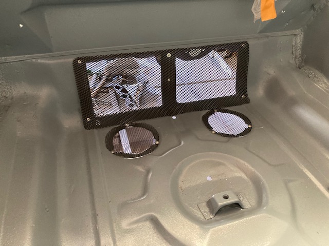

In addition to the wheel well holes, has anyone ever tried cutting holes like this at the steering rack recess to draw air? I feel like this space would create a good low-pressure area from air moving under the car.
Yes.. This is mine..

slowrodent   In addition to the wheel well holes, has anyone ev...   Mar 7 2024, 09:14 AM
jamlip   Interesting, thank you. Do you have the fenders cu...   Mar 7 2024, 04:52 PM
slowrodent   No.. I just have these as exit holes, and I have o...   Mar 7 2024, 08:10 PM
