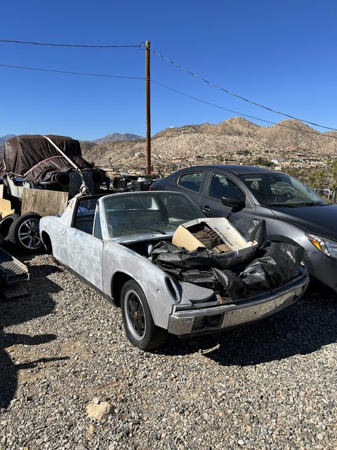

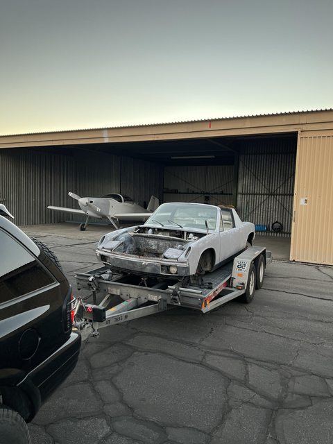

Checking in as the new owner of a 1971 914.
IPB Image
Dragged out of the desert yesterday. Basically a shell, a steering rack, one wheel and a title.
Appears to be in decent shape. Probably needs a floor (rust penetration), definitely needs a front pan (cut up, no idea why) and some repair to the hellhole (small rust hole, but unsure what lies beneath). Rockers, doors and rear trunk appear to be very nice. There is light crash damage to the front left which has been hammered-out. I can't find bondo on it anywhere.
Kind of hesitant to post this as I've always wanted a 914, but unsure if this is the one. Long-time Porsche fan - owned a '72 911T when I was in my mid-20s, and now have a twin-plugged 912 which I restored (from a shell which wasn't a whole lot nicer than this).
Anyway, I have a rough idea of what I want to do with it. In the time being, I need to start hunting down some parts. Lots of parts.

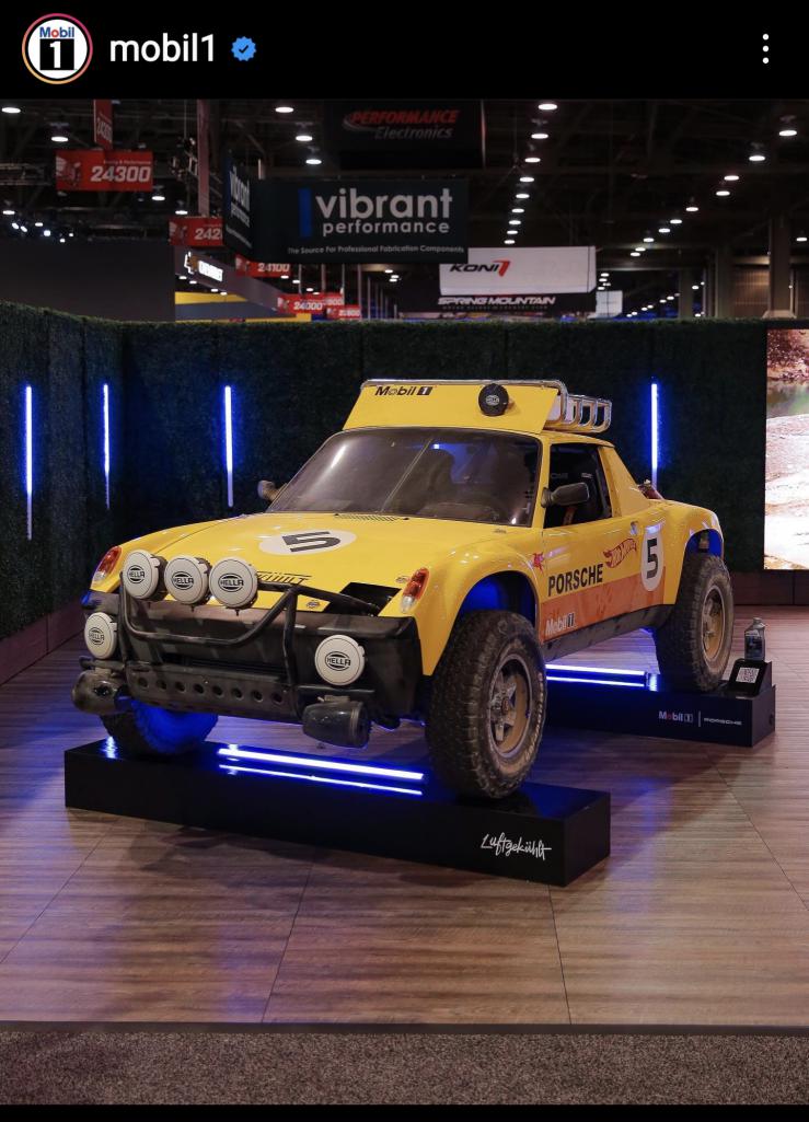

There was a nice Safari build at SEMA ...
http://www.914world.com/bbs2/index.php?showtopic=356602
IPB Image

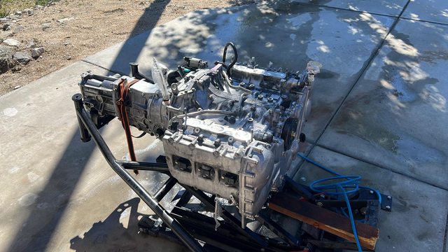

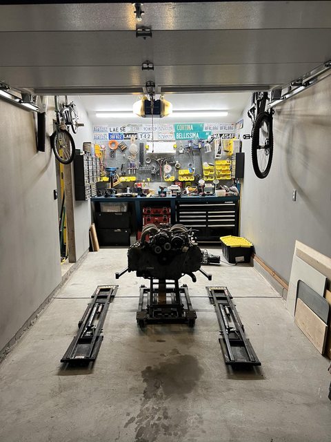

So yesterday I swung-by a place in LA that sells used JDM motors, and picked one up. I realize I should have bought a whole donor car, but manual six-cylinder Legacys are all either rodded, or have 250,000 miles on them. Plus, I don't much want one sitting in my garden or hangar - I already have this god-awful 914 shell to look at.
IPB Image
IPB Image
I also picked up a five-speed 5MT manual transmission for it, before stopping in at Ikea and loading several closet casings on top of the whole thing and driving 100 miles back to the desert.
IPB Image
IPB Image

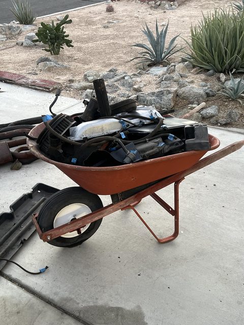

Earlier in the week, whilst working down near San Diego, I also bought a hood, engine grille, rear brakes (which I forgot I already had) and front struts (which I also forgot I already had - what is wrong with me?). I also picked up this lovely old Racemark / Raid steering wheel.
IPB Image

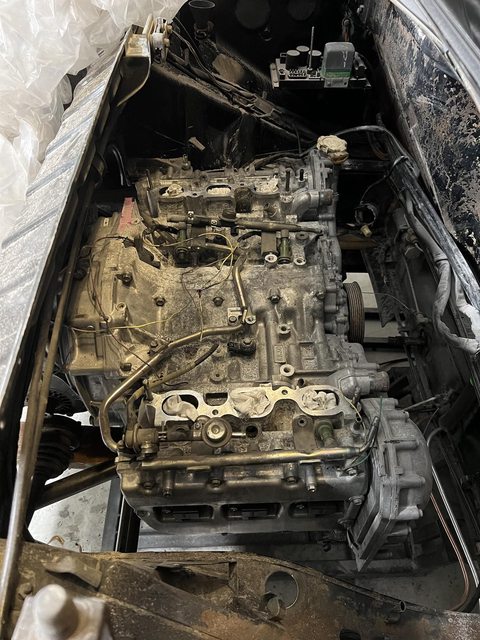

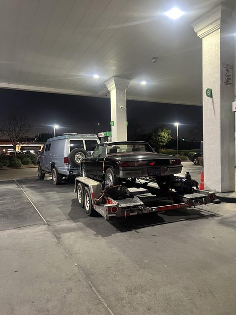

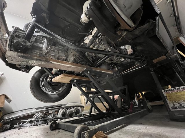

So this evening I unloaded the engine from my car...
IPB Image
Then dragged this over and tried it for size...
IPB Image
And then stood back and wondered, for quite some time, why I create these projects for myself.
IPB Image
Anyway, if you look carefully you'll see the streering wheel is flopped away from the dash. Next I need to hunt-down the whole upper steering column assembly - mine has been pilfered.

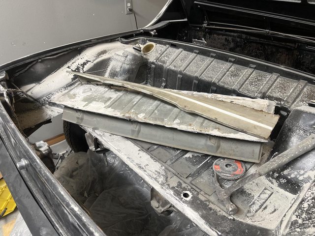

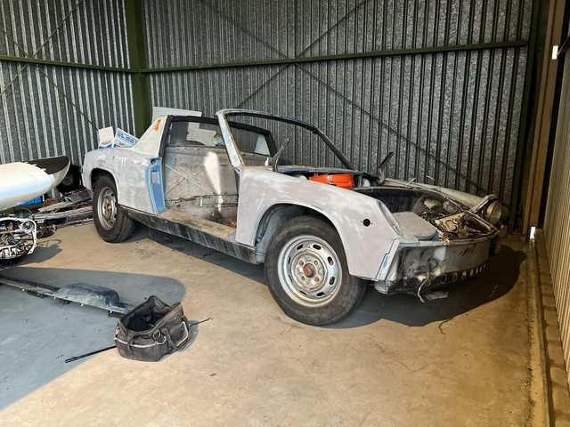

Few more hours on the car this evening. I'm taking it right down to the shell - I just find things way easier to work on when they're pared to their most basic form.
My friend Logan gave me a set of wheels so I can at least get the car rolling. They're just cheapo steelies from JBugs, but when I put them on the car I actually kind of dig the look, and it got me thinking.
IPB Image
When I started restoring my 912 all those years ago I had all these ideas about what I wanted to do with it. One of them was to make the most base-model 912 imagineable, and that is kind of how it ended-up. At least in terms of appearance - underneath there's a twin-plugged injected motor and lots of covert chassis lightweighting (it stands, ready to drive with half a tank of gas, at 1945lbs).
Anyway, I still love the 'all-go, no show' concept, and I think it'd be fun to do it to the 914, although go even more hardcore - just a tub and an engine. No heat, no dash, no trim pieces anywhere. I'm aiming for somethign I can thrash off-road, so I'm thinking just spray the whole thing black and vinyl wrap the sides whatever colour I fancy at the time.

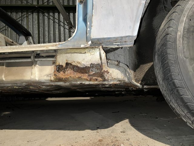

The car is nearly down to nothing now. I pulled off the right rocker cover and discovered the bottom of the A-pillar had rotted out where the AC lines entered from the wheel well / cabin. I guess it was condensation from the lines that did it. Bummer. Found a repair section on Restoration Design, so not too much of an issue.
IPB Image
Still trying to work out if I buy a front trunk repair panel at $250 (to replace the current one which has been cut for A/C) or just patch in some sheet steel. If I take this thing out in the desert that pan is going to get eat a lot of rocks.
Another thing I'm trying to work out is whether I have the shell sand/media/vapor blasted or just leave as is. It's really nice to work on a clean shell but it's perhaps $1000-1200 I don't need to spend on something I plan to ultimately be thrashing the balls off.
I think I know what I'm going to end up doing, I just haven't admitted it to myself yet.

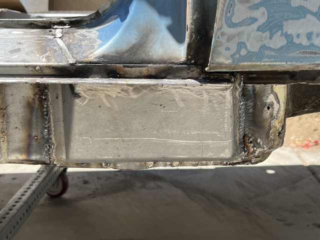

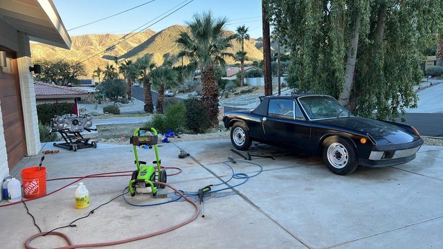

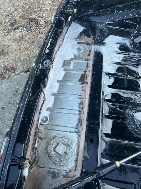

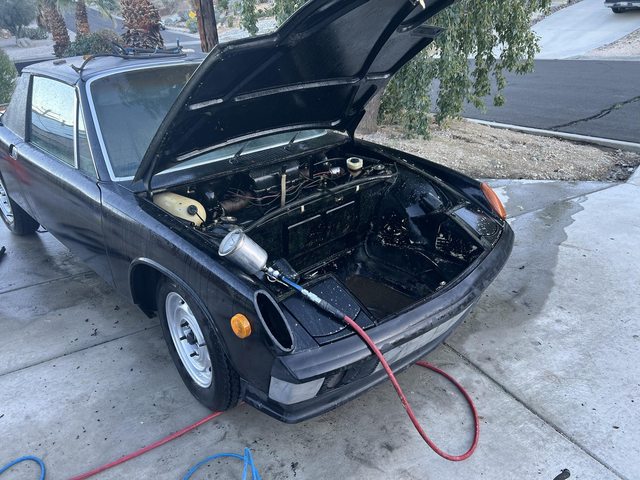

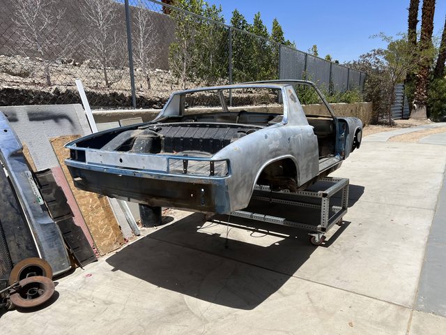

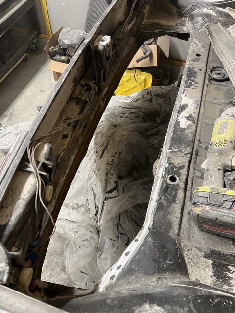

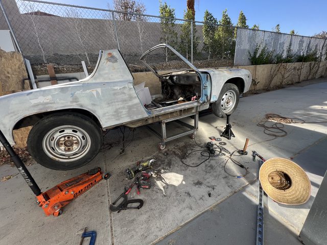

Going in. Car has been moved from the hangar to my house. I've almost stripped it bare - just the harness and a few odds and sods to remove now.
I welded on a new A-pillar base, then ran out of argon. Need to do passenger floor and a small patch in the trunk.
Then a bit more welding to stiffen it up, jet wash it, bond on the roof and hit it with some farm implement satin black. I may do the outer panels in a separate color when I'm done.
IPB Image
IPB Image
Straight to hell for this one. Also, If I spot a seam, I'm going to weld it. I plan to bounce this car over the desert and want to do everything I can to stop it snapping in half.
IPB Image
IPB Image

A few months ago I decided to sell my '68 912. I had owned it for 13 years after restoring it from bare metal (build thread here, if you're interested). It was an absolutely stunning car but I'd scratched the itch and was looking for a new challenge.
The 912 went to its new owner in Santa Monica few weeks ago, and 12 hours later I was the new owner of a 914 with a blown engine, bought from the brother of a friend in San Diego.
IPB Image
It's a 73, black with appearance pack. It's a SoCal car and is "rust free" (of course there is no such thing, and I was about to find out this one was hiding a dark secret).
I'd had the Subaru EZ30 sat on a JWK cradle in my garage for months and had even tried to sell it on FB Marketplace with zero success.
IPB Image
Once the car was home, I set to work with degreaser and a jet wash.
IPB Image
IPB Image
... also the engine.

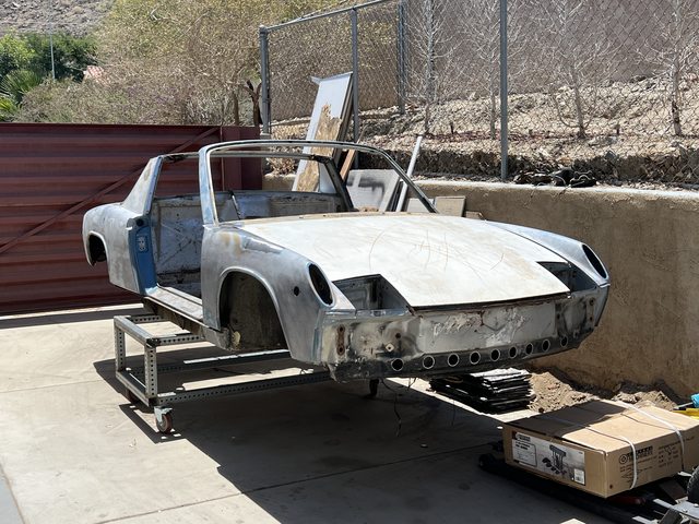

Digging around the car, I was pleased to see the front trunk was un-cut and the front slam is in good shape. The floors, longs and A-pillars are perfect. The hell-hole needs sorting (find me one that doesn't).
When I bought the car, the rear trunk was filled with engine tinware. On removing it, I found some spooky filler work. Being British, I'm aware of what this means. Filler should be a skim-coat at most. If there's more, it's hiding something, and that something is always Not Good.
IPB Image
1.7 tinware - this will sit in my yard for a year till I take it to the metal recycler...

Well, here's me cutting out the rear trunk after whiz-wheeling out the filler and discovering the jiggery-pokery that had been going on - the rear trunk had been replaced with a section cut from another car, but instead of doing a nice job of it, this Master Craftsman had tacked the rear slam panel of the donor over the slam panel of the car, then added filler to restore the shape of the sheet metal pressings. Arghhh! So much fucking time and effort to do a totally shitty job. I will never understand it.
So the car had two rear panels. The donor panel was actually poling out an inch below the existing one - I missed this because I bought it from a friend who I love and trust dearly. He hadn't noticed it because it was his brother's car. And his brother hadn't noticed it because he never really got deep into the car... ugh.
IPB Image
IPB Image
So I've ordered new rear trunk panel.
Back to the fun stuff. Here's the EZ30 aligned in the engine compartment. It sits reassuringly low on the cradle and it looks like I have lots of space to play with.
IPB Image
IPB Image

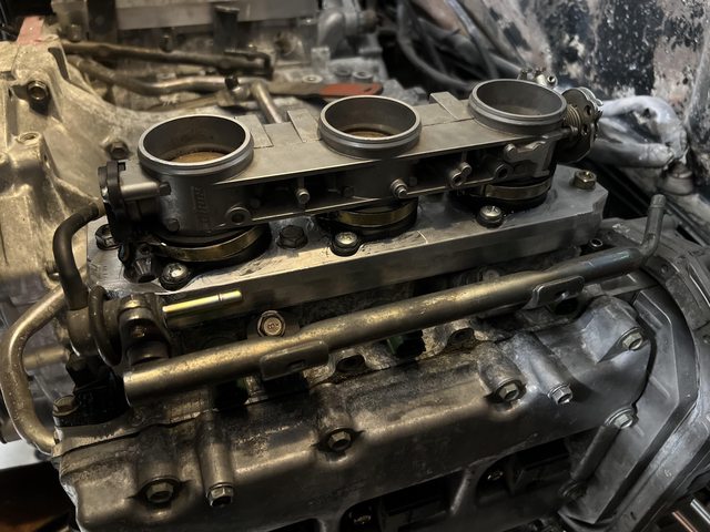

Little update on the home-made manifolds, which are now on the engine.
Many years ago I did a Megasquirt EFI conversion on my 1972 911T (imagine doing that now!) using a single throttle body plenum from a 2.7 engine. During the project, an acquaintance in the UK mentioned how Triumph throttle bodies would make excellent EFI intakes for a flat six motor and that kinda stuck in my mind as something I'd like to try.
I later Megasquirted my 912's 616 engine, using Weber IDF-style throttle bodies and two VW Golf could packs to run a crank-fired twin-plug ignition system. It worked great.
When I got my hands on this Subaru EZ30 engine, there was no question that it was going on Megasquirt, but I assumed I would use the single-throttle body intake. Two other things bothered me about that idea - although the engine fits beautifully in the car, the intake doesn't and I'd have to cut the trunk sheet metal, and the intake is also -really- heavy. Then I remembered the Triumph throttle body idea.

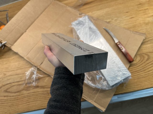

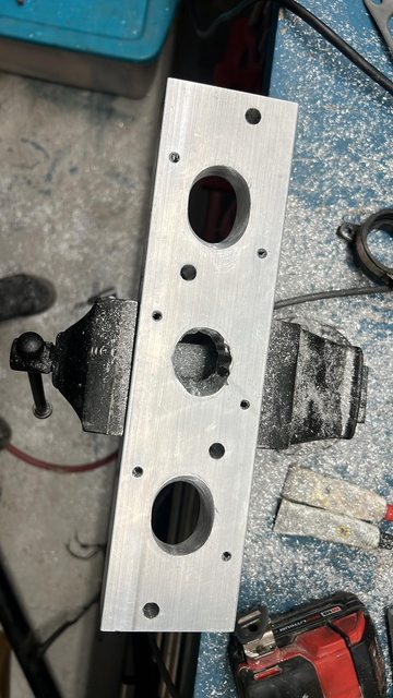

I ordered a pair of throttle bodies from eBay. They're from a Daytona 955i. They have no injector ports (the EZ30 has injector ports in the heads) and the bell cranks are configured for push and pull throttle cables. I'm not sure why you'd need this on a three-cylinder motorcycle, but it's great for me because I can link the two ITBs together for my six-cylinder application.

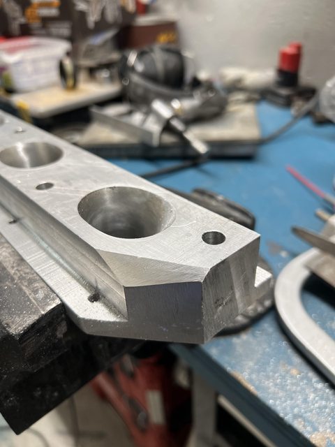

For the manifolds, I investigated various ideas (3D printing etc), but in the end two $36 blocks of 6061 T-6 alu from eBay won out.

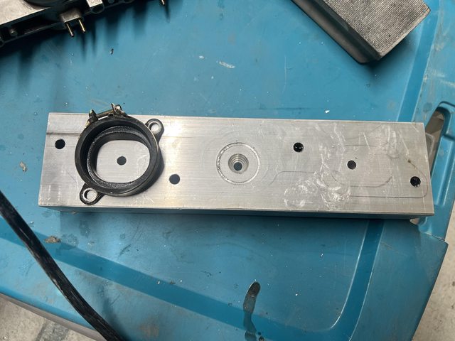

IPB Image

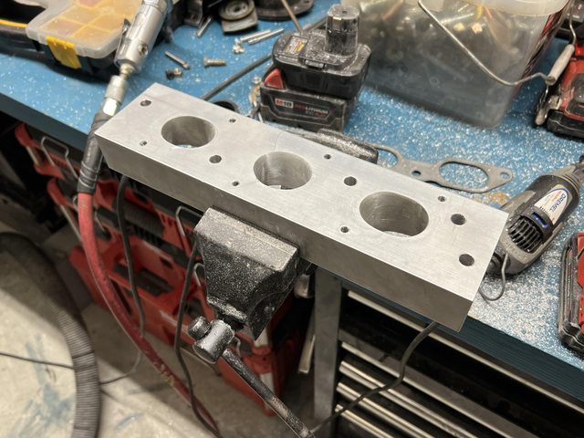

I scored out the intake port spacing on each side...
IPB Image

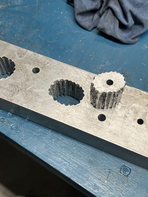

Then I chain-drilled the middle sections of the ports...
IPB Image
... and got to work with a die grinder.
IPB Image
IPB Image

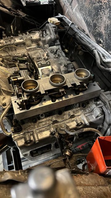

Then I needed to shape the billet blocks to allow clearance for the injectors. My friend Jim did the cutting on his mill.
IPB Image
After that, I had to do a little additional shaping for various engine components that were in the way.
IPB Image

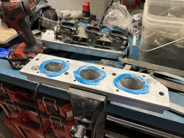

I seated everything with Blue Hylomar, because the Triumph intake boots are kinda old and I'm a pessimist when it comes to intake leaks.
IPB Image
Here's how they fit. Not the most beautiful job, but stout, cheap and maybe 20lbs lighter overall than the stock manifold. They should flow nice - I managed to match the ports from the ITBs through to the head.
IPB Image
