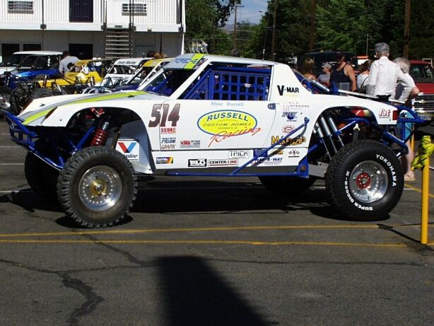

So I'd like to do that. I think the current fanboy terminology is 'Safari' spec, but whatever the semantics, I just want to be able to thrash around in the dirt with my boy, then drive it home.
Spec-wise, I suppose it needs stiffening (to stop the chassis bending in half), a Subaru motor (so I can go nutso without concern for blowing it up), knobbly tires a la Baja Bug, and a roof to keep the sun off.

There was a nice Safari build at SEMA ...
http://www.914world.com/bbs2/index.php?showtopic=356602
IPB Image
