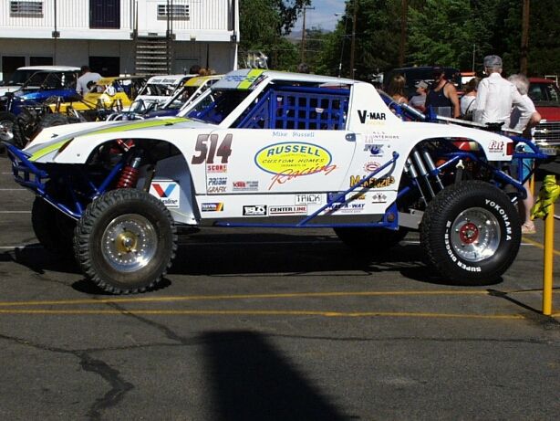

Shivers   Something like this   Nov 8 2021, 05:01 PM
jamlip   Something like this Easy now, that's a bit i...   Nov 8 2021, 05:10 PM
