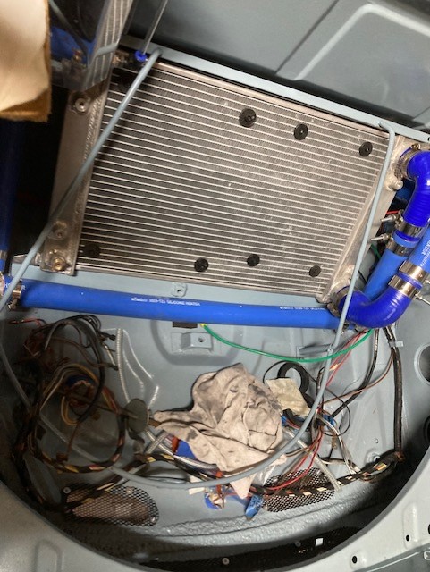

jamlip   Trial-fitted the radiator. I want to try positioni...   Mar 7 2024, 01:10 AM
76-914   Trial-fitted the radiator. I want to try position...   Mar 7 2024, 08:42 AM

slowrodent   In addition to the wheel well holes, has anyone ev...   Mar 7 2024, 09:14 AM
jamlip   Interesting, thank you. Do you have the fenders cu...   Mar 7 2024, 04:52 PM
slowrodent   No.. I just have these as exit holes, and I have o...   Mar 7 2024, 08:10 PM

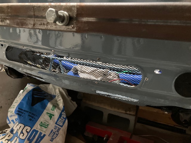

jamlip   Right-o. Any thoughts on this arrangement before I...   Mar 9 2024, 02:11 AM
76-914   Right-o. Any thoughts on this arrangement before ...   Mar 9 2024, 08:12 AM
Lilchopshop   Right-o. Any thoughts on this arrangement before ...   Mar 9 2024, 08:13 AM
slowrodent   Just FYI gents, as Im not trying to hijack... This...   Mar 9 2024, 03:27 PM

jamlip   OK, went ahead with the holes as templated… htt...   Mar 9 2024, 08:59 PM
