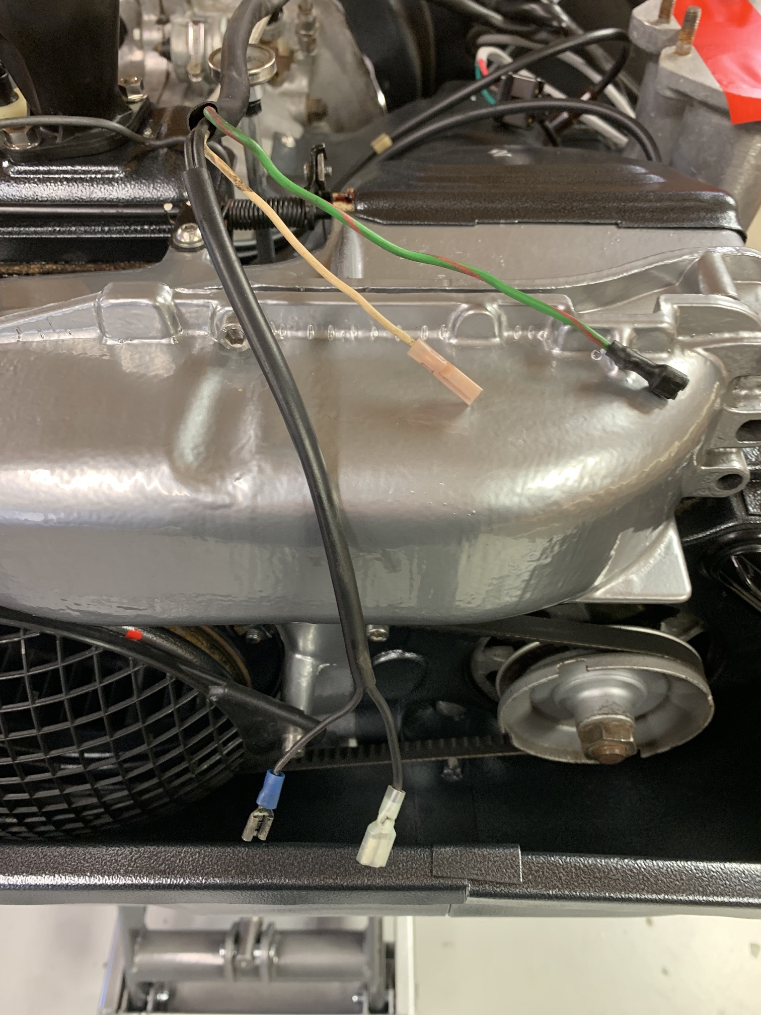

Progress has been slow. Many excuses. But very close to engine installation now. In the pic below, there are 4 wires. This is the "over engine" wiring harness that connects to the relay board with the large(ish) multiplug. Two of them go to the coil (and I even know which side of the coil each goes on), but I am not sure about the other two. One is green and red striped, the other is white. One of them is surely for the oil pressure switch. But, I am not sure which one?

FlacaProductions   Green/red is oil pressure sender idiot light.   Mar 10 2024, 01:36 PM
sdoolin   Green/red is oil pressure sender idiot light. T...   Mar 11 2024, 07:37 AM
