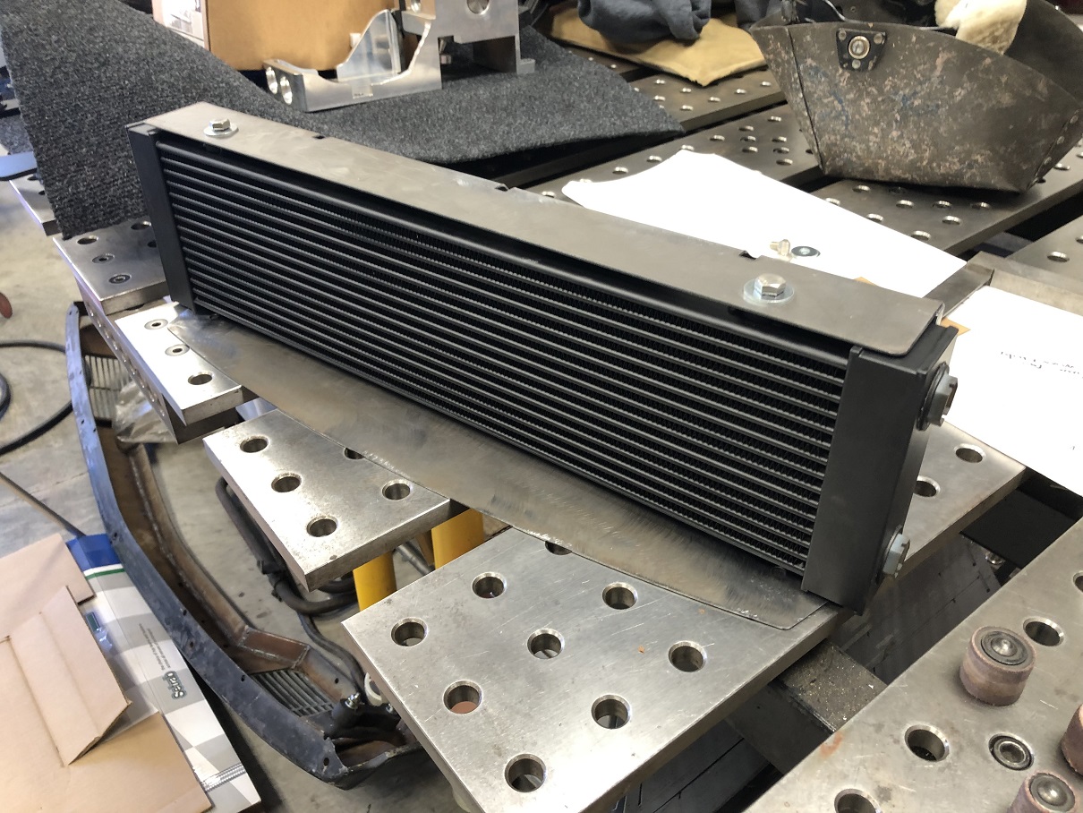

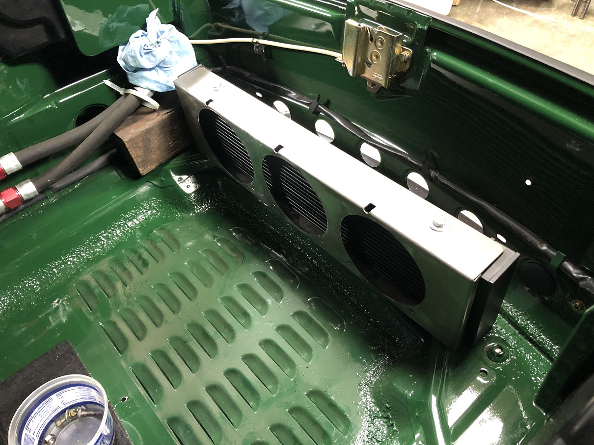

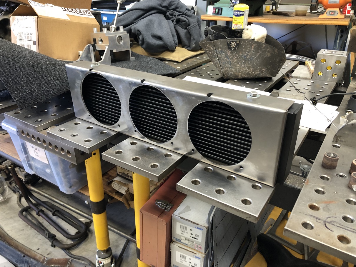

I'm working up a one-piece cooler/fan mount with built in front lower shroud. Typical At The Red Barn approach: Do as good a job as possible on the first attempt but be prepared for a do-over, once I see it in real life.
This design needs a couple mount holes moved and that lower shroud area widened.
Off to fab V2...

tygaboy   Michael opted for a dual-pass Setrab cooler and th...   Mar 5 2024, 11:53 AM
Cairo94507   Parts have arrived- Yay! I know Chris wants t...   Mar 5 2024, 02:49 PM
tygaboy   I'm working up a one-piece cooler/fan mount wi...   Mar 16 2024, 01:19 PM
technicalninja   Looks NICE! I prefer the fans on the cooler v...   Mar 16 2024, 02:59 PM
SirAndy   Not picking nits here but maybe add a few more hol...   Mar 16 2024, 03:36 PM
tygaboy   RE: comments about how the fan mount, clearance to...   Mar 16 2024, 06:39 PM
Cairo94507   Outstanding work Chris; I know this is going to wo...   Mar 17 2024, 06:15 AM
mb911   I am sure it will work great. I am thinking it may...   Mar 17 2024, 06:58 AM
