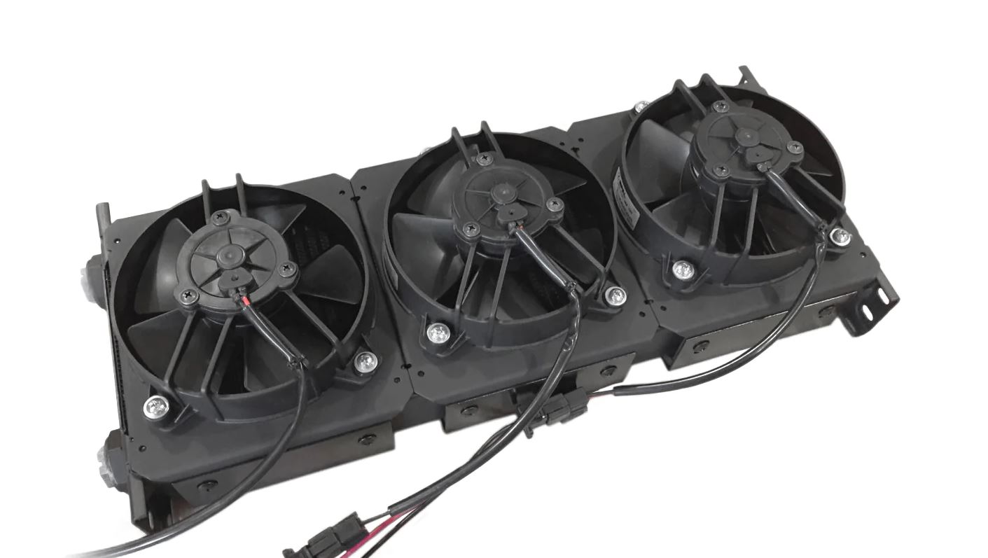

RE: comments about how the fan mount, clearance to the cooler, vents in the mount, etc:
Every pic I can find, and specifically the ones on the Setrab site, show the fans dead against the cooler with no other openings. Note that I spaced Michael's fans back .5".
I'm certainly not saying y'all don't have valid comments. I'm no expert so I'm thinking we'll go with what I've done, test it and if mods are needed, we'll go after them at that point.

tygaboy   Michael opted for a dual-pass Setrab cooler and th...   Mar 5 2024, 11:53 AM

tygaboy   I'm working up a one-piece cooler/fan mount wi...   Mar 16 2024, 01:19 PM
technicalninja   Looks NICE! I prefer the fans on the cooler v...   Mar 16 2024, 02:59 PM
SirAndy   Not picking nits here but maybe add a few more hol...   Mar 16 2024, 03:36 PM
tygaboy   RE: comments about how the fan mount, clearance to...   Mar 16 2024, 06:39 PM
