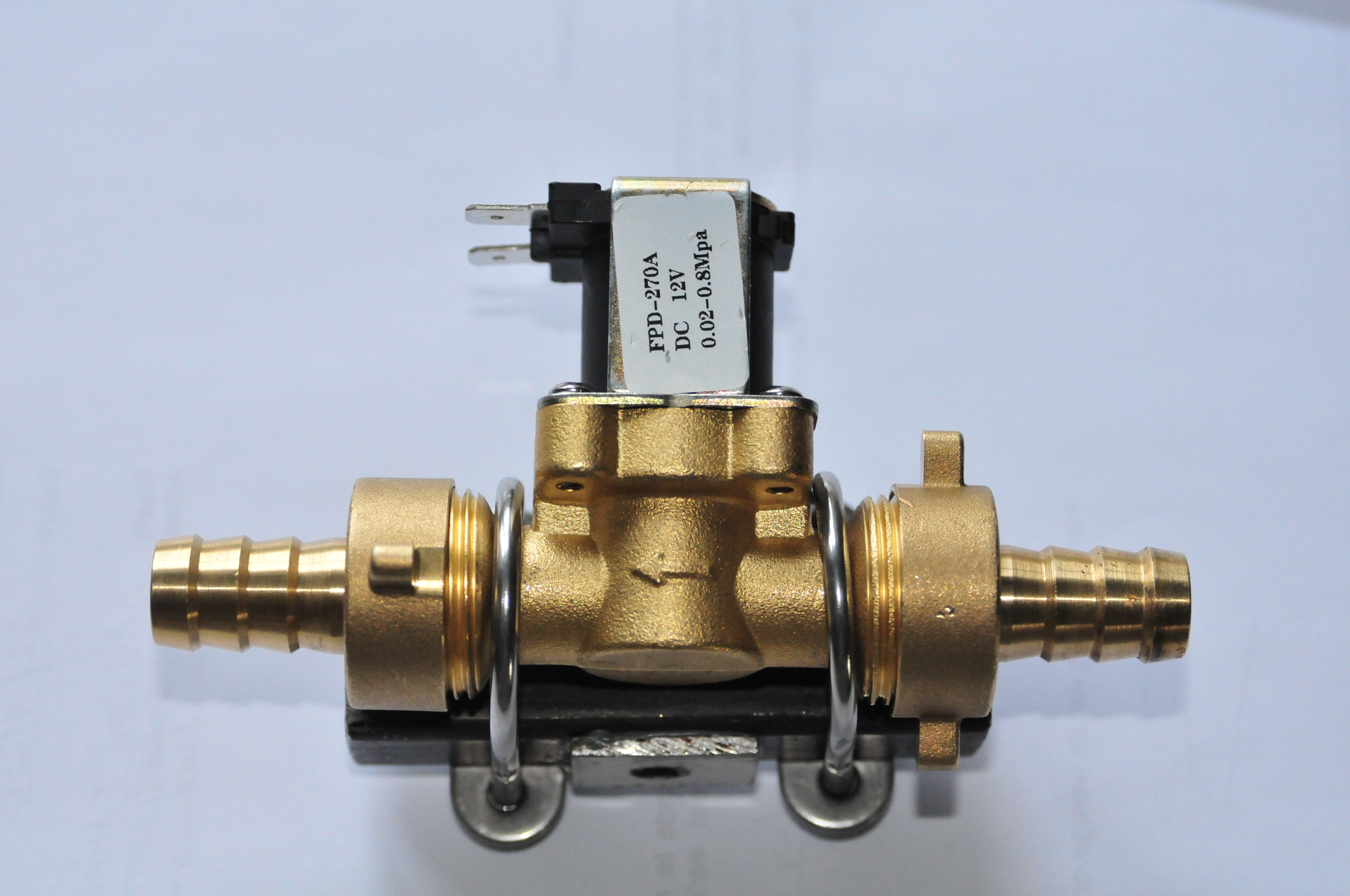

After disassembling the AAR several times, I gave up. Once installed , everything went fine until the next day and then it jammed again. So I constructed a system with a solenoid valve instead of the AAR that I can open or close from the cockpit. I open it when I start the car and after two minutes I close and I have a 1000rpm idle. It's not perfect because it's all or nothing but certainly better than an unreliable AAR.

slotty008   Here it is installed.   Mar 24 2024, 09:25 AM
slotty008   I've put a box on it to protect it. The bottom...   Mar 24 2024, 09:28 AM
slotty008   And this is the knob in the cockpit.   Mar 24 2024, 09:33 AM
emerygt350   And this is the knob in the cockpit. I like it...   Mar 24 2024, 02:59 PM
