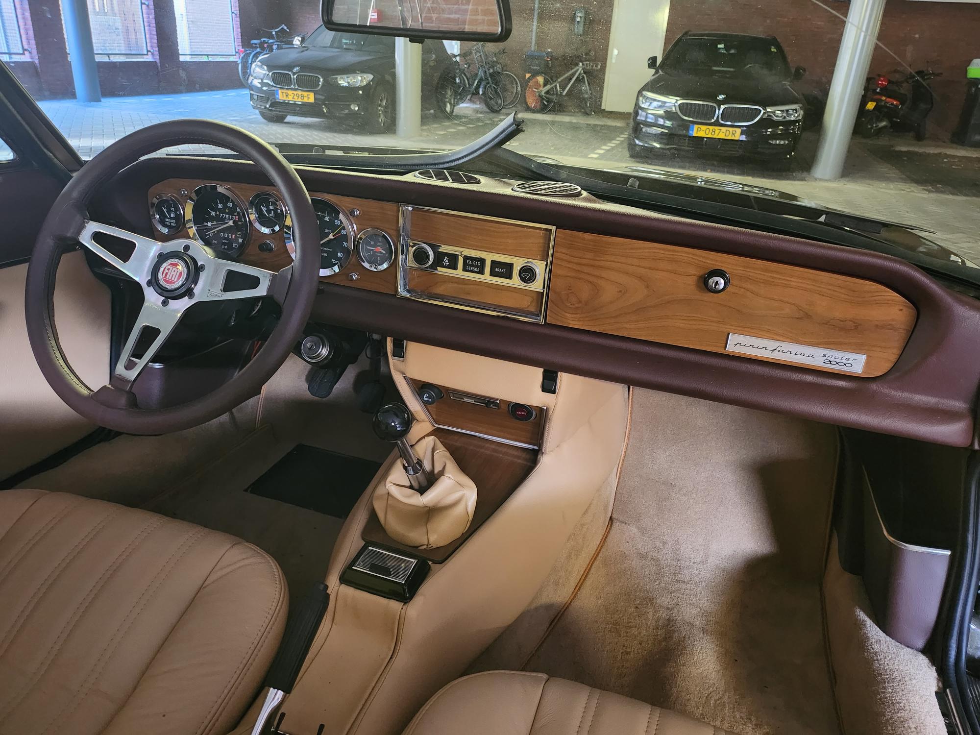

Dash is getting retrimmed in leather with French stitching going all round and down the centre console.
Seats will be covered in original vinyl on the outside. The insides will be soft leather. I just had my Fiat 124 done and its magnificent. See Pic of my 124. Just finished restoration. ( with double the rust the Porsche has ! )
Im not too keen on the basket weave. I would prefer 2 tone. But im going to sit with the upholsterer in June. We will figure out something i like.
Im googling for 914 trim ideas. But its going to be leather. The feel, look and smell just make the difference.
