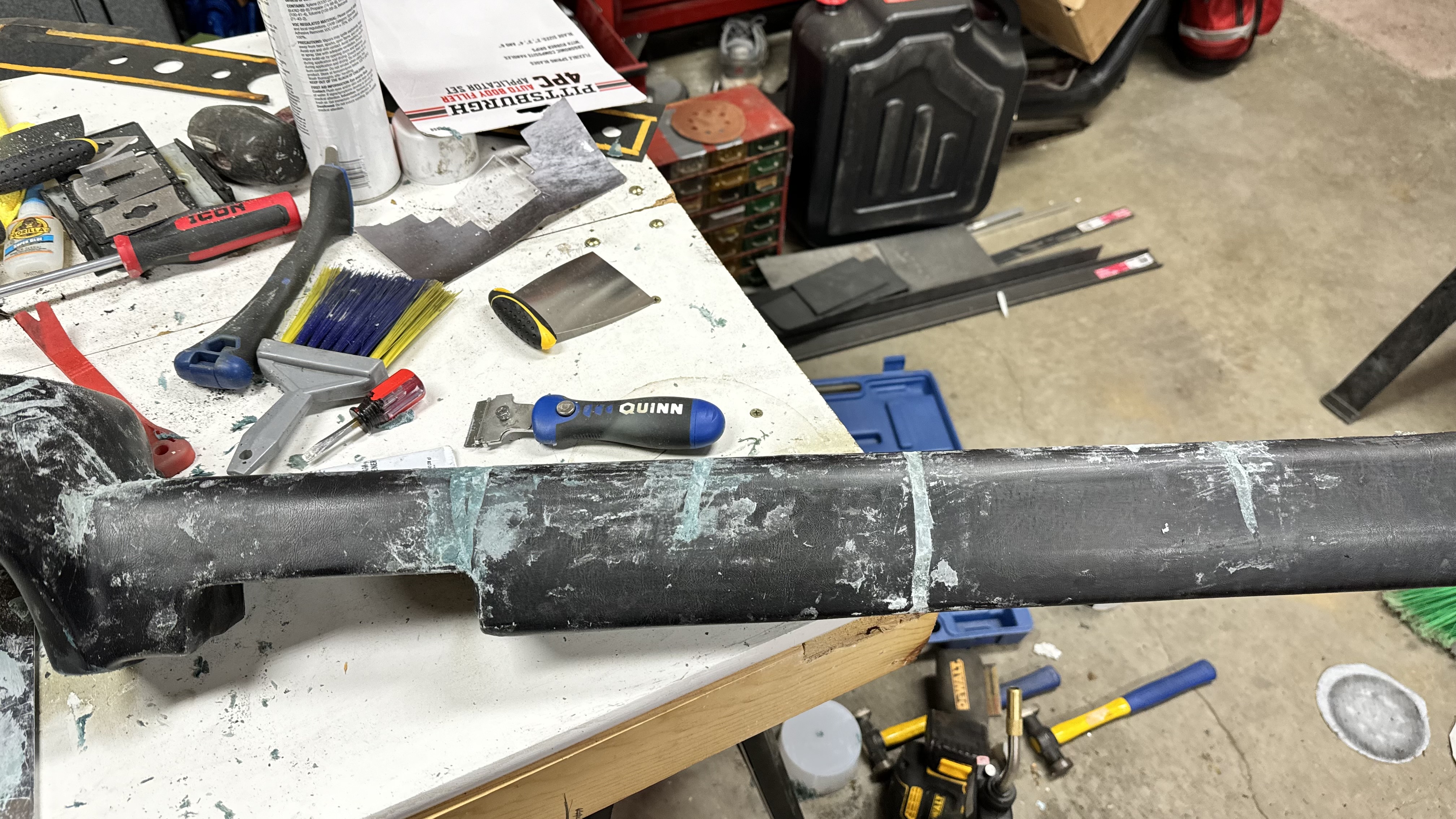

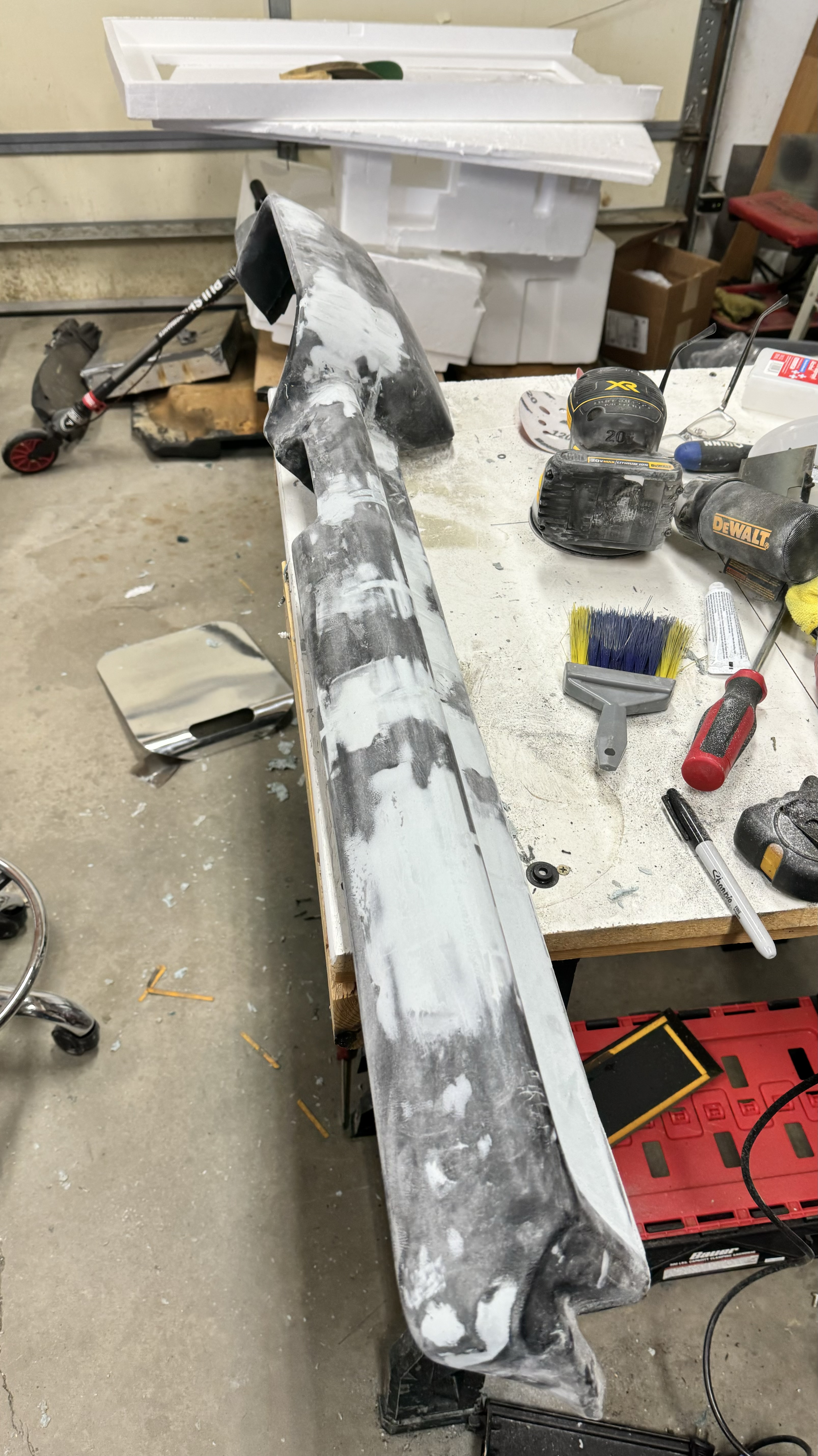

started the process of fixing the dash cracks. Using bondo with fiberglass, then skim coat of regular bondo. will be flocking this weekend. There is a corresponding portion of the metal dash component that will be flockled as well.

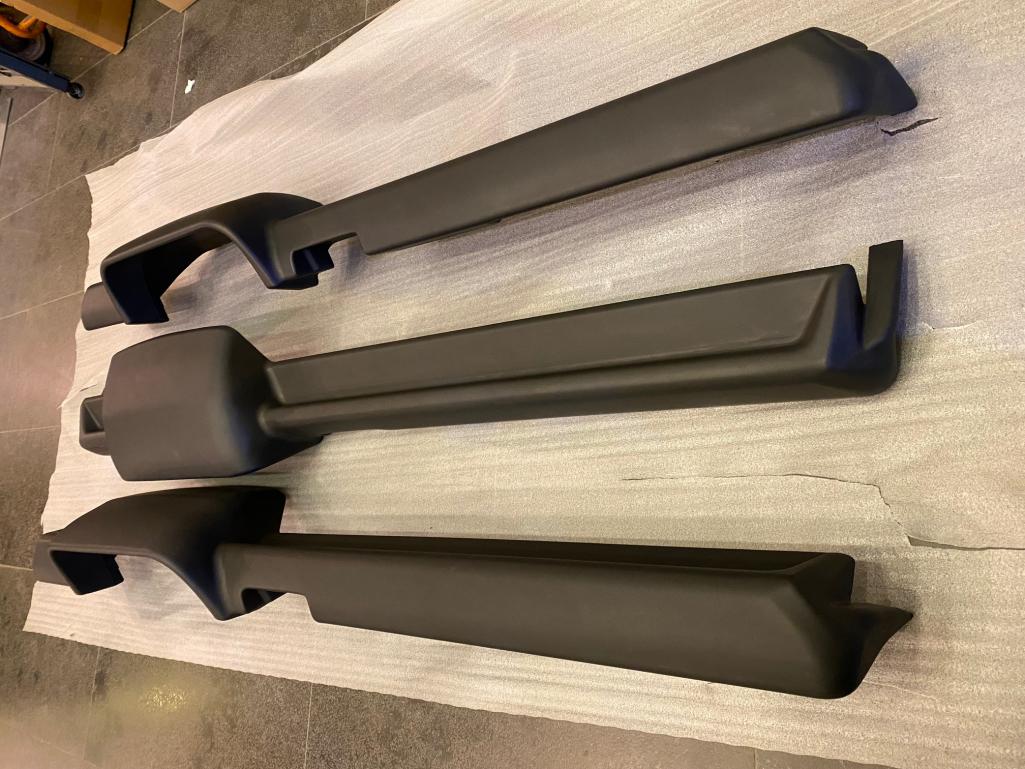

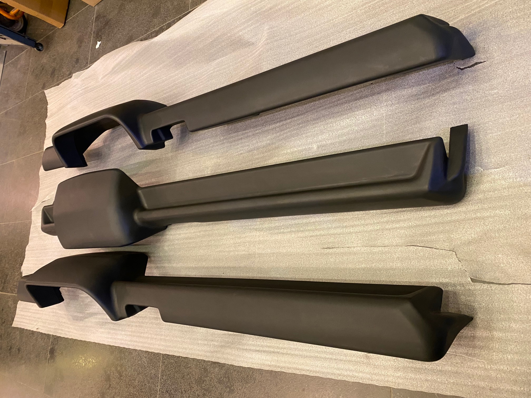

we have plenty of our factory look dashes on the shelf and they are greatAttached Image
drdriddle
post Feb 22 2024, 03:18 PM
Posts: 30
Joined: 16-March 23
From: montana
Member No.: 27,230
QUOTE(dr914@autoatlanta.com @ Feb 22 2024, 10:23 AM) *
They are certainly an option if this doesn't work out the way i hope.
Thank you. So far I'm only in this about $60, including all the flocking supplies, and its a fun project. If it doesn't work then no harm, no foul, nothing lost or ruined. Ill just save up and buy one

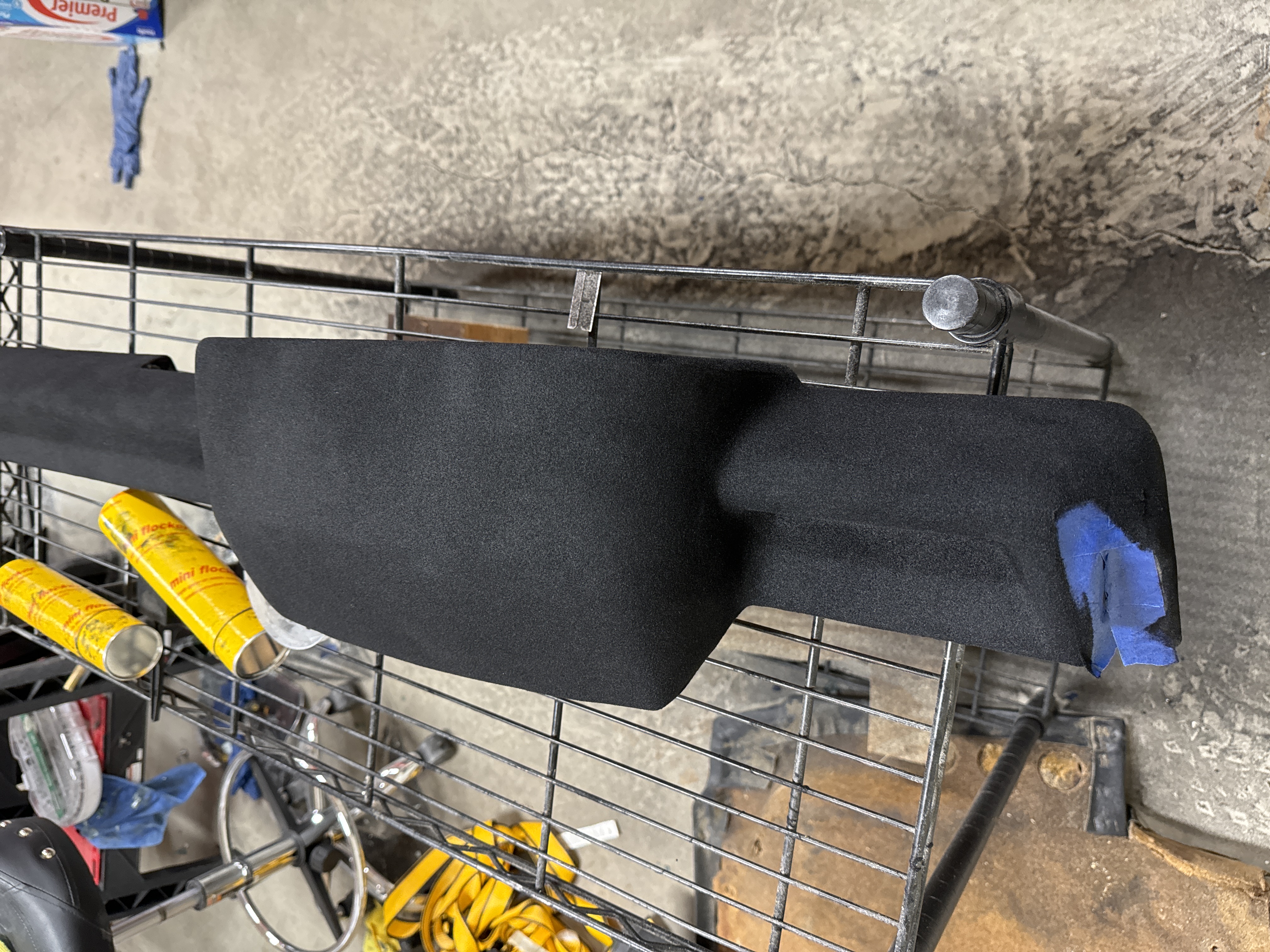

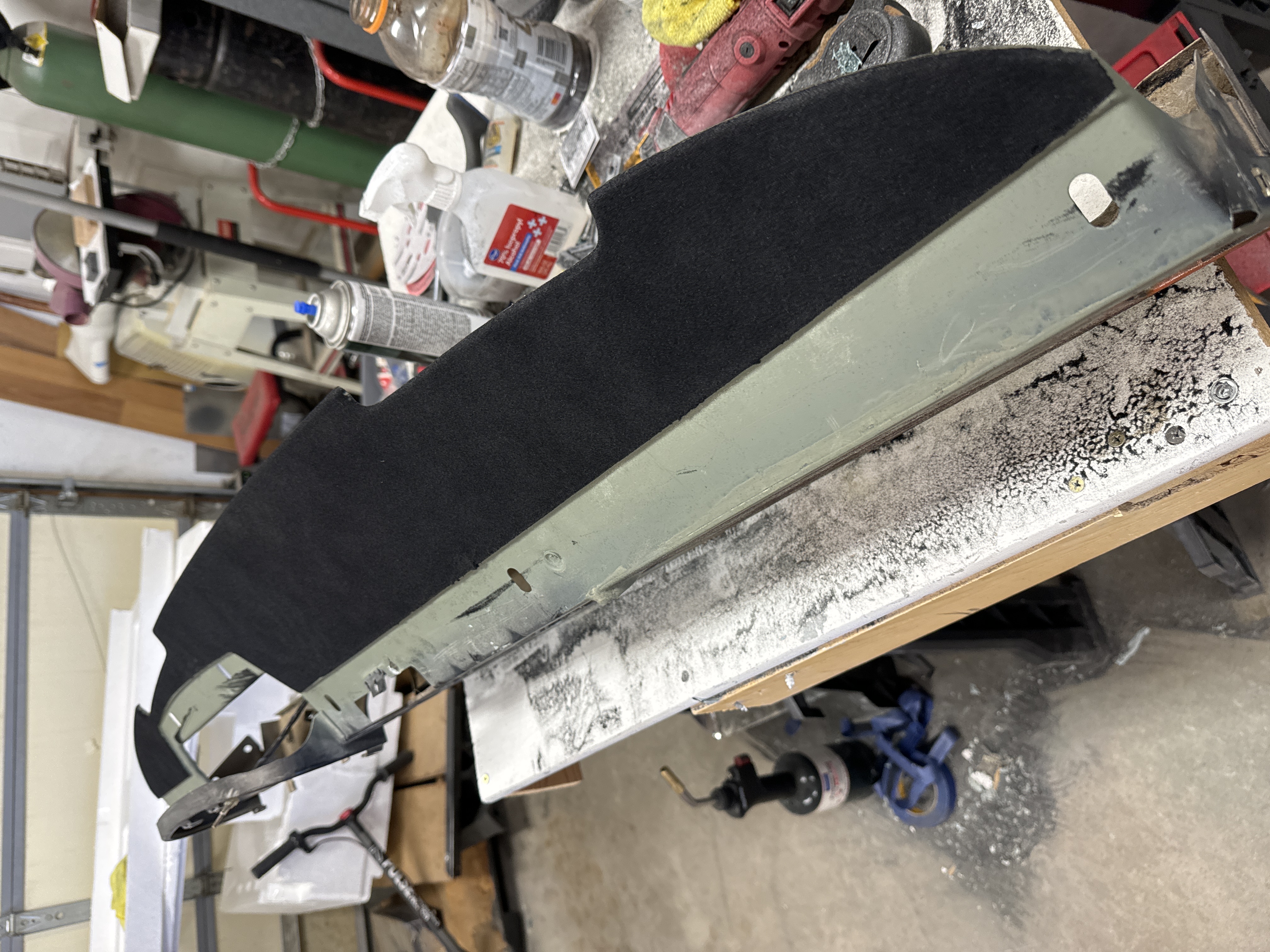

Did the metal part of the dash last night. This is the part where you have stretched vinyl as the original that cracks in the sun and is impossible to replace unless you rip the dash outAttached Image

Also did a glovebox delete. Couldn’t get it to look good with the old door. The dash will end up being orange like the car. Attached Image

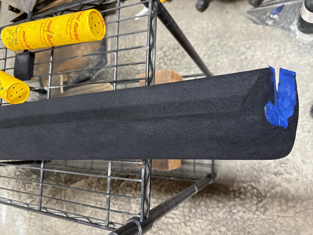

Yes it’s a flocking kit. It’s a brush on self leveling black paint. The flocking is in bags that get transferred to a cardboard flocking tube (two tubes that over lap with holes in one end) that you fill halfway. You brush on the paint, then you have 10-15 minutes to flock the area. Just puff the tubes (really easy motion that any guy is familiar with) and cover the entire area. As the flocking beds down into the paint, you continue to go over the are until liberally covered. Can’t really over cover because what doesn’t get bonded to the paint you lightly blow off after it’s cured. States you need to leave it alone for 15 hours. I did it last night, checked on it after work today, and it’s completly cured and bonded. Running your hand over it feels like running your hand over alcantera. Plus there are a bunch of different colors available. I did black. I did the underside of the binnical where the gauges sit last night to make sure the paint would bond properly to the dash material. And it came out fantastic. I’m going to do the rest of the dash pad this weekend. I’ll post pics when it’s done. If I remember correctly the kit was about $60. I got a second tube to have run loaded and ready in case the first one wasn’t enough. I used about a tube and a half on that amount of dash.

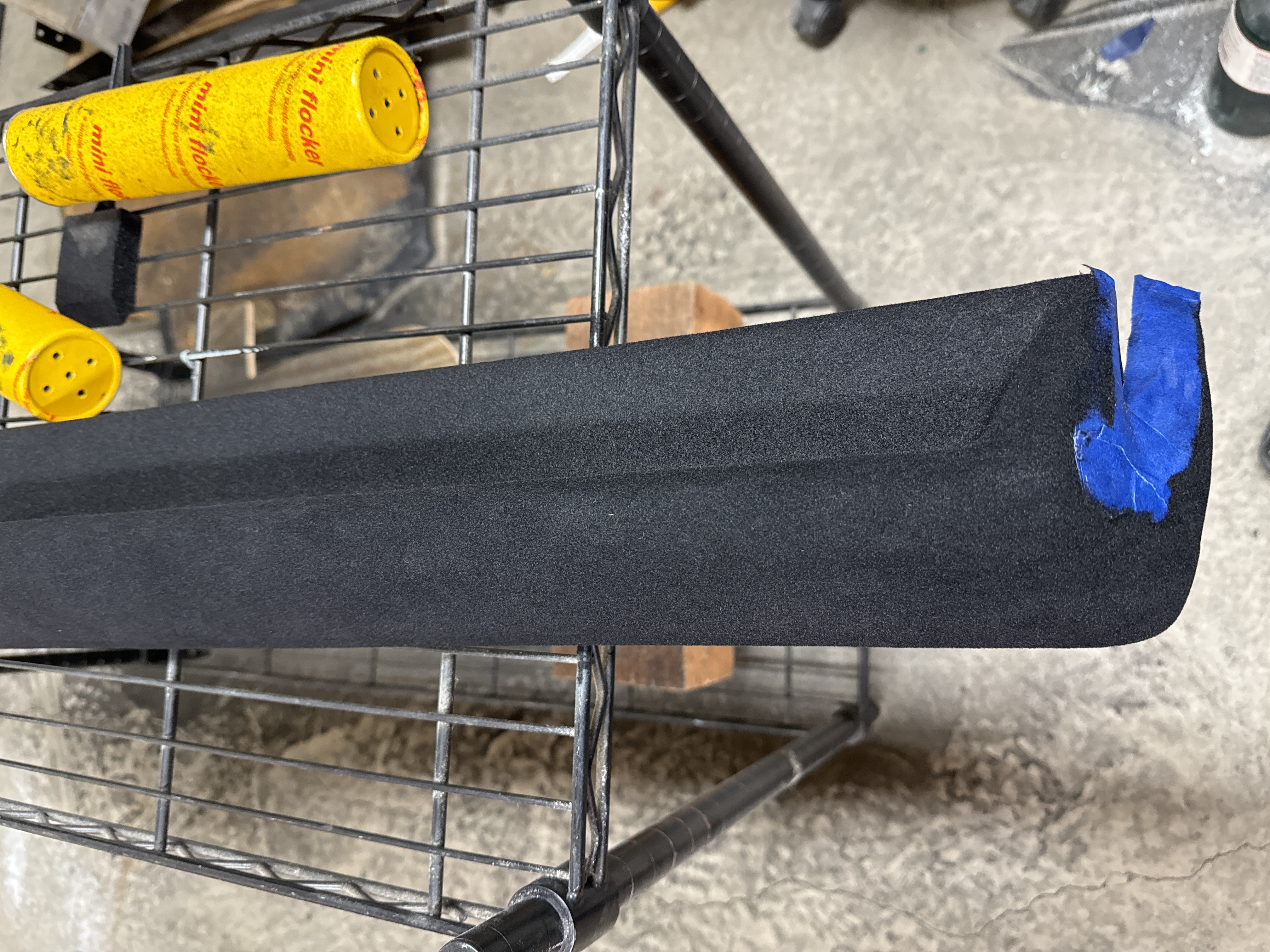

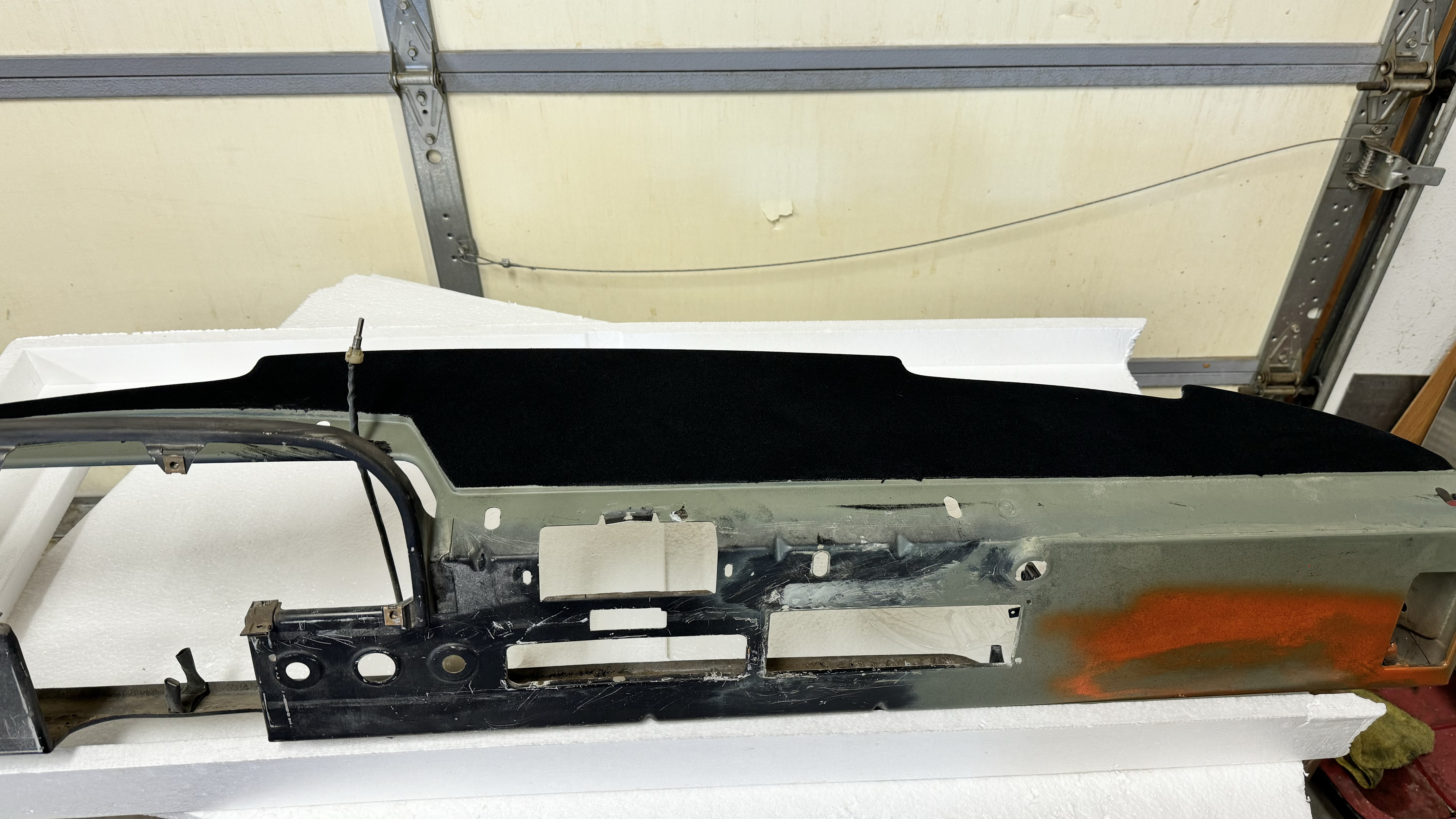

Well here is the dash pad… I think it looks awesome.
