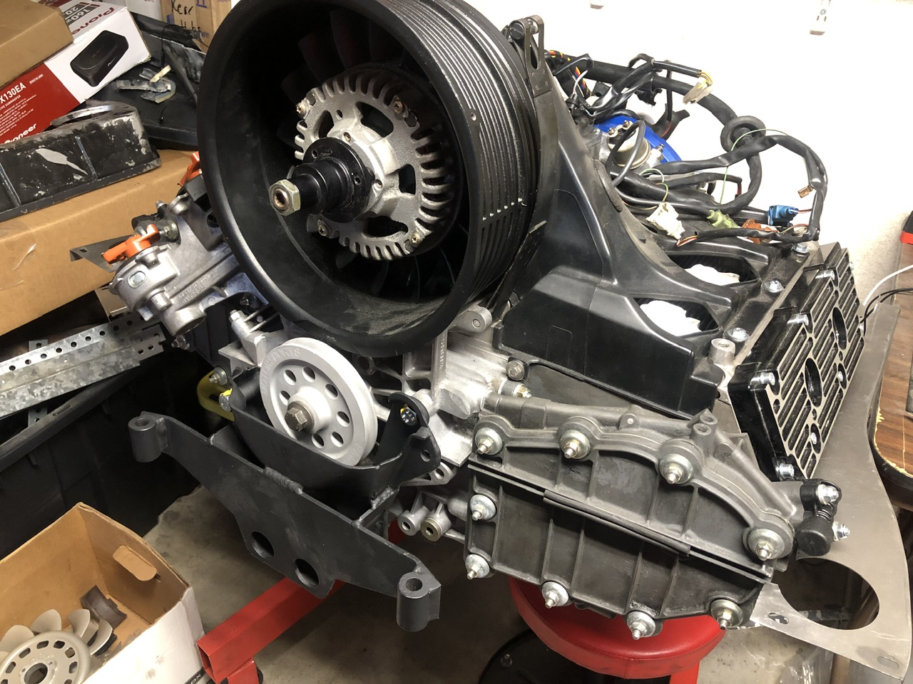

One week at a time. I can’t get to the rear tin with motor on engine stand, so I decided to put motor back together first and then put it on hydraulic table.
One problem at a time. The bottom studs for the motor mount were too short, so I replaced them with bolts like the top. I ended up with Top Right 10x35x1.5. Top left 10x70x1.5 and the bottom 10x55x1.5 and torqued all four to 30 ft-lbs.
The motor mount is a Rich Johnson mount that Otto's installed 25 years ago. I used it on a 2.7 for a couple of years and then on my 3.2 for the last 20+ years.
I used evaporust to clean and remove rust on the hardware. It made some of the hardware look oxidized. I ended up going to ace hardware and replacing all the shroud sheet metal screws. Not factory, but they look great. Factory has the washers permanently on the bolts for a ton more money.
Next is finish up mounting and wiring the alternator and then onto distributor and spark plug wiring and then onto the injection.

QUOTE(Steve @ Mar 26 2024, 11:48 AM) *
Is it the same engine side mount? I thought the mount spacing on the 3.6 engine was different from the 3.2 and older?
The reason I asked is I bought that half from Rich Johnson for my conversion car. And I had to shorten it to get the transmission mounts to line up.
(IMG:http://www.914world.com/bbs2/uploads/post-1143-1564975572.jpg)
We removed 1.25 inches from the U shaped plate between the engine and the arm for the mounts. That got the transmission mounts to line up.
