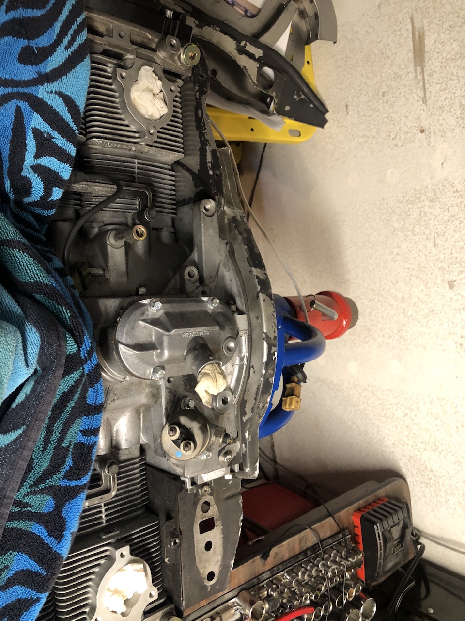

After 23 years of service out of my 3.2, I decided to buy a used 1995 3.6 from LA Dismantler with 110k miles on it. I paid $25k for the motor, Plus an additional $3k from PMS for conversion parts. Got this motor home and two of the cylinders had bad leak down from the exhaust valves. Lots of goofy issues with 3.6 motors. They have an electric smog pump which clogs the SAI passages in the exhaust valves. Sometimes you can turn the engine over with compressed air through the spark plug openings and use a rubber mallet on the exhaust valves to clear it out. This did not work for me, so I sent my motor out to get a top end overhaul, bigger valves and RS Cams.
This will not be an RS spec motor. RS Spec is 3.8 liters, bigger valves, different injection, etc. My motor is just a 1995 993 motor with one size bigger valves, RS cams and steve wong chip. I asked PMS about the 3.8 slip ins and they said their is very little noticeable difference between the two and not worth it unless your changing the P&C's anyway.
LA Dismantler lessons learned:
-Get a warranty in writing
-Do a leak down at their location before buying the motor.
I did neither and they came up with a ton of excuses not to help me.
This is also true for any wrecking yard. My Euro 3.2 also came from a wrecking yard with no warranty, but that motor was flawless.
This will probably be a very slow progress thread. I still work full time and have a family. I bought this motor two years ago and finally pulled the 3.2 a couple of weeks ago. I sold the 3.2 to the guy that did the top end overhaul on my 3.6. On the 3.2, two of the cylinders had poor leak down, due to weak rings. The motor ran great before I pulled it and all the spark plugs looked the same. So I was very surprised about the leak down results. Besides spending $4500 to PMS three years ago to reseal this engine, it has never been apart. The PMS reseal was due to the normal oil leaks around the cam chain housings and other areas. Who knows how many miles were on it. The guy who bought it said the rings are weak and to spray WD40 in the cylinders. Sure enough it brought the leak down, from 30% down to 3% on one cylinder and from 10% down to 5% on the other. He plans on doing a top end overhaul on it and flipping it or putting it in one of his 914's.
I will add pictures and more info as time goes on.

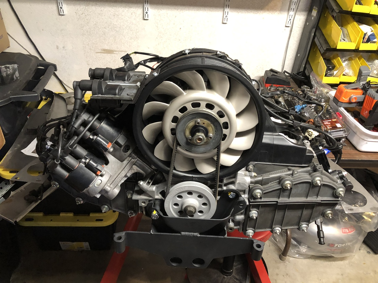

Old Euro 3.2 motor
Used 3.6 motor
Steve

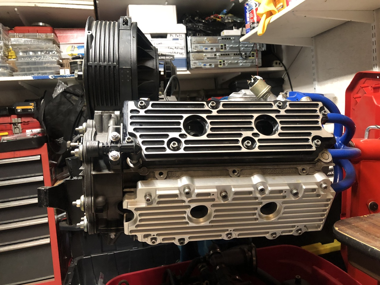

Got stripped motor back from the top end overhaul. First thing I noticed so far was two stripped exhaust valve cover screws. I was going to install a couple helicoils, but I was able to clean the threads with a metric tap and dye set and use slightly longer 6x35 Allen screws versus stock 6x30. I don’t know why they went to smaller Allen screws on the 3.6. They are very easy to strip. Only 7 lbs of torque. I also installed Rennline valve covers. I had to grind down the top one to clear the oil line.

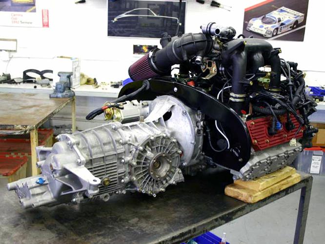

This is a 993 converted to 3.8, RS cams, big valves, ect.

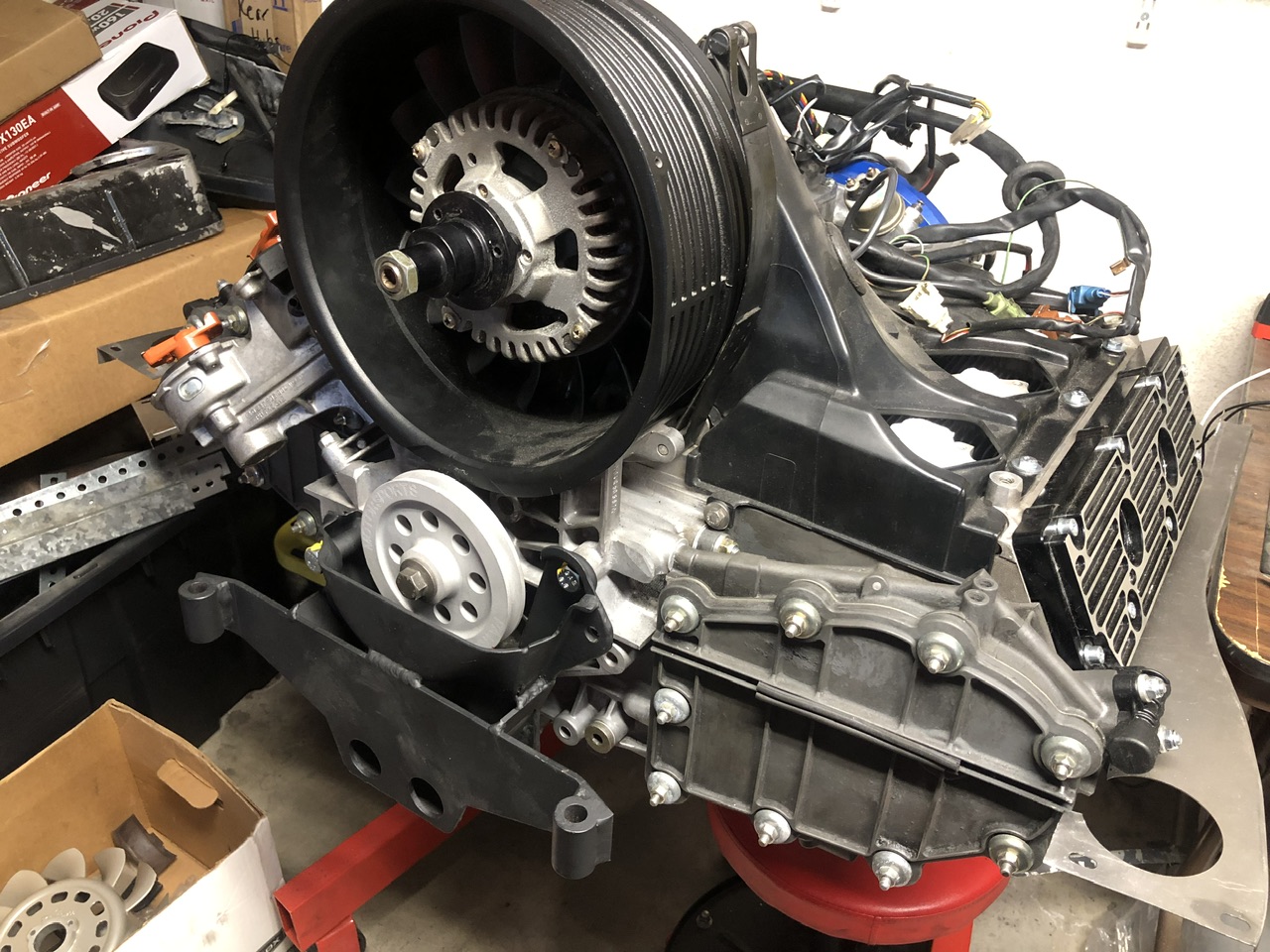

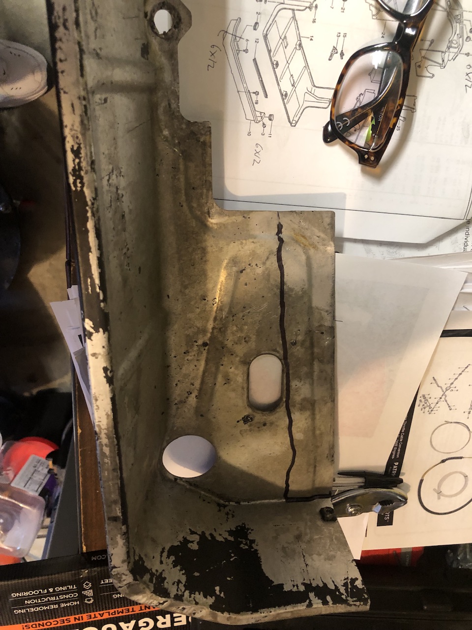

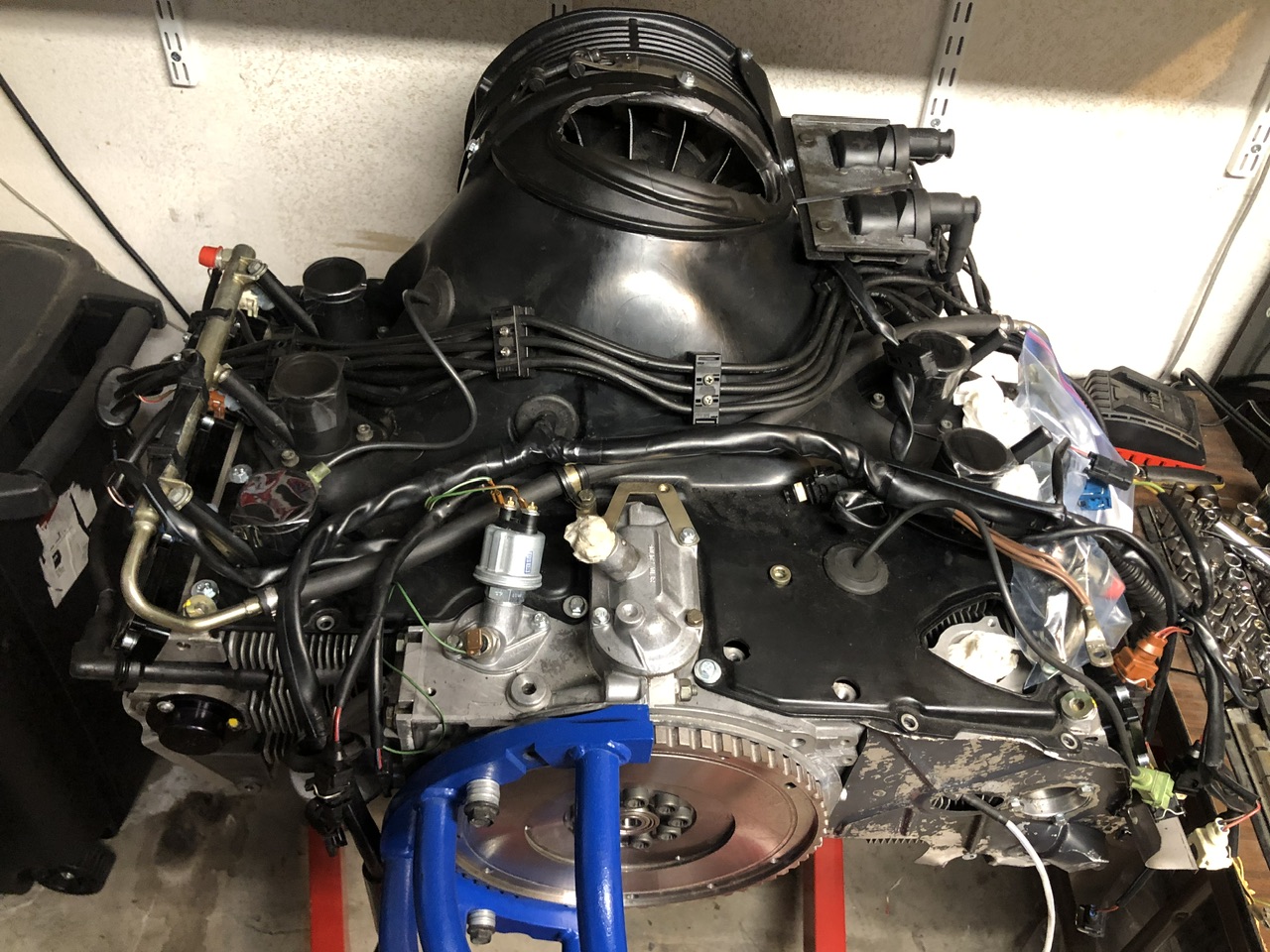

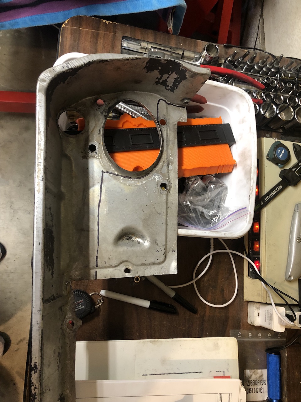

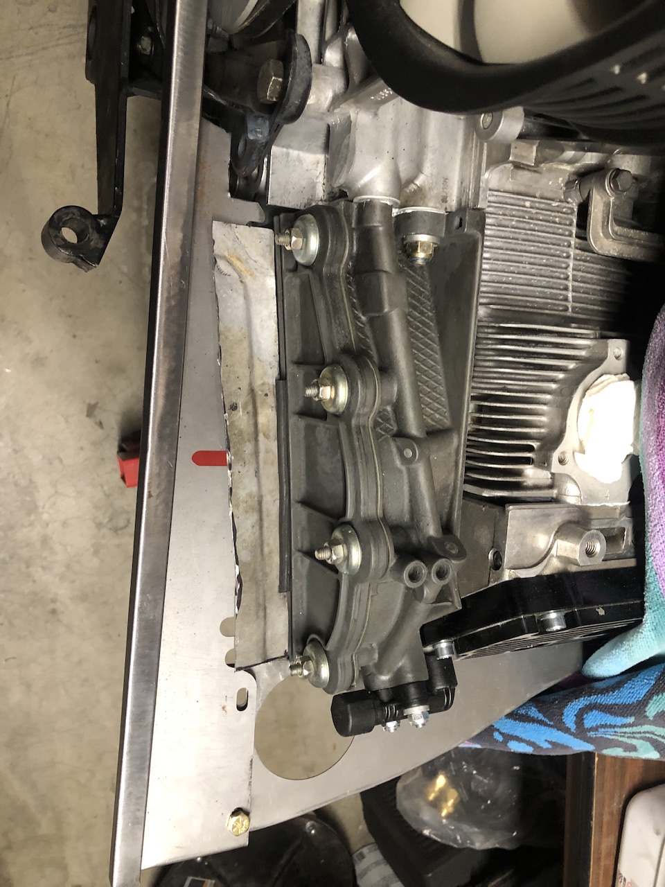

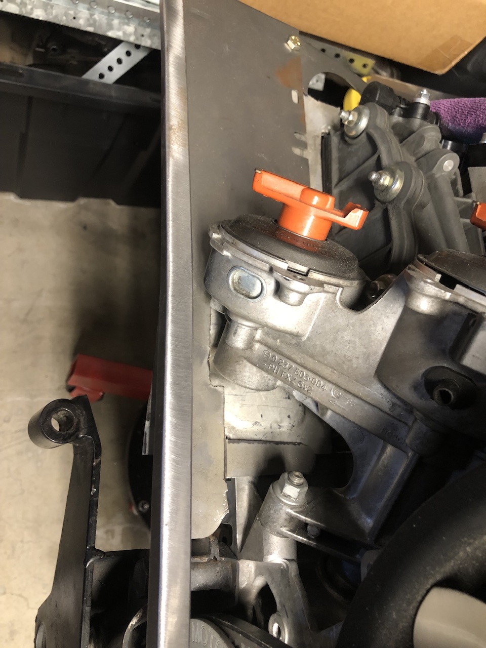

I trimmed the MB911 tin to fit my 3.6 and cut pieces off the 3.6 tin to fill the gaps. Note the indentation for the 12 plug distributer from the stock tin. Next steps is to either weld the pieces together or use rivets. I cut the top off the rear 3.6 tin but I will need to get the motor off the engine stand to make it all fit.
Next steps:
-Wire up alternator
-Put Fuel Injection back on
-Install Clutch
-Take motor off of engine stand and put on hydraulic table, so I can install the rear tin and mate the 916 gear box.
-Clean up engine compartment and install 3.6 wiring harness, ECU, etc.
-Install drive train.

@cairo94507 Michael, I'm surprised you don't let the red barn cut and paste/weld the tin together. To do it right I envision welding the MB911 tin to the 993 tin in the front and back. Using plug welds, seam welds and scab plates. My welding skills are crap, but you can't really see the tin once the motor is in the car. I will also send it out and get the Frankenstein mess powder coated when done.
Cairo94507
@Steve Hi Steve - I have a set of the 993 tins and a new set of Ben's 914-6 tins. We will fit them and weld as needed- do some light bodywork then powder coat satin black. Should look good. beerchug.gif
Steve
QUOTE(Cairo94507 @ Mar 18 2024, 08:07 AM) *
Facing the motor, I should of cut more out of the 993 tin on the right side, to cover some of the MB911 holes and slots. Old Saying... Measure twice, cut once!!
Same thing with the rear... I should of left the 993 tin one piece and just cut off the top. Then cut off enough of the bottom of the MB911 tin to match the 993 tin, then make it two pieces.
I also plan on cutting the front piece of the tin in half, so I can easily remove it when removing or installing the engine. With the front tin in place, its hard to get to the Rich Johnson mount top bolts and his mount hangs up on the front tin. I don't know if the stock six mount has this problem.
Cairo94507
@Steve - Good to know- we shall see how it works out- soon I hope. beerchug.gif

One week at a time. I can’t get to the rear tin with motor on engine stand, so I decided to put motor back together first and then put it on hydraulic table.
One problem at a time. The bottom studs for the motor mount were too short, so I replaced them with bolts like the top. I ended up with Top Right 10x35x1.5. Top left 10x70x1.5 and the bottom 10x55x1.5 and torqued all four to 30 ft-lbs.
The motor mount is a Rich Johnson mount that Otto's installed 25 years ago. I used it on a 2.7 for a couple of years and then on my 3.2 for the last 20+ years.
I used evaporust to clean and remove rust on the hardware. It made some of the hardware look oxidized. I ended up going to ace hardware and replacing all the shroud sheet metal screws. Not factory, but they look great. Factory has the washers permanently on the bolts for a ton more money.
Next is finish up mounting and wiring the alternator and then onto distributor and spark plug wiring and then onto the injection.

Slowly but surely. Wired up Alternator and mounted fan, housing, etc. Also connected up the spark plugs and coils with PMS mount. Next steps fuel injection and wiring harness. So dumb.. I should have labeled all of the plugs, but I did take lots of pictures and I have the factory manuals and parts diagrams.
Cairo94507
QUOTE(Steve @ Apr 1 2024, 08:32 AM) *
... Also connected up the spark plugs and coils with PMS mount ...
Pro tip, if you mount the coils upside down on that mount, the center plug wires aren't such a tight fit.
IPB Image
Steve

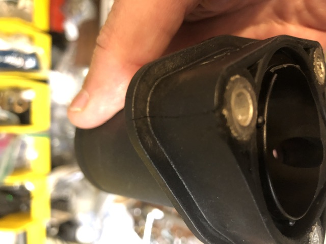

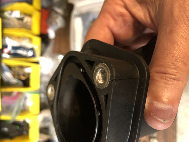

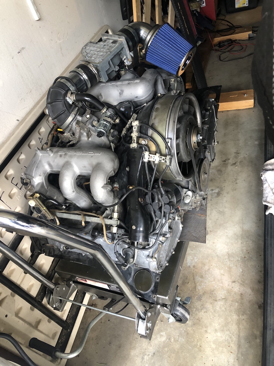

Not much progress. Caught Covid, dog ate my homework, etc.
I did get the injectors installed on one side and then I noticed cracks in the plastic intake manifolds. I ordered six more. I had the injectors cleaned and tested. I also somehow lost or misplaced the 9 pressure plate bolts and some of the intake screws, so I also had to order that stuff. Little by little..
