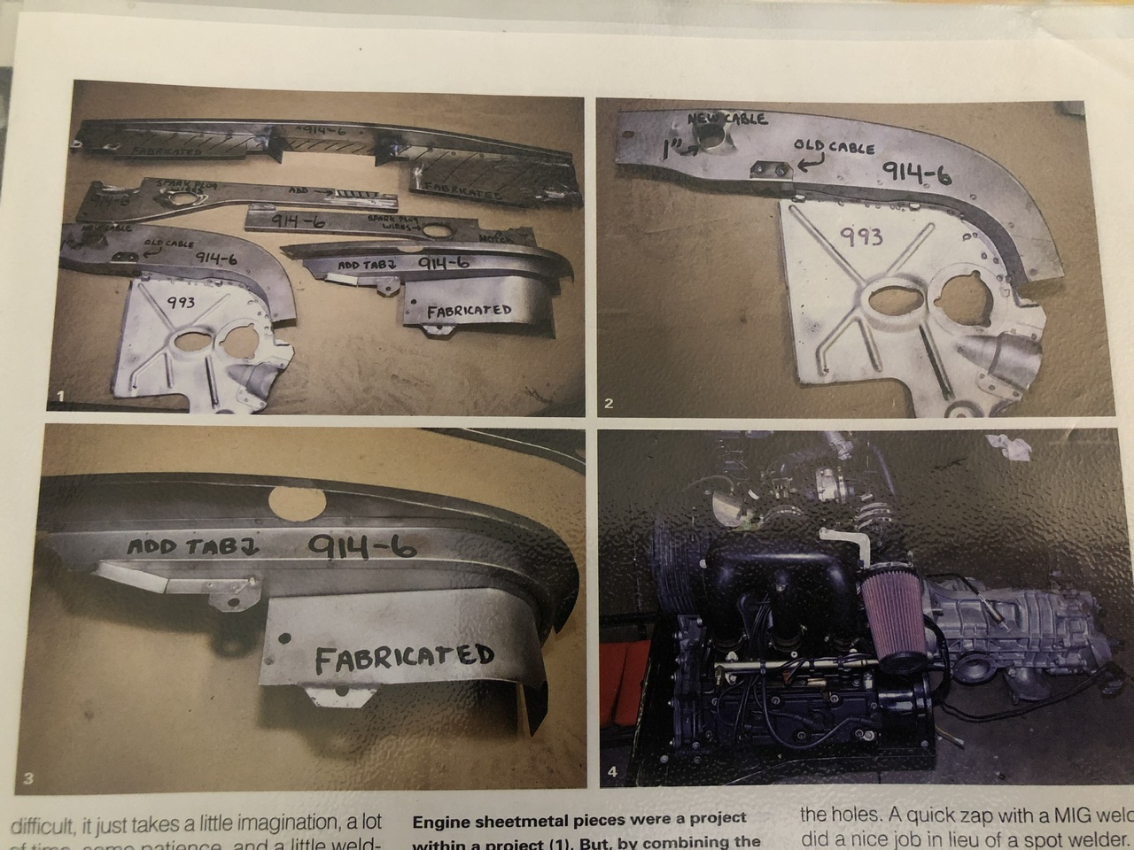

I trimmed the MB911 tin to fit my 3.6 and cut pieces off the 3.6 tin to fill the gaps. Note the indentation for the 12 plug distributer from the stock tin. Next steps is to either weld the pieces together or use rivets. I cut the top off the rear 3.6 tin but I will need to get the motor off the engine stand to make it all fit.
Next steps:
-Wire up alternator
-Put Fuel Injection back on
-Install Clutch
-Take motor off of engine stand and put on hydraulic table, so I can install the rear tin and mate the 916 gear box.
-Clean up engine compartment and install 3.6 wiring harness, ECU, etc.

Cairo94507   @Steve - Hi Steve, Very glad to see you moving fo...   Mar 18 2024, 06:27 AM
Steve   @[url=http://www.914world.com/bbs2/index.php?show...   Mar 18 2024, 08:45 AM
Cairo94507   @Steve Hi Steve - I have a set of the 993 tins a...   Mar 18 2024, 09:07 AM
Steve   [b]@[url=http://www.914world.com/bbs2/index.php?s...   Mar 18 2024, 09:30 AM
Cairo94507   @Steve - Good to know- we shall see how it works ...   Mar 18 2024, 09:34 AM
ClayPerrine   I did the same thing when installing my 4.0 motor....   Mar 20 2024, 02:18 PM
Steve   One week at a time. I can’t get to the rear tin...   Mar 26 2024, 10:48 AM
ClayPerrine   The motor mount is a Rich Johnson mount that Otto...   Mar 27 2024, 03:21 PM

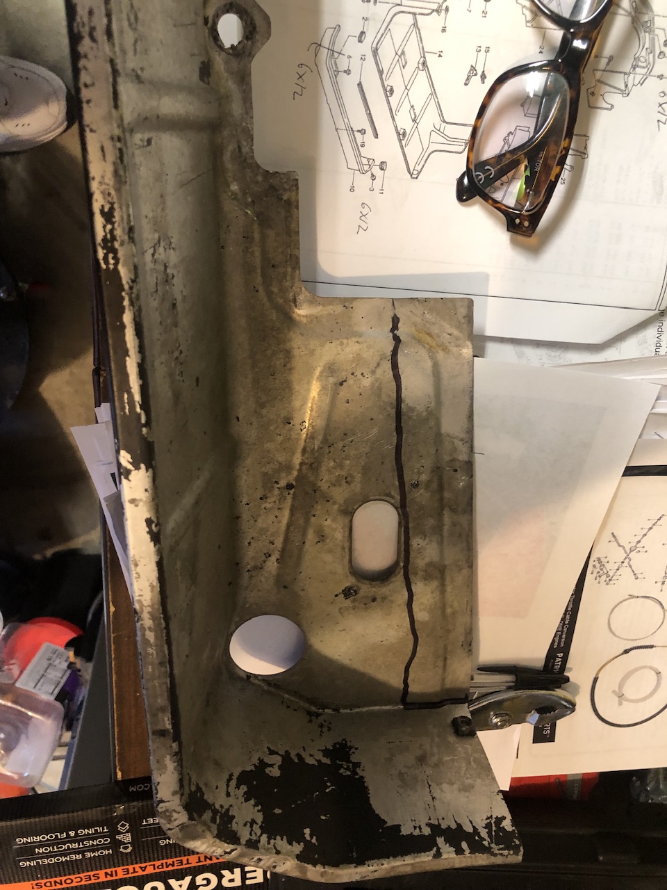

Steve   Not much progress. Caught Covid, dog ate my homew...   Apr 22 2024, 12:17 PM
mepstein   They always crack. Luckily they are pretty cheap.   Apr 22 2024, 12:33 PM
