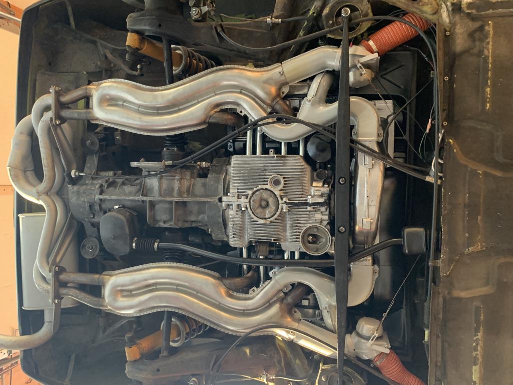

Rebuilt my 2.0 back in 2016. Full "Raby Spec" 2056. Runs very well. It is out of the car right now as I am dealing with a rusty battery tray (separate thread on that). It appears that I have leaks at most/all of the pushrod tube seals, the valve cover seals, and the rear main seal. This is not a surprise to me, I clean the bottom of the engine regularly, and knew this day was coming
Pretty sure I used the Victor Reinz gasket set that came with my engine "kit" from the Type IV Store. I used the cork valve cover seals from the Victor Reinz set. I did not use any RTV anywhere. Hate the stuff. I know I used a rear main seal from GoWesty as someone back then had suggested it is a better part then what is included with the Victor Reinz set.
I installed new pushrod tubes and used the O-Rings from the Victor Reinz set.
Does anyone really have an oil tight VW Type IV engine? If yes, how does none do that?

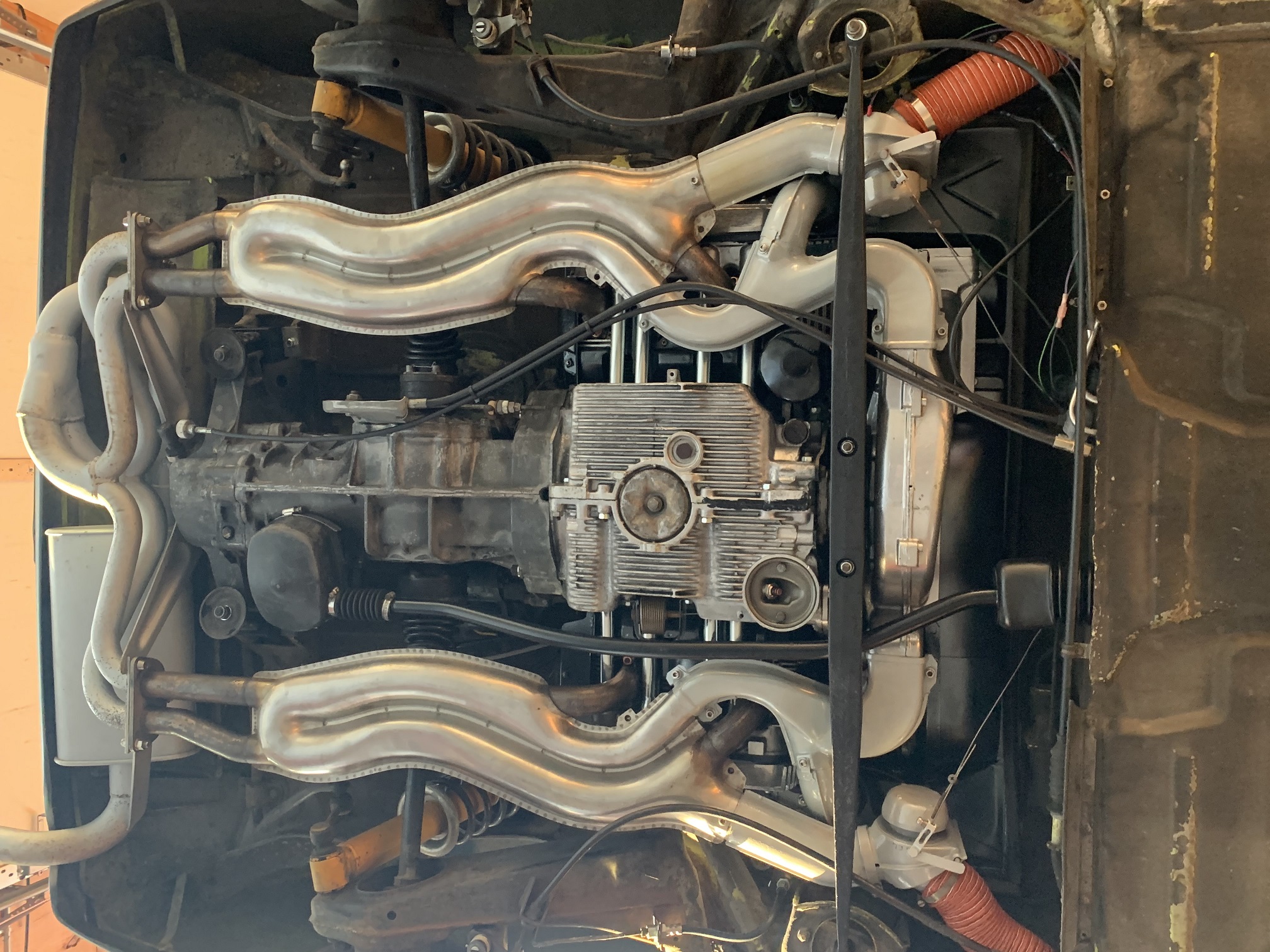

Loosened everything up, removed the heater ducts and flappers and wala - muffler went on easily. I'm sure I had to do the same thing last time around, but obviously have forgotten. Now everything on the underside of the car is buttoned up except for a bit of wiring. Next I move to the topside to re-install fuel lines and carbs. Hoping it is a runner again sometime this weekend.

sdoolin   Loosened everything up, removed the heater ducts a...   Mar 29 2024, 07:22 AM
GBX0073   Great Picture Looking good !   Mar 29 2024, 08:30 AM
technicalninja   :agree: :agree: :agree: Nice and clean! M...   Mar 29 2024, 09:36 AM
sdoolin   Thanks for the compliments in the cleanliness. But...   Mar 30 2024, 07:52 AM
technicalninja   Post a pic of your leak point please. Really stra...   Mar 30 2024, 08:39 AM
technicalninja   You're going to need a mirror with all the stu...   Mar 30 2024, 08:52 AM
sdoolin   Pic below. Hard to get a good picture but you can ...   Mar 30 2024, 09:27 AM
technicalninja   I'd first clean all the oil with B12 carb spra...   Mar 30 2024, 10:05 AM
