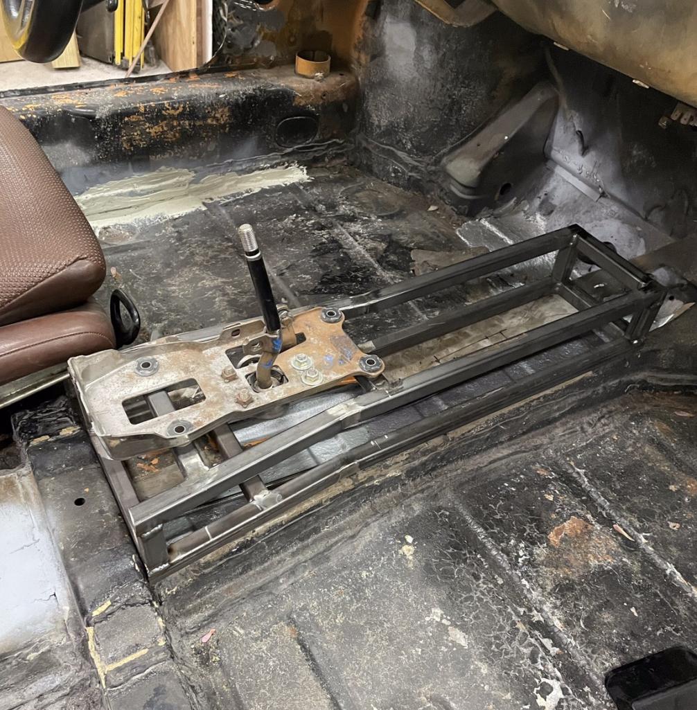

I have this square tube framework I made but decided not to use. It already has the mount points for the MR2 shifter. I’d be willing to let it go to a good cause.

Really appreciate it but we're on opposite coasts and it's so easy just to make one.

East coaster   I have this square tube framework I made but decid...   Mar 27 2024, 07:21 PM
jamlip   Really appreciate it but we're on opposite coa...   Mar 29 2024, 02:40 PM
East coaster   Really appreciate it but we're on opposite co...   Mar 29 2024, 03:51 PM
