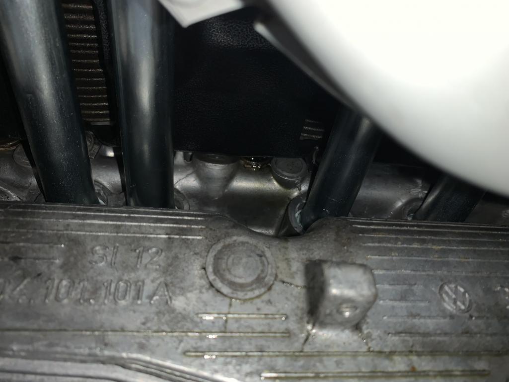

Pic below. Hard to get a good picture but you can see (well, I can see) the leak at the center bolt between the 2 push rod tubes. It is "shiny" with oil at that bolt, and there is a washer behind the bolt head.
Agree Ninja, this seems as if it is above what the oil level would be in the sump. Which is both confusing and frustrating.
For sure the engine has to come out. But not sure (yet) if I gotta split the cases.

technicalninja   Post a pic of your leak point please. Really stra...   Mar 30 2024, 08:39 AM
technicalninja   You're going to need a mirror with all the stu...   Mar 30 2024, 08:52 AM
sdoolin   Pic below. Hard to get a good picture but you can ...   Mar 30 2024, 09:27 AM
technicalninja   I'd first clean all the oil with B12 carb spra...   Mar 30 2024, 10:05 AM
technicalninja   You're running carbs... My 75 came with a bra...   Mar 30 2024, 10:42 AM
