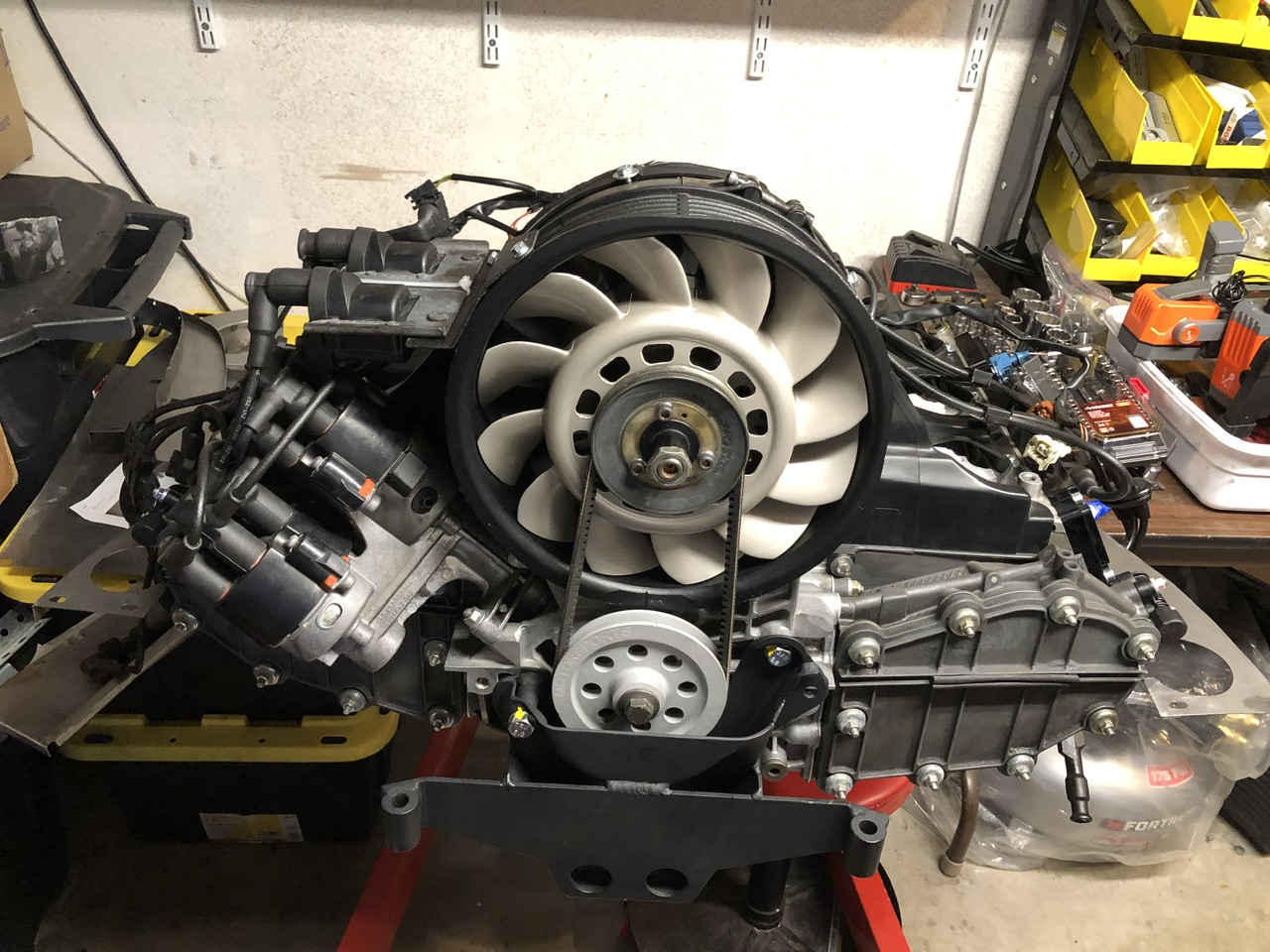

Slowly but surely. Wired up Alternator and mounted fan, housing, etc. Also connected up the spark plugs and coils with PMS mount. Next steps fuel injection and wiring harness. So dumb.. I should have labeled all of the plugs, but I did take lots of pictures and I have the factory manuals and parts diagrams.

QUOTE(Steve @ Apr 1 2024, 08:32 AM) *
... Also connected up the spark plugs and coils with PMS mount ...
Pro tip, if you mount the coils upside down on that mount, the center plug wires aren't such a tight fit.

QUOTE(SirAndy @ Apr 1 2024, 10:38 AM) *
(IMG:http://www.914world.com/bbs2/uploads/post-179-1182814103.jpg)
Thanks @SirAndy !! (IMG:style_emoticons/default/beerchug.gif) I will flip it tonight. I was just following the pictures on the PMS Web Site. They do reach, but they are tight. Probably not good on the wires with motor vibrations.
