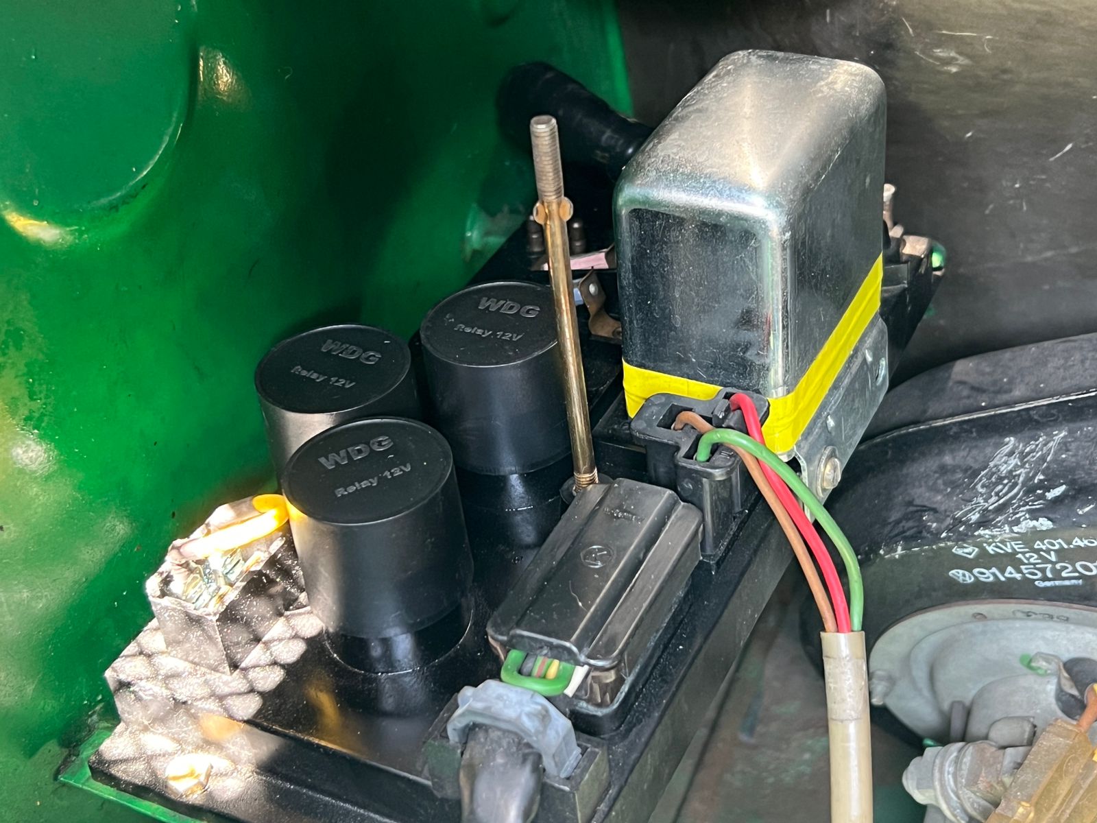

stoneman30hotmail   I have to finish this off for posterity. The prob...   Oct 13 2023, 03:04 PM
emerygt350   Very interesting. Thanks for posting the follow u...   Oct 13 2023, 03:22 PM
