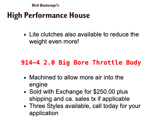

I checked Rich's website and found this under Porsche:
(IMG:http://www.914world.com/bbs2/uploads_offsite/hosting.photobucket.com-21449-1712624115.1.png)
I never could get an answer at the number but left a message. Over a month later Rich called me.
He explained that the guy who bored out the original TB was no longer around but he did have one 48mm one left that he would let go for no less than $500.00. He also explained how the throttle plate was painstakingly hammered to proper size as Chris had.
$500 for 3mm increase in diameter - no thank you. Made me wonder if a machinist friend could not make one from scratch for that amount from my original 45mm one.
Friends are telling me that my present engine performance with dual IDF-40 EMPI clones is so good that I'd be a fool to go to D-Jet as there is no way it could perform as well. Even cold starts are no problem with 20 seconds of throttle-pumping all that is needed on the coldest days.
I'm going to follow DrPhil's lead on this most likely - depending on his budget. I think his budget flexibility is larger than mine.
I like the idea of using my original D-Jet with a 50mm TB & an AFR gauge which I already have. But if there is a way to get even more power with D-Jet and modern EFI benefits, I'd love to have that - if available at a reasonable cost.

mepstein   There are places to send a throttle body out, get ...   Apr 9 2024, 04:35 PM
flxzcat   There are places to send a throttle body out, get...   Nov 6 2024, 04:18 PM
Gatornapper   Thanks Ben - did not know that. The 50mm (from 45...   Apr 9 2024, 07:29 PM
flxzcat   Regarding previous talk of Weber like FI throttle ...   Nov 6 2024, 04:32 PM
