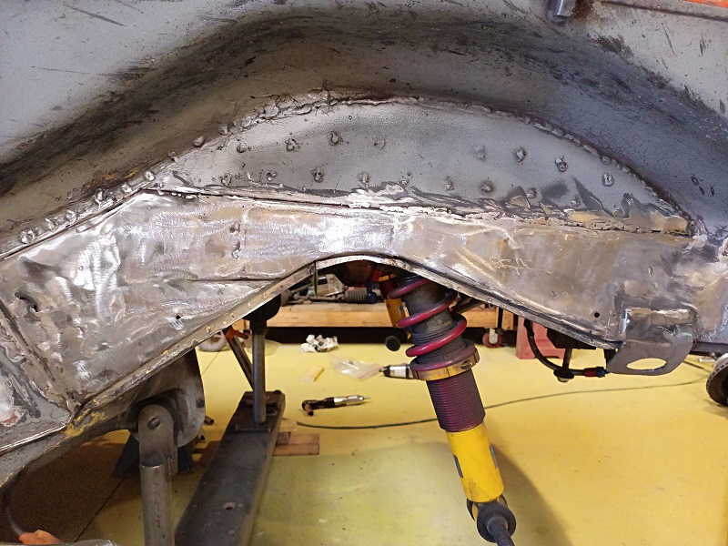

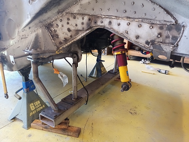

Maybe a few of you will remember when Area51Werks Abducted a factory 6 for some needed attention on one of the coldest days I can ever remember! (IMG:style_emoticons/default/bruce.gif)

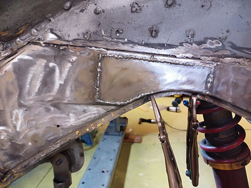

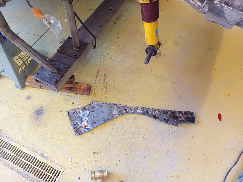

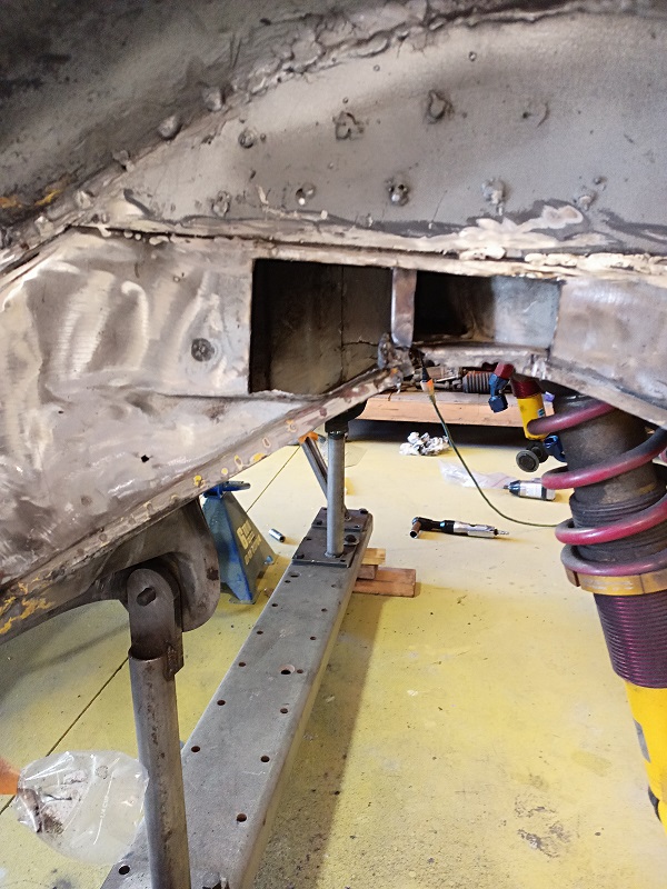

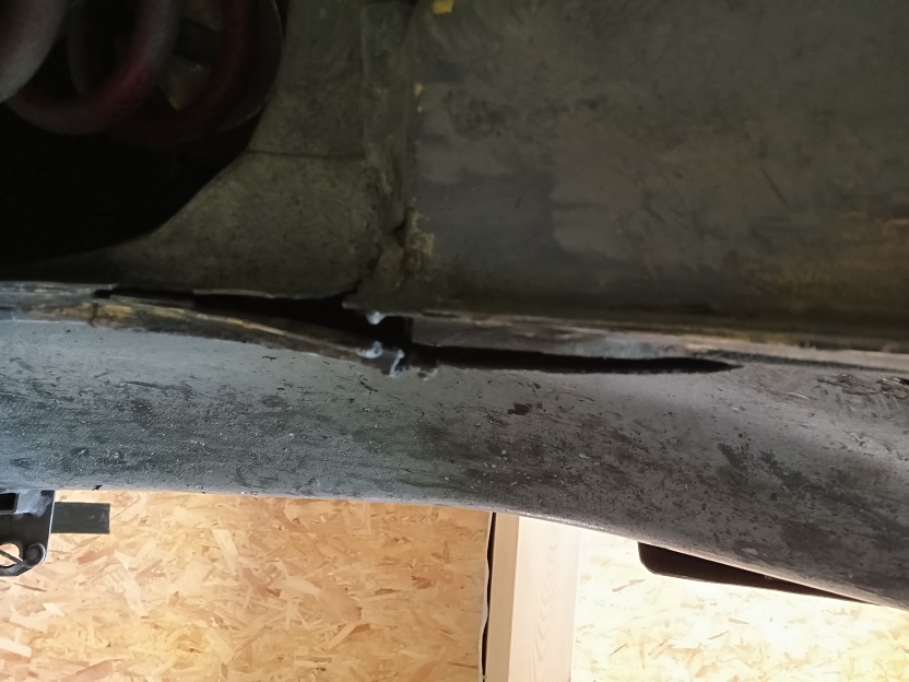

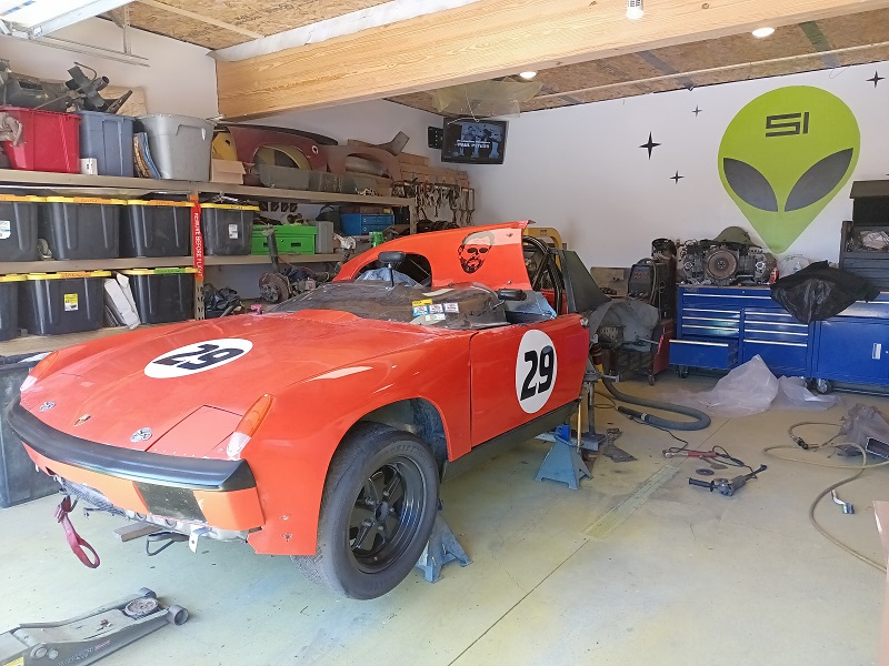

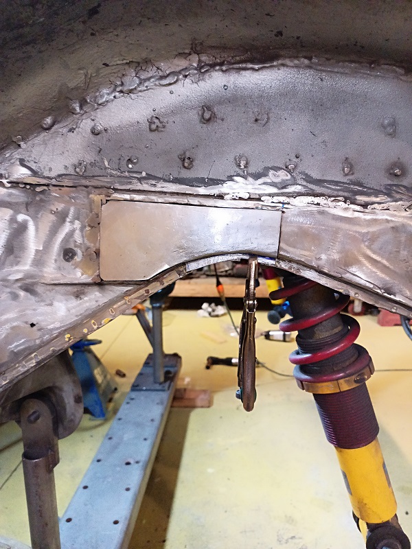

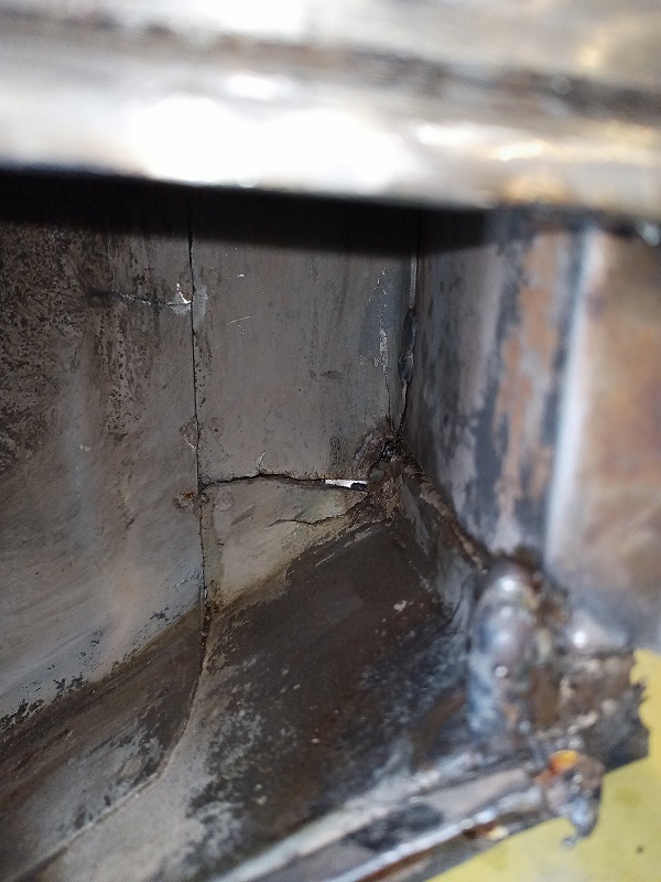

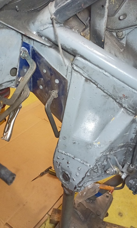

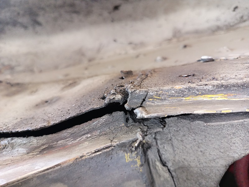

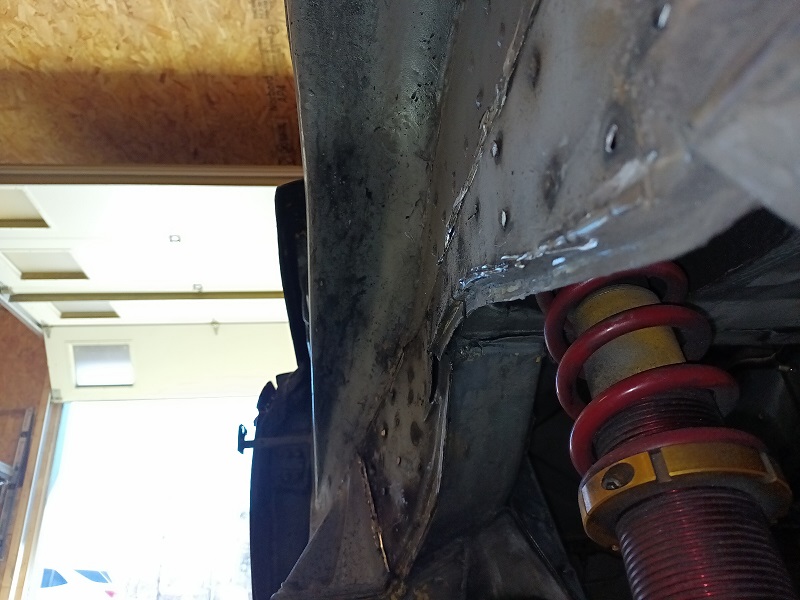

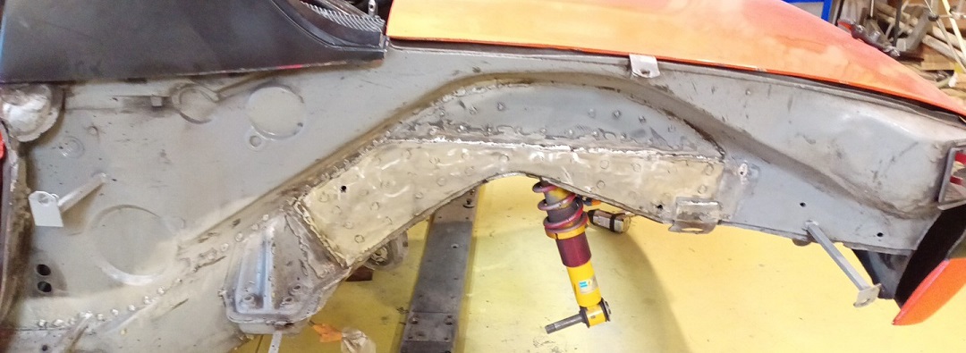

http://www.area51werks.com/sub-zero-abduction.html Well Ben contacted me about his race car. Seems it was a little loose in the corners and it felt like the left side. Here was we found. ![]() I checked the rear suspension pickup points with the fixtures McMark made for me. (Thanks again Mark!!) I used a crossmember from my Celette bench and the pickup points we within spec. ![]() We discovered over time the chassis was stressed and the stiffening plate spot welds had pops along with the factory rail splitting. I removed the stiffener and discovered the chassis had been welded many years ago before the stiffening plates were added. The repair had failed under the stiffener. ![]() ![]() ![]() ![]() ![]() I removed the fatigued section and repaired the factory rail first. ![]() ![]() ![]() ![]() Then cut out a new stiffener and replaced the one that failed. I added some other plates on the inside and under the rail to box it. ![]() Ben brought me a gift when he came to pick up the car. He had this custom made. the company that did it is called Two sisters with Tools. I love this and it's going up in my office. ![]() |
